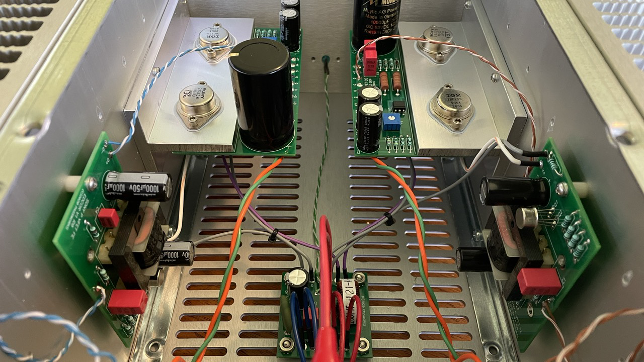

So, for those of us waiting on our kits... the entire input stage is soldered to the filter and to the inputs of the output stage. For those looking into the future to test different input stages, there are no means to make these changes without rethinking a bit connectors?

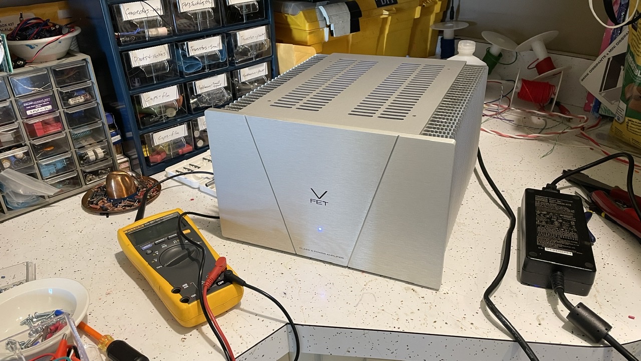

Breathing a sigh of relief. Everything fired up great. Just as adason said, I was getting around 15v with pots at half way mark. Adjusted up to 19v and will see what kind of change an hour of warmup brings.
Will listen to it soon, but I have nothing but great things to say about this kit. Well considered and looks incredible 🙂

Rafa, that’s a good question. I was considering using 2-position terminal blocks for each of the input, output and power entries. The holes on the input boards were just a little too wide to fit the terminal blocks I had. It’s possible you could bend to make fit or find a wider terminal block(?).

Its actually other way around. It draws more current when you set lower voltage on the source. Set 20, its very stable.
I just noticed that nothing seemed to move after warmup. Set it to 20v, and gonna see if she plays music

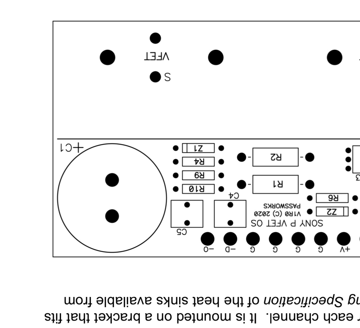

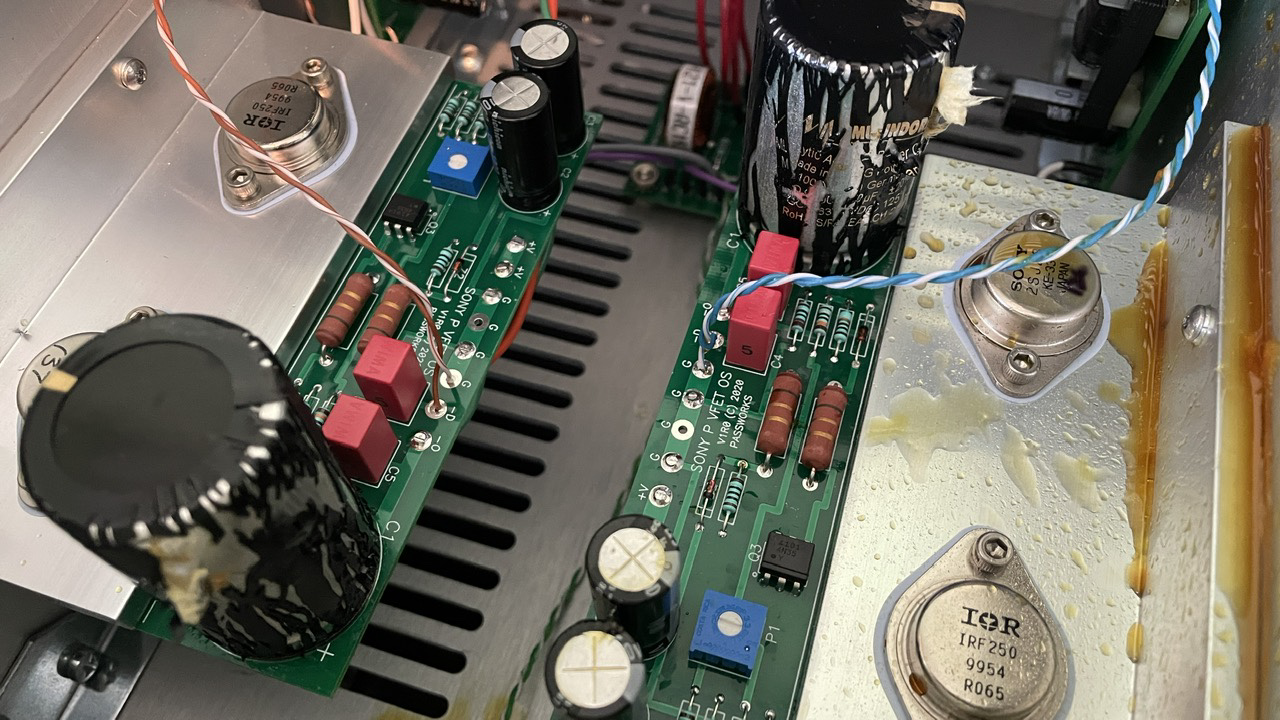

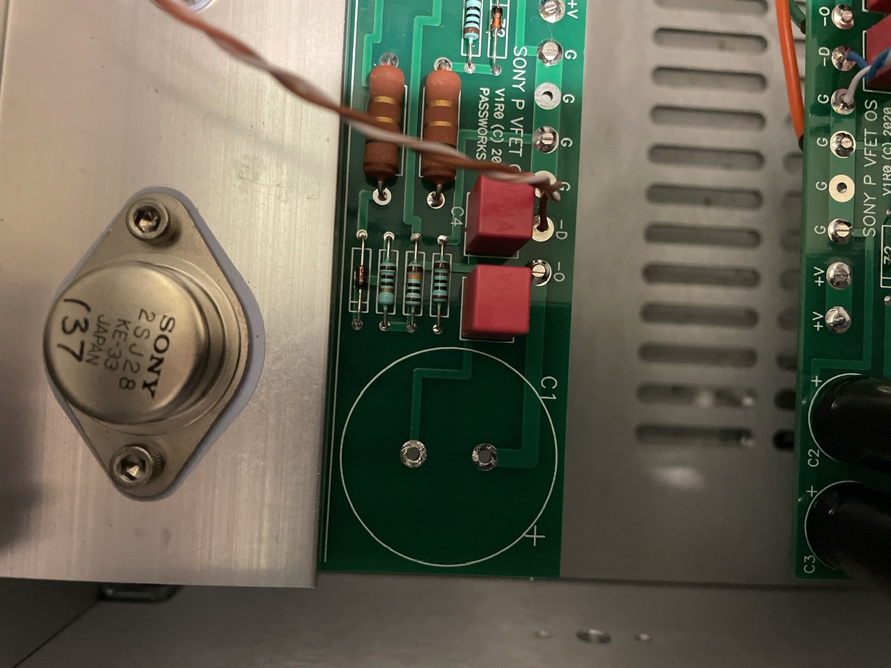

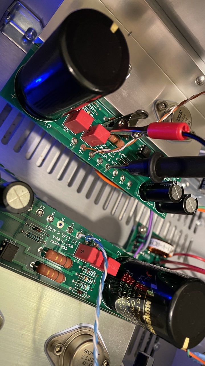

Please check the silkscreen / polarity orientation of your C1 capacitors in OS. Mine has discrepancy from the one in the documentation and Jim’s (6L6) build. I know this first hand...

Oh No!!!! Those beautiful Mundorfs! 🙁

Oups, that is unfortunate. Hope you have some spare in your toolbox to quickly fix that.... all looking forward to the first impressions! Although we all know it will be very good!!

Feel sorry such high quality Mundorf caps are exploded and all "juice" around

Has anybody else been able to confirm the polarity of their OS boards? Hopefully it’s an isolated instance. I’m guessing Adason’s silkscreen was accurate, as I say his caps were orientated opposite mine.
Is the PCB silkscreen wrong?
What a mess.....how do you clean that up?
Hopefully the VFETs survived.

Thanks for pointing this out. One of my output caps was backwards. The silkscreen appears different between the two channels.Please check the silkscreen / polarity orientation of your C1 capacitors in OS. Mine has discrepancy from the one in the documentation and Jim’s (6L6) build. I know this first hand...
