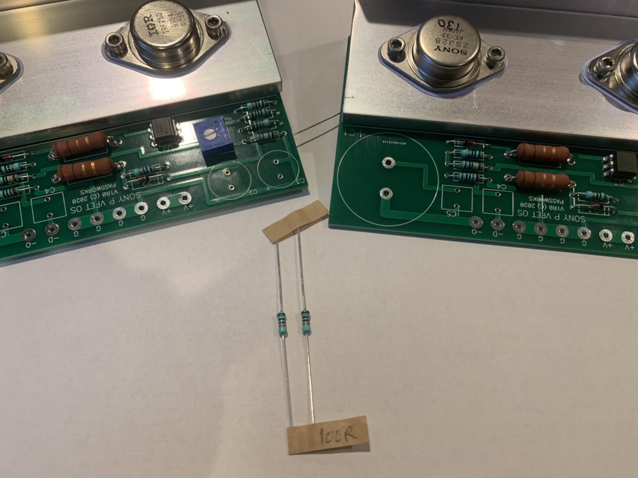

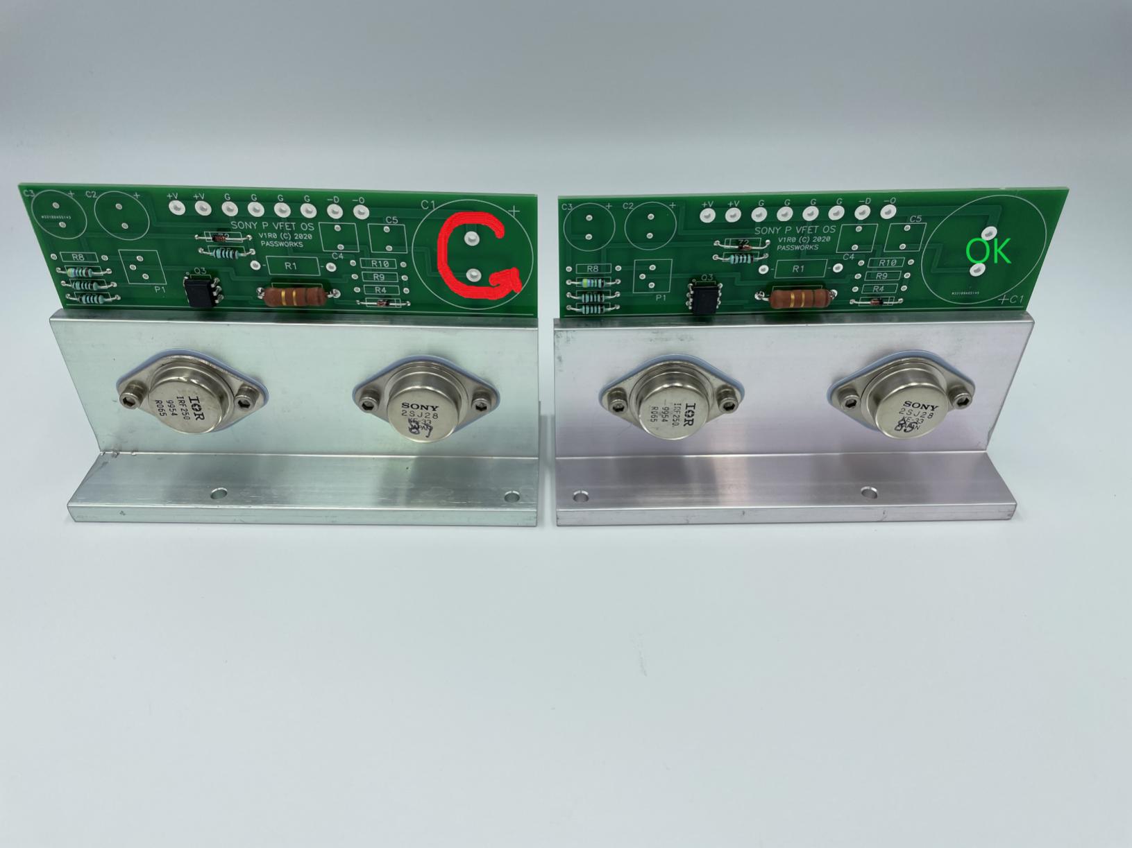

For a pictorial... Since I happen to have one of each.
Thanks again Codyt, Nelson and all others for pointing this out.
This picture is perfect, btw! Definitely suggest everyone checks their boards against this pic.
Oh man, bet that got the heart pumping.
I just checked mine, I have the correct markings on mine. And drat, I missed the postman with my package today.

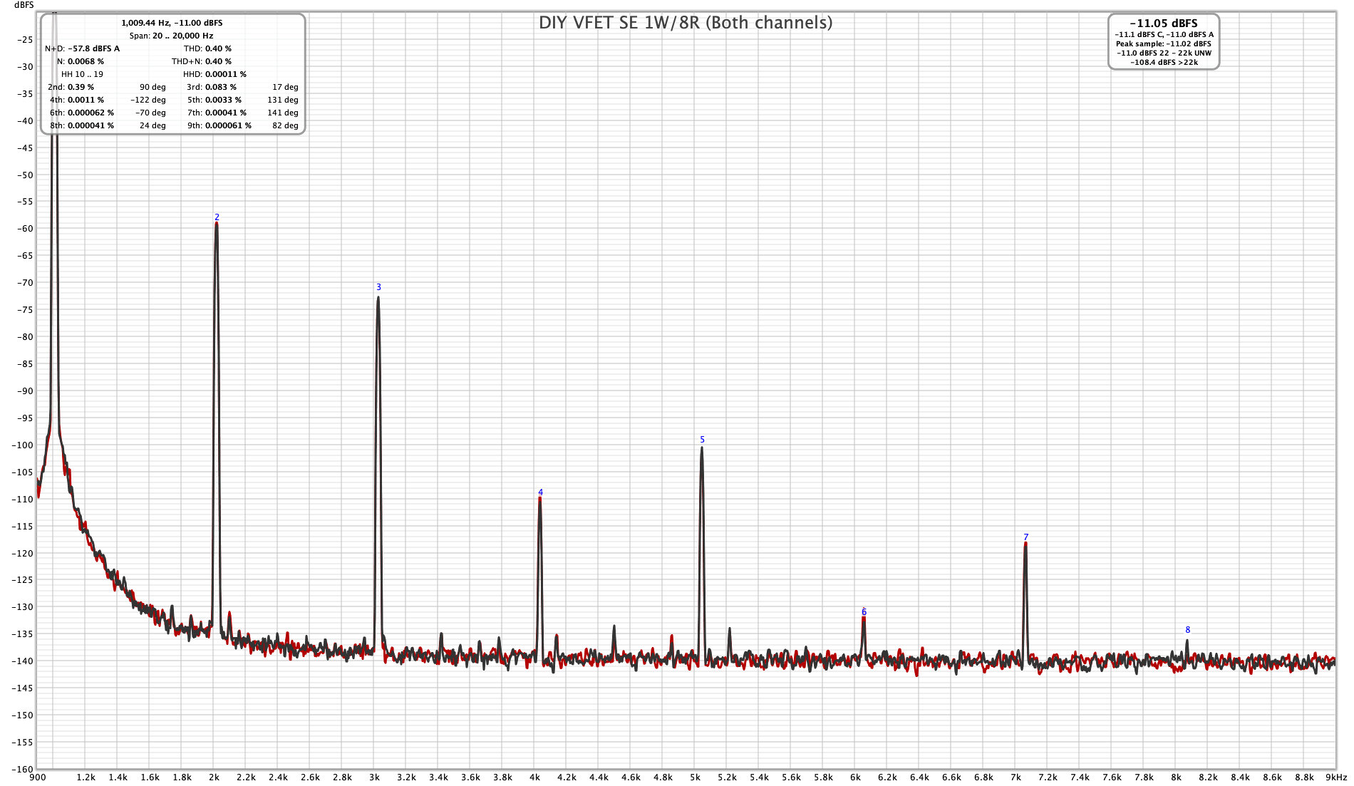

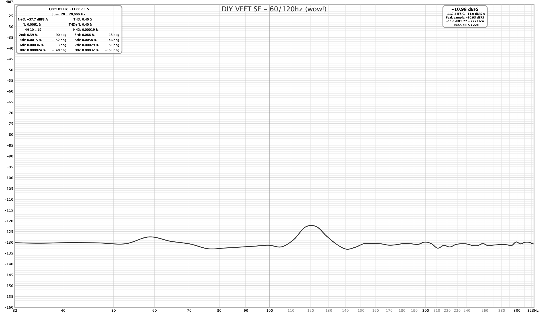

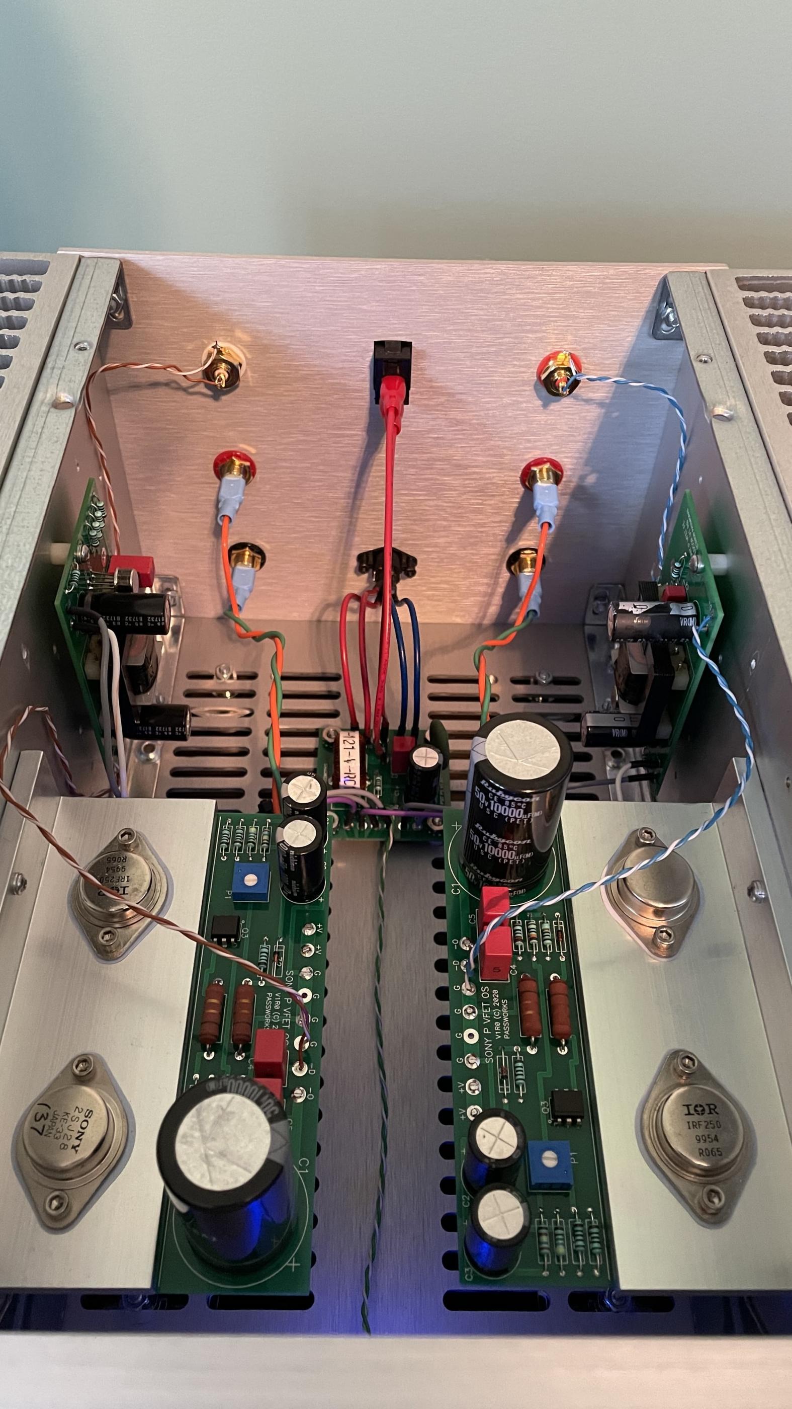

So, I got everything cleaned up, caps back in (reversed), amp successfully powered on, and voltages are holding well. Heatsinks have settled in at around 48C. I've not had a chance to give it a good listen yet, but what I can say so far is... SPOOKY. I'm impressed to say the least 🙂
I've attached a few measurements. Distortion seems inline with Nelson's data from the documentation. This amp is quiet! Also notice the nicely matched parts 🙂
Thanks again for the support and help along the way!

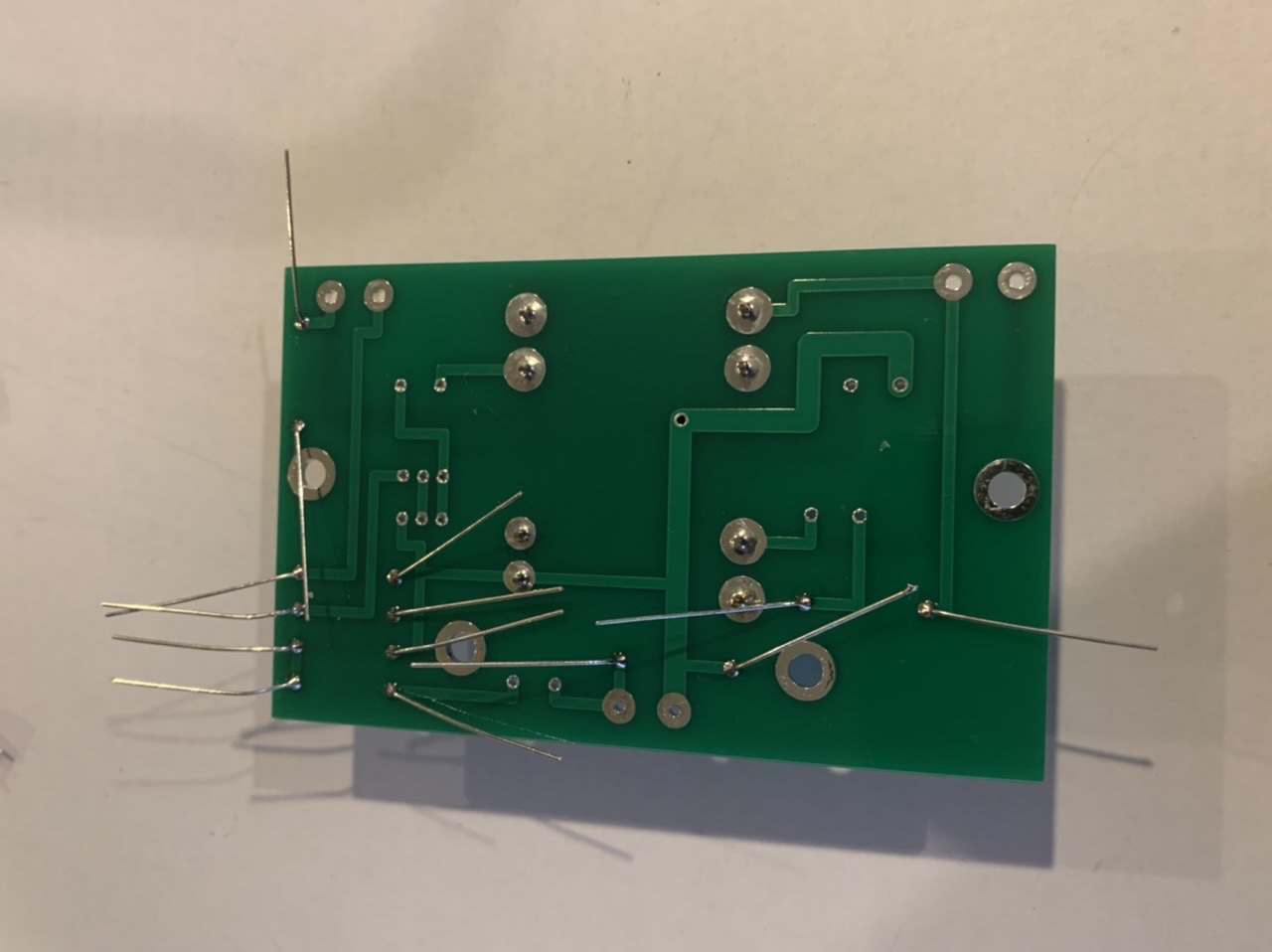

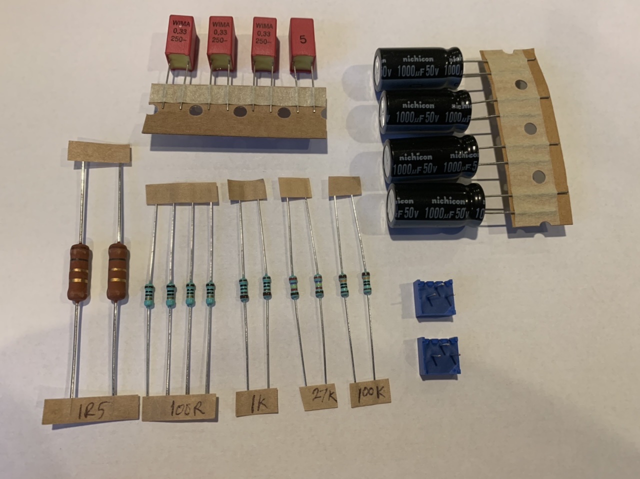

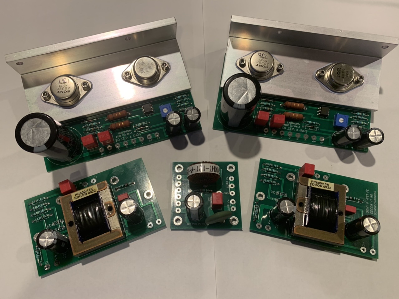

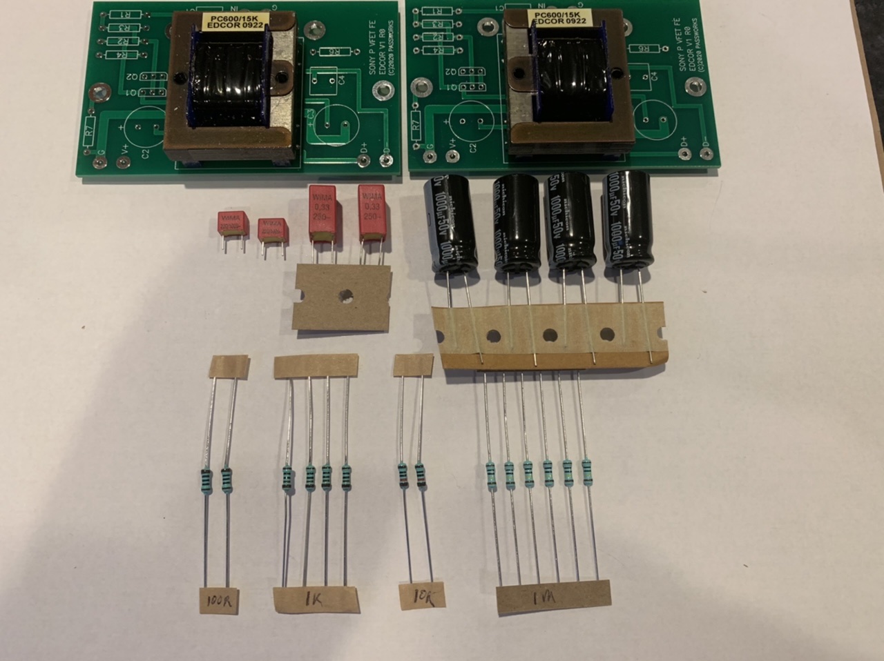

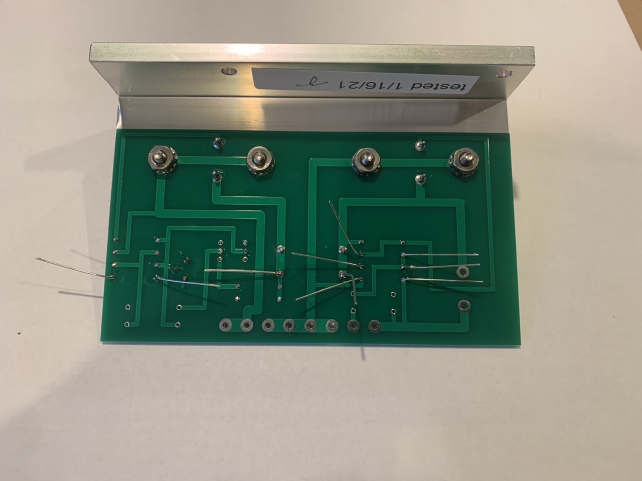

Here are some pix of my board assembly. I measure and mark the resistors, then install and check them off. Then the caps, etc. I had a few extra resistors. Is that like the IKEA kit with a few extra fasteners? I hope to do some wiring after dinner.
Great tip to label the bags before dumping them out! Now I know what screws and washers go where.

Codyt, thanks so much for the heads up, for alerting the community and for the good attitude about it! It must have been a bummer and an upsetting moment. Cleaning it, erasing the VFETs markings, having to replace your nice caps. You are a true champ! You may also have just saved the others that get those PCBs.
Perhaps if you had had a mismatched pair, it would have raised a flag to double check, but you actually got BOTH PCBs wrong, so I would have failed miserably myself at that check for sure! 🙁
