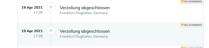

Just thought I would let members that are missing nuts and bolts from chassis that mine where shipped from Italy yesterday.

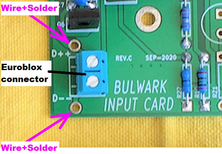

... the quick disconnects terminal blocks to fit in the front end boards. Note, the terminal blocks are not in the kit. They’re from my stash.
The other four front end boards have PCB component footprints for both soldered wire connection and Euroblox screw cage connectors, so builders can use whichever of the two possibilities they prefer. Euroblox part numbers are listed in the Detailed Parts Lists and they are part of the one click Mouser Shopping Cart. They fit beautifully without needing to bend the pins 😛
You can see them in this photo; the Euroblox are sky blue plastic rectangles, located at approximately 11 o'clock , 3 o'clock , and 7 o'clock on each circuit board. Click on the photo to see it full size and undistorted:

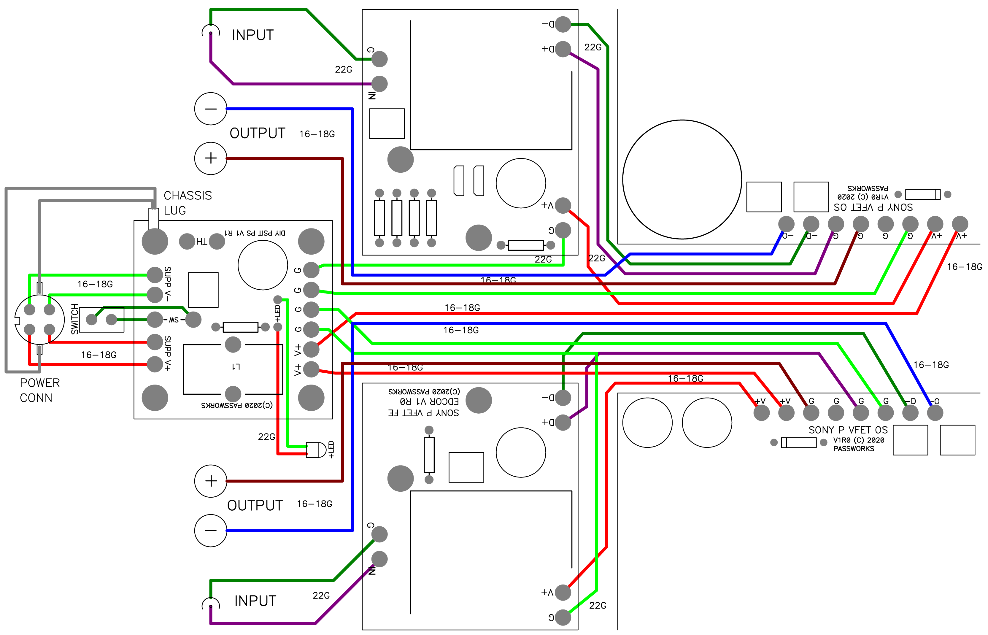

Time to see how far I can get with mounting and wiring the PCBs today. I've scavanged some screws from my Ultimate 4U, 500mm deep chassis and will replace them with VFET chassis screws once those arrive.
The color wiring diagram in Nelson's Sony VFET pt1 manual is the key:

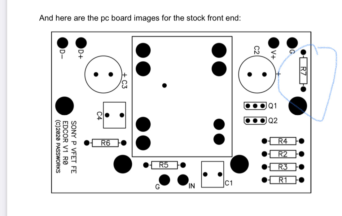

Rhthatcher, I also had two extra 100R resistors.
Those "extra" 100 ohm resistors are R7, which goes from chassis ground to FE ground.
For those who are not colorblind. 😉
There is no footprint for R7 on the FE board.
Here’s the photo I’m referencing, from the documentation
