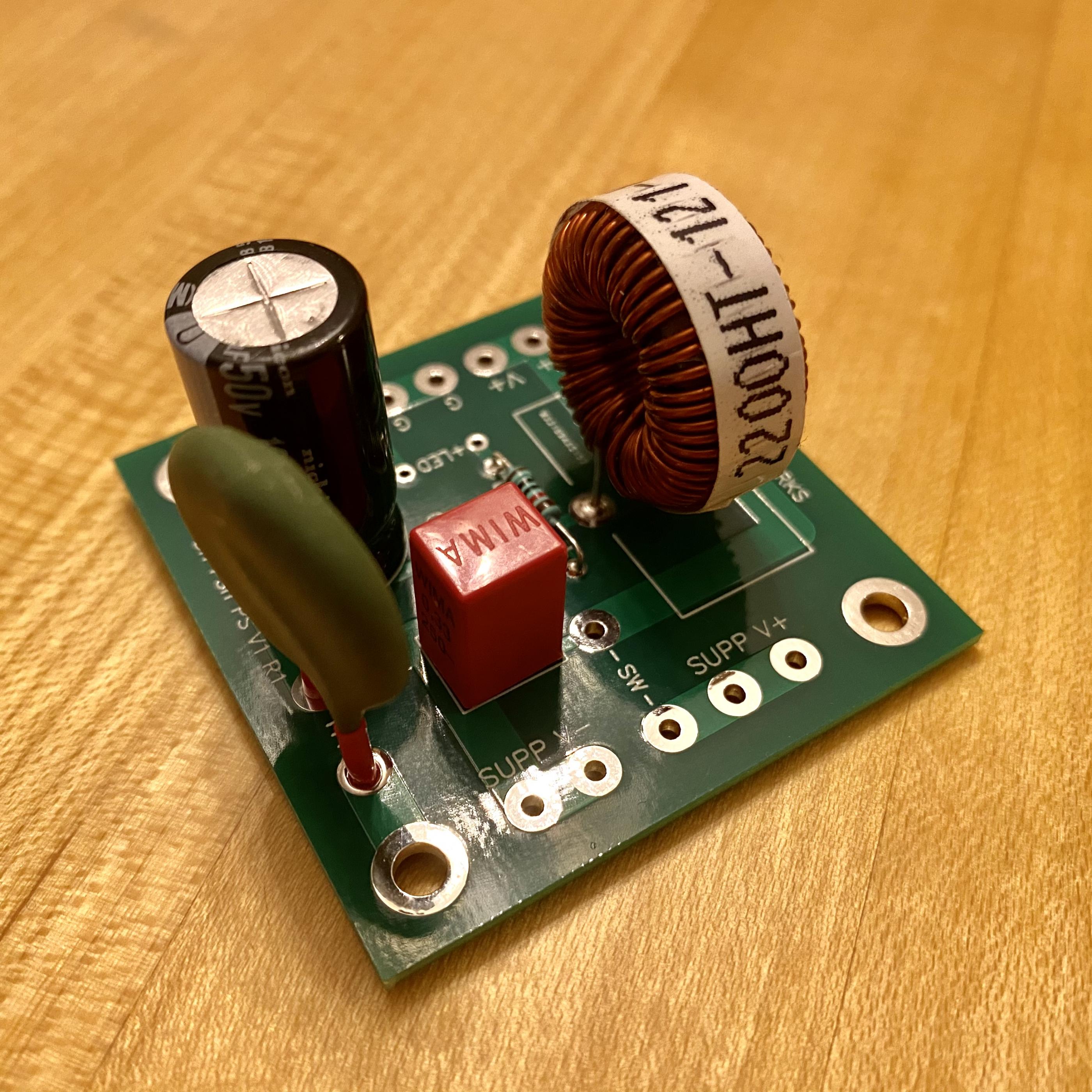

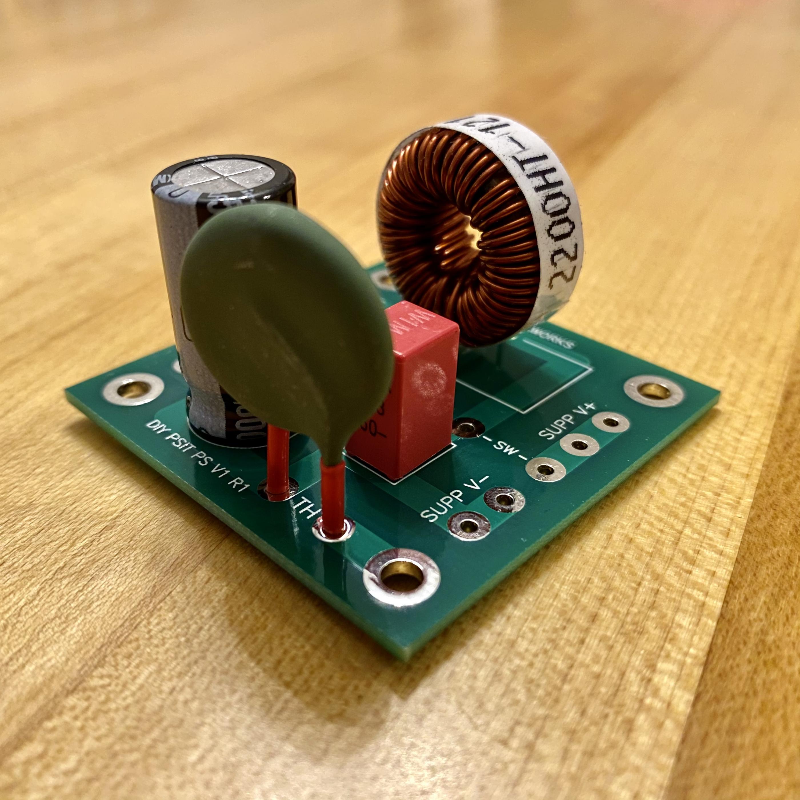

My boards are now complete and waiting for the chassis to arrive. Hopefully tomorrow.
I did run into a minor hiccup. My parts kit included two extra 100Ω resistors for the output stage, and only a single 100kΩ resistor. Fortunately, I was able to locate a spare 100k resistor in my spare parts stash to complete the build. If others run into similar issues, then we may wish to bring this to the attention of the diyAudio store. If it was just me, then no worries.
