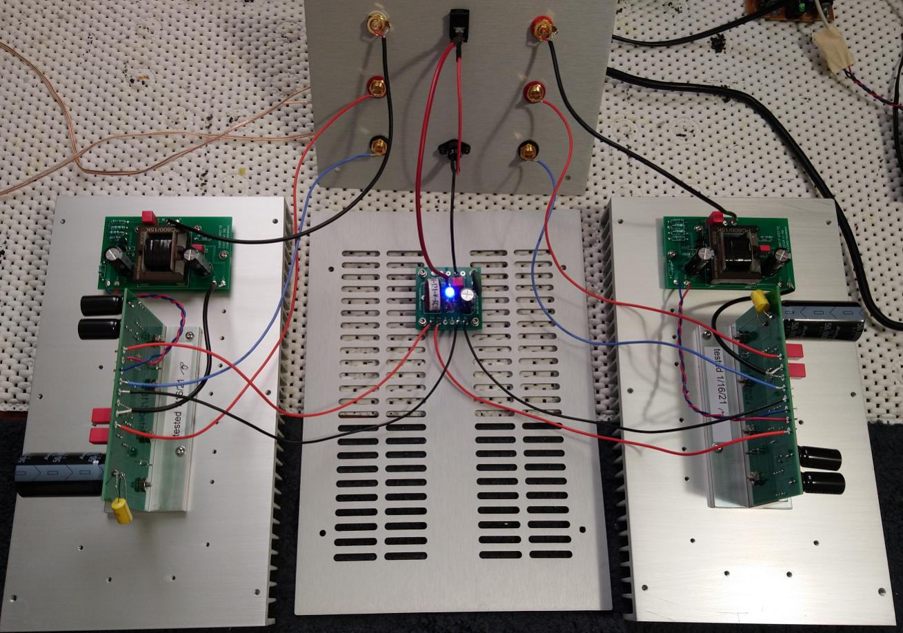

Slowly starting to look like an amp...
Any progress update ? How much is heatsinks temperature after 1 hour ?
Hot or very hot ?
BTW thermal paste included in the kit that is "take great care of the details" 😀
Do you mean I wasn’t supposed to peel them off?
Just a little miscellaneous wiring today. Screws should arrive tmrw. Taking the day off work so I can focus 🙂

I´m interested too, but, well, approx 60 Watt for 30cm x 17cm heatsink should be ok..

Yes heatsinks with all chassis looks comfortably oversized 🙂

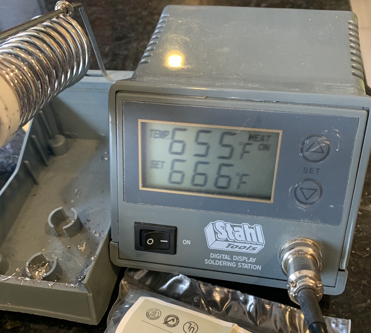

Soldering tips from a Pace HiRel course taken long ago. Clean pads and leads with lint free wipes and 99% Isopropyl,never use erasers etc. Flux all joints "flux is your friend".Solder tip about 650F,use SN63/37 eutectic solder (this was long ago but lead free is a pain in the As#).Clean residue with Isopropyl (acid brush works good).
just fired up mine, it works
irf250 is rather hot, but all voltages are as supposed to
i guess i am not accustomed to run things this hot

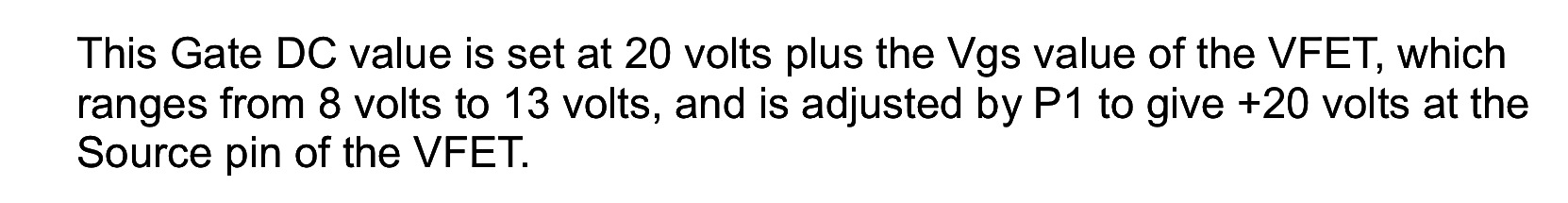

Awesome! Did you measure voltage at R2 and ground to verify the 20v?
Perfect, that’s good to know. I centered mine before installing, as I was unclear if they were shipped with correct adjustment.

Edit: extract about adjustement from Mr. Pass article

My iron is typically set to 666 deg F, because my amps will play a lot of metal when done!
