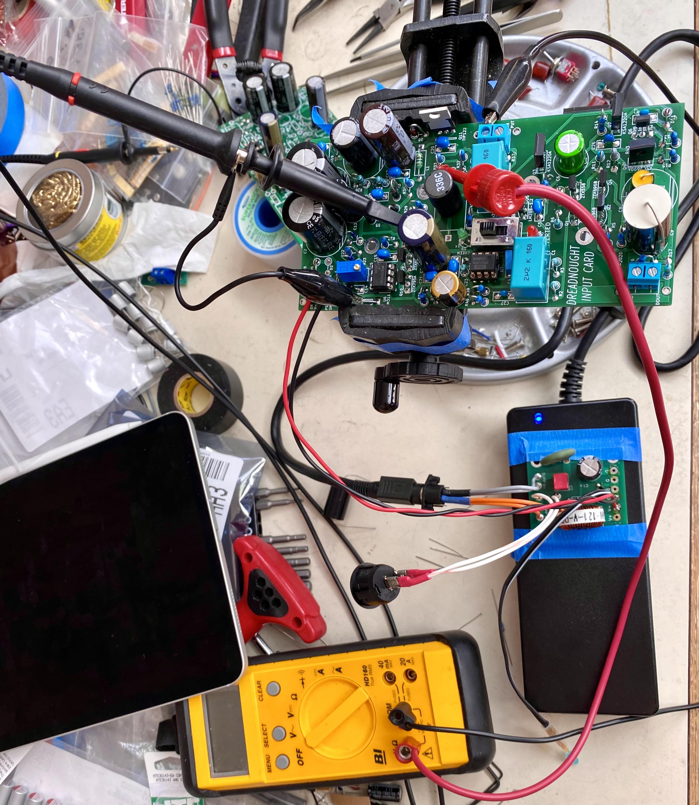

Dreadnought Board #1
It is quite a busy board, as you all can see. Lots of parts that need to be installed in the correct positions. I really appreciated the Customer Part# attached to the line items in the Mouser BOM. It definitely helped with the installation. I took my time with the assembly over a couple days.
The board powered up with no issues. Setting the switching frequency was very straightforward. Final POS_BOOSTED voltage is just under 58V. Having the SMPS and its little filter board separate from the amp chassis was convenient.

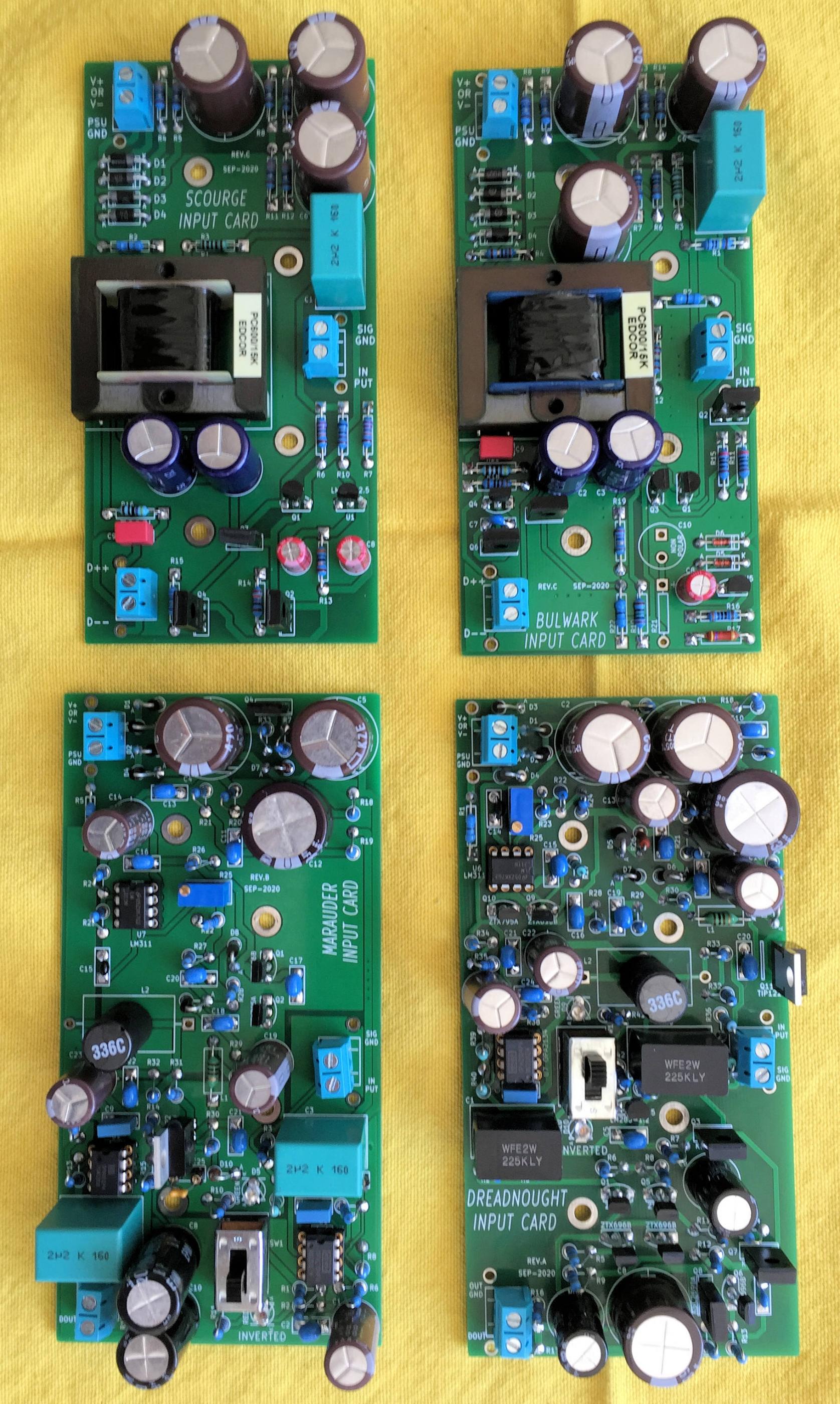

I don't think I've seen anything as formal as a mission statement for the new VFET front end boards, but they all offer some alternatives to the one that comes with the standard kit.
Bulwark and Scourge drive their Edcor transformers with different types of discrete amplifier/buffer circuits. Bulwark has the option to add some extra gain above what is provided by the transformer. Scourge is a straight buffer, very reminiscent of the Mountain View front end for the M2x. Both of these front ends have a passive RC filter network on the incoming 36V power. On their own, these filter networks have the potential to improve stereo separation and imaging. By omitting the initial 27R (or 33R) resistor, 470 uF will be present to filter the 36V power for the whole amp. Something that I found worthwhile, even more so if it is increased to 1000 uF.
The Dreadnought and Marauder front ends eliminate the Edcor transformer and use on-board power boosters to allow sufficient output voltage swing. The booted power can be thought of as dual-mono PSU for the front ends. Probably the place where it will have the most impact. The amplifier circuits themselves are quite different from the others. Dreadnought is a very high output impedance transconductance amplifier, which should have a different sound. Marauder uses a bunch of high voltage opamps, for those who like to play with such things. Kind of the opposite of Dreadnought, as it will have a very low output impedance. Both of these amplifiers have adjustable gain, so one can taylor the overall gain of the VFET amp to suit the system.
That is just my take. I'm sure others will find their own reasons for trying the different front ends. I don't know enough about FE#5 or FE#6 to speculate on those. I am working on some vacuum tube front ends, just because tubes are fun.
I will be building the Dreadnought once the parts arrive. I thought it would be a really nice contrast to the stock FE. I do like the stock amplifier very much. Dreadnought implements some "tricks" to maximize performance that I'm currently reading about in Bob Cordell's book. I like the boosted rail, the improved filtering, the IPS degeneration and current mirror load, polarity invert option, etc. And I plan to do the signal coupling with film caps both in and out. It should be interesting.

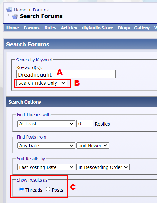

Just about everything that is written about Dreadnought, can be found using the simple trick disclosed in Figure 1 below.
A quick peek at the schematics reveals that Marauder contains two opamp chips. One is a standard voltage (max 36V supply) OPA2134 dual, and the other is a higher voltage (max 60V supply) OPA552 single. Carefully note that TI has decompensated the '552 and it is not unity gain stable -- intentionally.
Both Marauder and Dreadnought include a slide switch on the PCB, with a pair of LEDs that indicate which position is currently selected. Neither Bulwark nor Scourge has a slide switch. In the Figure 2 photo below, you can see that this Marauder board uses a teal colored KEMET 2.2 microfarad polypropylene film capacitor at its input. This Dreadnought board uses a black colored Panasonic 2.2 microfarad polypropylene film capacitor at its input. Both of their Mouser P/Ns are tabulated in the Detailed Parts List.

The second Dreadnought board powered up the same as my first one. Boringly predictable, predictably boring. That’s a good thing for engineers. 😉
So, just to add something interesting, I hooked the input power up to one of my 28V SMPS units. Without any adjustments, the onboard Boosted-power achieved 42.7 Volts. Possibly still good for about 40V peak-to-peak signal out?
Apply an input sinewave (I recommend 30 kHz) and dial up the amplitude until juuuuuust barely visible clipping on the output. Overlay delta-Y scope cursors, job done.
But your VFET amp channel cards have their bias potentiometer lovingly adjusted and fine-tuned for 36V DC input. Dropping the supply down to 28V means you'll get less output power, AND you'll operate the magic flux capacitor (VFET follower) at a bias point away from the optimum "sweet spot" as determined by Gandalf Wizardo Merlin, who supplied your magic flux capacitor in the first place.
