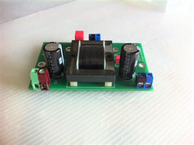

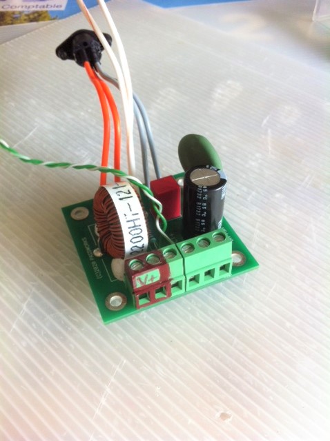

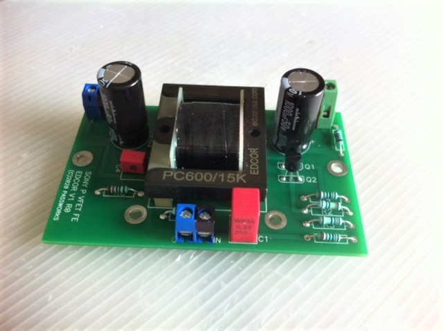

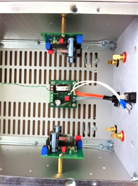

Some progress today...
I decided to build the VFET in a modular way, so that I can add SMPS filters after the existing std one, swap easily and quickly FE boards, possibly switch between direct VFET OS and FE + OS stages, dismantle and mount things quickly without to have to mess with lot of work, play with additional PS caps etc.
At the end I decided to use tall stand-offs (better for cables, less heat, allows additional bypass caps underneath) and screw connectors. I don't like the latter, especialy in the signal path, but I have to grow and accept they are indeed doing a good job. The connectors aren't cute, but they are practical. As this amp is for my wife, I asked her what she thought about the ugly connector bricks etc. - She said the VFET amp casing was cute looking, and as for its inside, she said "seriously, do you expect anyone else but you too ever look inside not even mentioning opening it, LOL" - she got a point. I have to live with it, at least while I experiment.
They are green connectors for everything related to power supply, and blue connectors for signal only. On top, I marked red all poles that are "+", to avoid any confusion with the others (mainly grounds). It looks big and ugly on pix, but once you have just the top lid open and all build up inside, space and light are not great so you better make things very obvious to hopefully avoid any mistake.
Last but not least, the astute reader will have noticed that on the filter two 2 pole connectors would have done the job to allow an easy additional SMPS filter connection, but while at it I found to have an entire row of connector more practical - but it isn't necessary: 2 V+ and 2 Grounds awould have been enough.
As things are, I can do many things just opening the top pannel and nearly everything taking off both top and bottom pannel, which is done easily. It is quite different obviously from the recommended assembling and all that hassle is only worth considering if you want to test various things - otherwise just follow the regular excellent build, job done once for all.
I need to finish the cabling and think about the 2 additional 4PDT switches... whenever I find the time.
I am now considering altering slightly the OS connections, in hope to reorganise the Grounds differently. TBH, they are of course all connected together so I doubt it makes a real difference, but I like to think about a sequence where the ground next to V+ is PS related, then G spare, then LS G (bigger signal), then small signal / FE G...
To be followed...

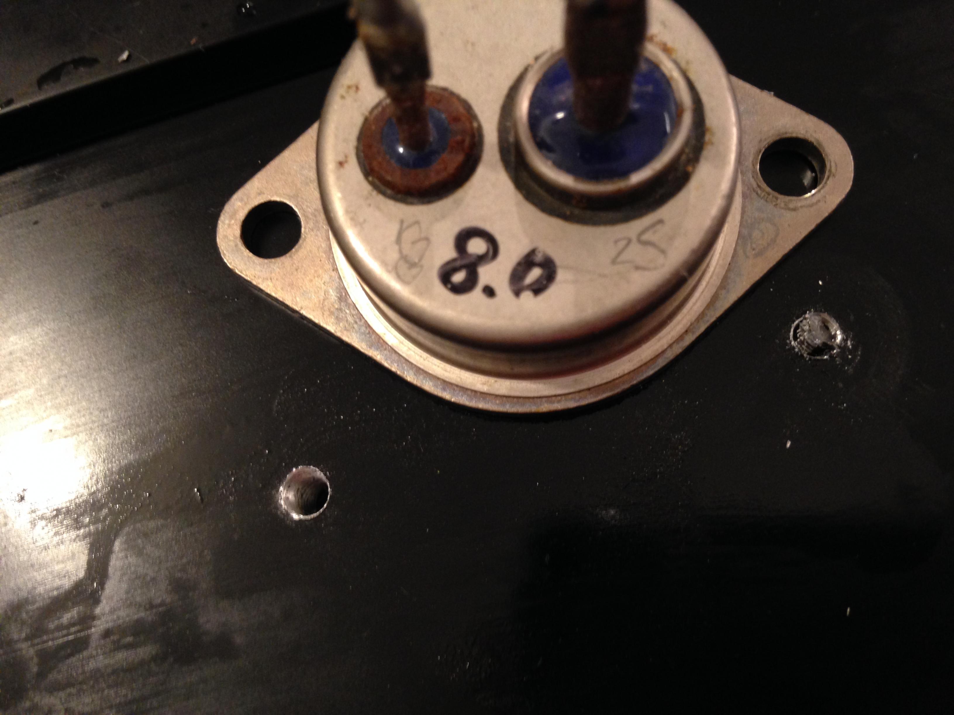

The breeze came along
And broke my tap.
Went to cry to my wife. She said, can't you heat it to get it loose? The smart lady. Yes I said, great idea, torch it, the alu expands, the iron not, then wring it loose :wiz:.
What should I do? Yust start over? I tried to keep it all nicely lined out. .
yes, heat it some
even heat-gun can help, sometimes Torch temperature is not needed
Only a torch would work, the heatsink is .33/watt (Reichelt SK108)
I once had an Alfa 1300 and a headscrew broke off. A friend worked in a Maserati shop. He welded on a bolt, the alu expanded, the bolt could be taken out . . . I know it works.
You know, smart wifes . .
Long long ago in a studio, the recording engineers wanted to dub a session track, ran into a problem; I had no idea, my girl-friend said, why not insert a piece of paper, the bias will be less active. By far outsmarted me.
Which kinds of taps do you use?
If "hand taps" they come in a set of three and the first one takes very little, next one a little more and the last one makes the final thread. I use those and have never broken a tap 🙂 ....I also do a little forward the backwards.....and so on....then the thread can be made using less torque. The taps I have are either HSS-G or HSS-E steel quality. HSS is not just "HSS".
I have the set of three - now two. 🙄 And I have a set of 'all-in-one stroke' but the depth is less. The problem was my negligence.
