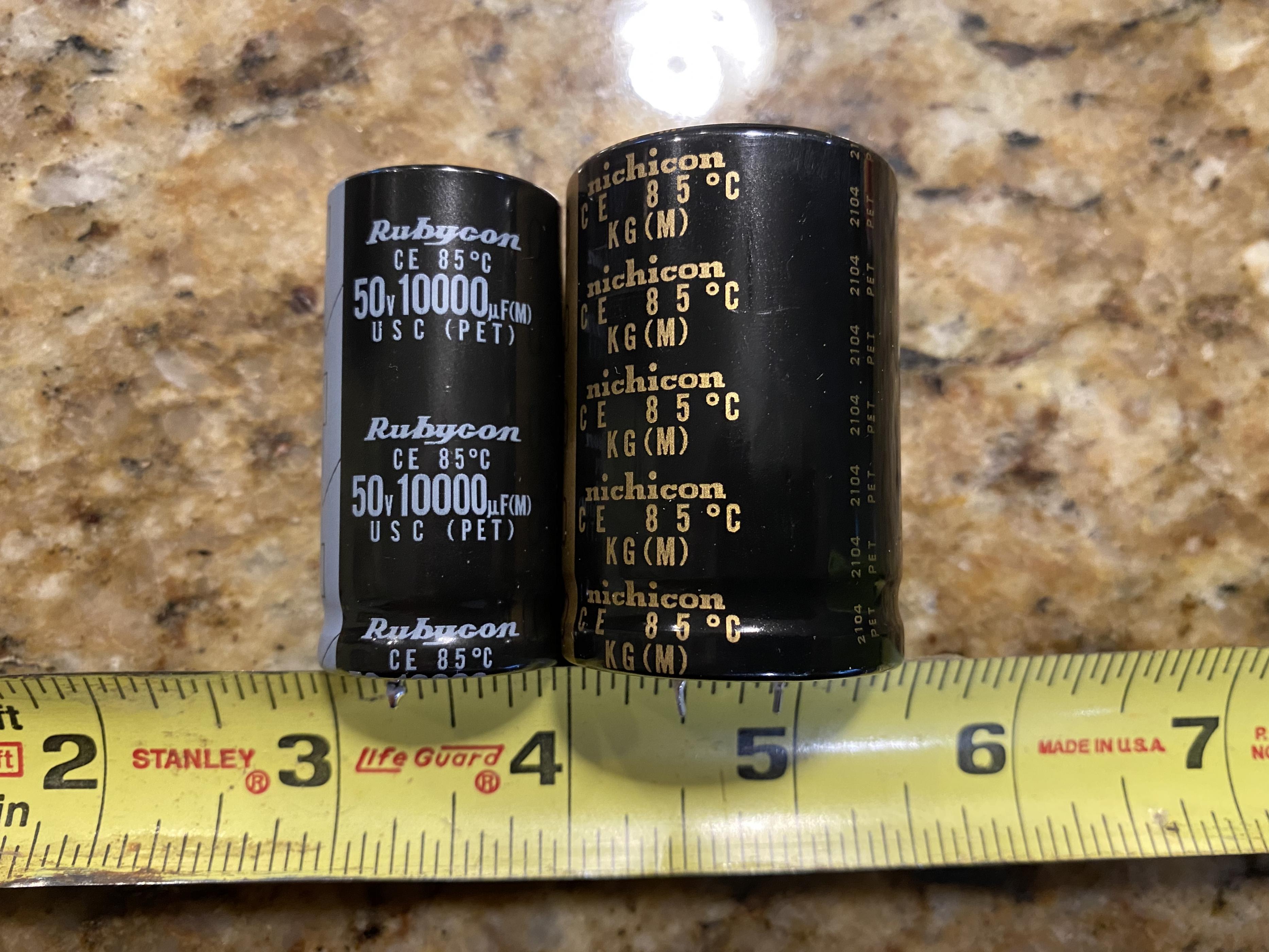

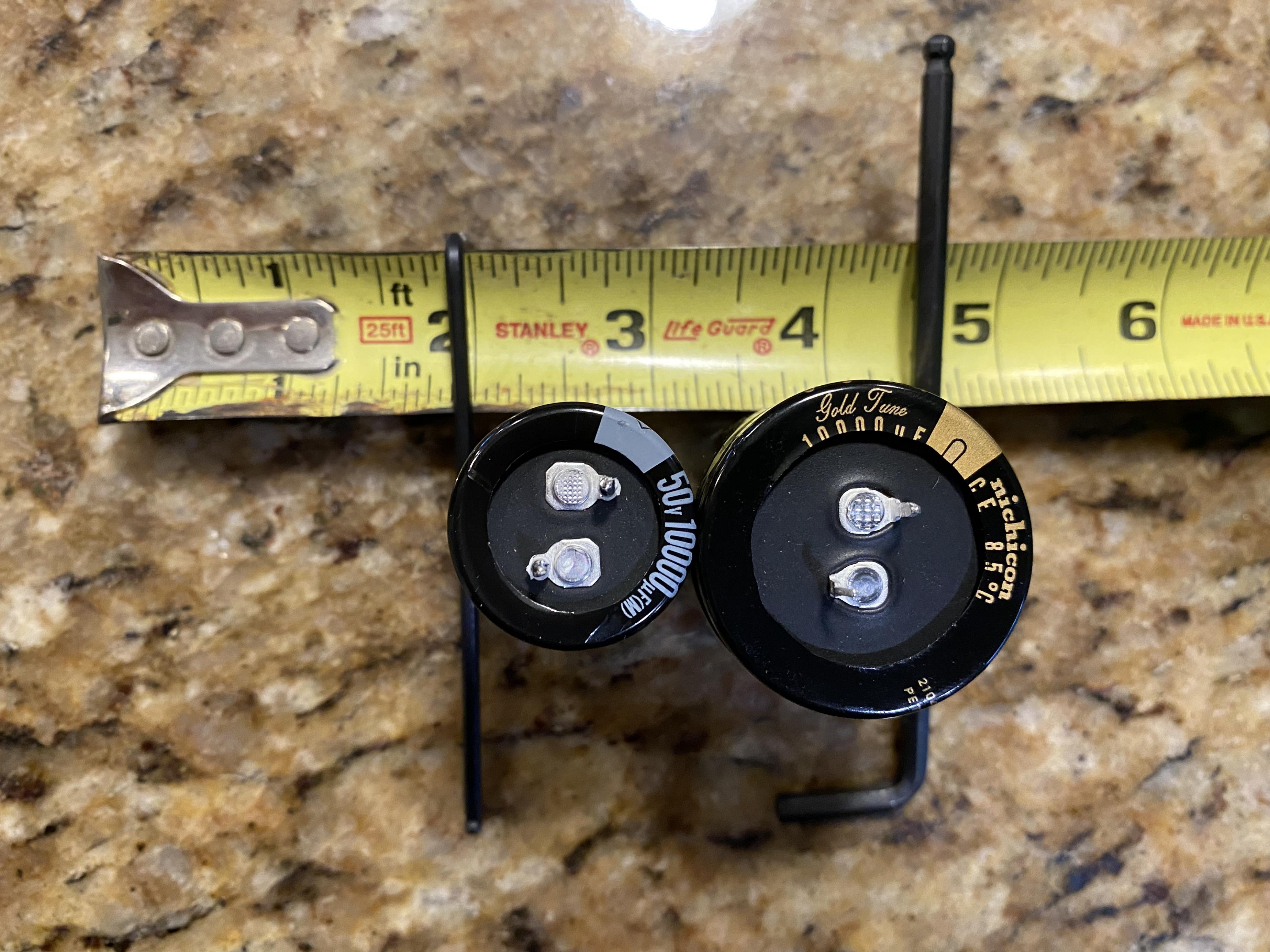

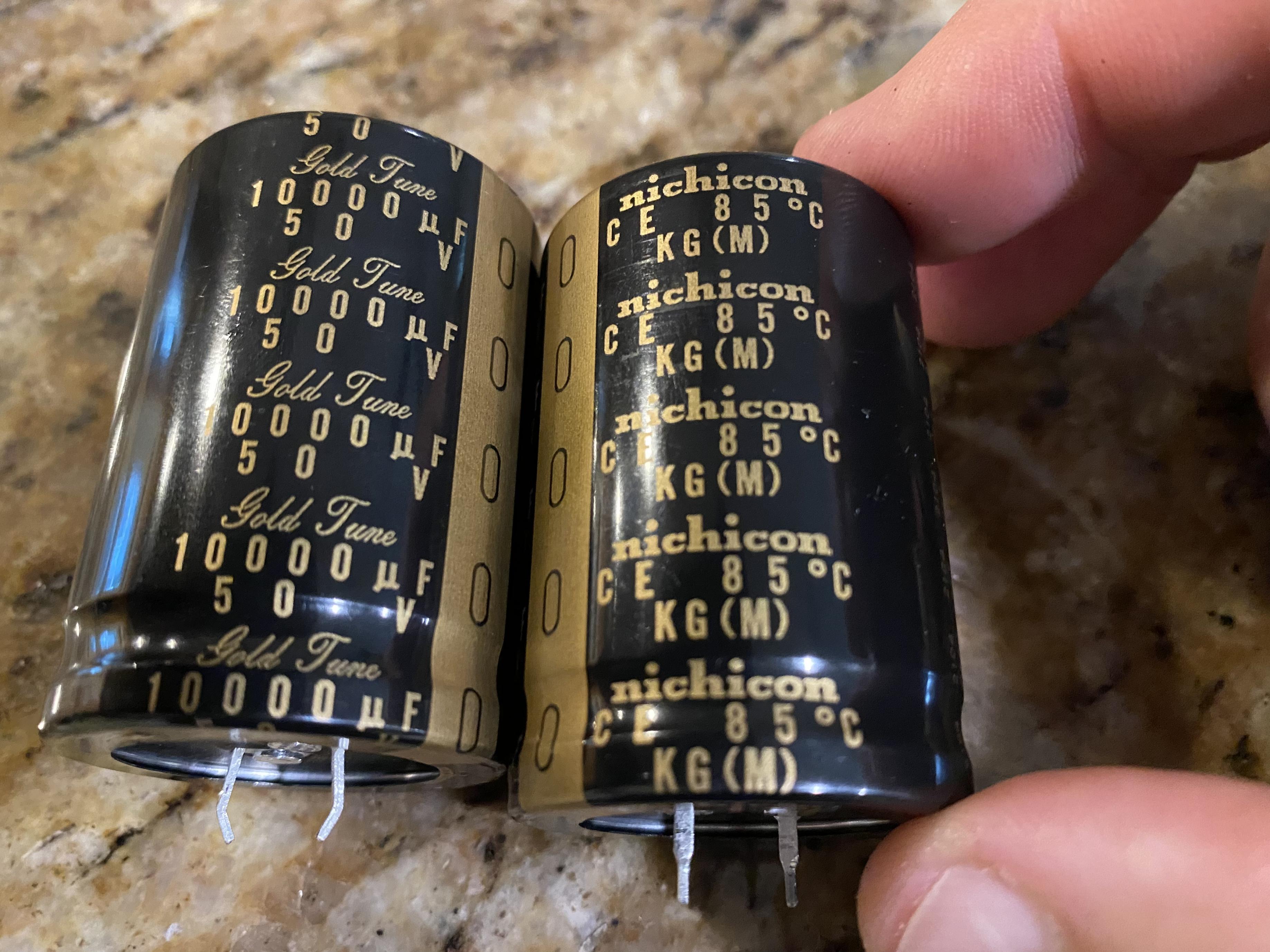

Ahh, too bad about blowing the big cap. The Rubycon caps that came with the kit are decent ones. If you are looking for an alternate, these would be a good way to go:
https://www.mouser.com/ProductDetail/Nichicon/LKG1H103MESCBK?qs=4lWw5qRttGJcrVu0WisRew==
Ordered them 😀 there two shipping is discounted right now!!!

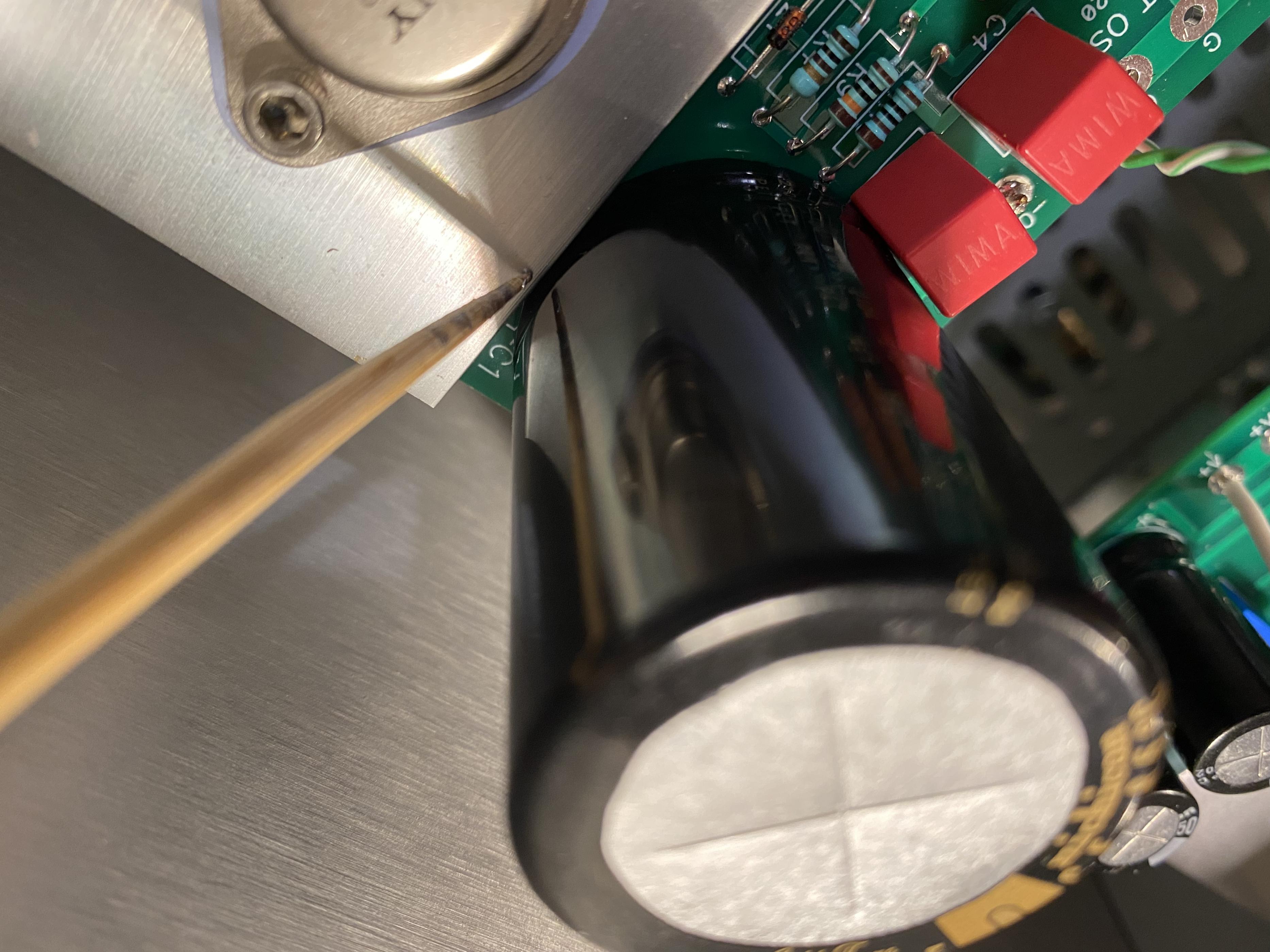

Ok my upgrade parts showed up yesterday. Well they are a very tight fit, or not. Can anyone think of a reason that bumping up against C5 is bad thing or is just slop.

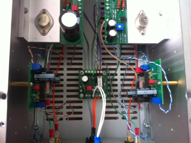

First of all MANY MANY THANKS to Papa and to the entire DIYA TEAM for such a nice gift and marvelous kit.
I tried to build the amp by the book, but me being me, I did a few (very minor) mods. All but one for future experiments, one in hope to affect the sound. I know I said I wouldn't so that I could post and report on the gains or not for each mod, but regarding this simple PPP bypass cap I was simply to eager to listen to the unit than to fiddle around... Sorry, will report on the others, promised!
The very minor mods I did so far are:
- Blue connectors for signal wires to enable quick FE swaps... and at a later stage direct drive without any FE amp board
- Green connectors for PS wires to enable quick FE swaps and a quick fit of an additional SMPS Filter, should the latter materialize
- Metal stand-offs to enable quick removal or relocalization of the Filter and FE boards
- Metal lugs to enable quick addition and removal of PS caps and easy Ground connection for the 20V initial tune
- Lifted resistor on OS board to enable easy conection for the 20V initial tune
- Additional 1uF PPP cap, Panasonic ECW series for 50cents, as bypass to C2 (1000uF) for each FE boards - sorry, didn't try without, can't harm for sure and fits neatly under the board (see pix) as these are small PPP caps hence their choice (while still sounding quite fine)
- Longer connection cables, not great at this stage, but amp is nevertheless dead quiet and I simply need some headroom for my experiments, might change once I am done
For now I want to have a clear picture on how the VFET sounds without mods. I found that the sound out of the box was already very promising, but that this amp definitely benefited from some proper burn-in. The sound MASSIVELY improved already after 4h, so I found wiser to let it run for over 100h before trying to assess any (minor anyway) mod.
Last but not least, I was afraid the amp might struggle to drive my friend's Klipsch RP-8000F, (thanks for all your patience Gilles), exactly the ones I plan to purchase myself for this amp. I thought the amp might struggle re damping factor or in the bass department, or might lack fine trebles with all these caps and trannys in the way... NONE OF THIS, the VFET transcends this fine little speakers and they really go extremly well together. Great!
As expected, I need at peaks to drive these LS for reasonable listening sessions only 0.6W per channel, so the little VFET amp as enough power and margin to drive these Klipsch, while also not running into too highish distorsion levels (less syrup, I like it but not too much). I could possibly on most music materials except classic have a daily listening without the FE board (-15dB worked fine), provided I have a source with say 2.5V output (and 5V output would probably be enough for nearly any case). Hence me being on a small mod with 2x 4PDT switches enabling me direct drive for most cases (should pure VFET sound best), and FE drive for partys.
As for now, out of the box and without proper run-in, the sound improving from hour to hour, I do find (all IMHO) that the VFET is already world class regarding:

PS: yes, it runs quite hot, probably close to 50°C at the fins, and even the front plate helps dissipating quite a lot of heat, but no concern for kids to get burned so no problem at all unless your listening room gets hotter than 35°C

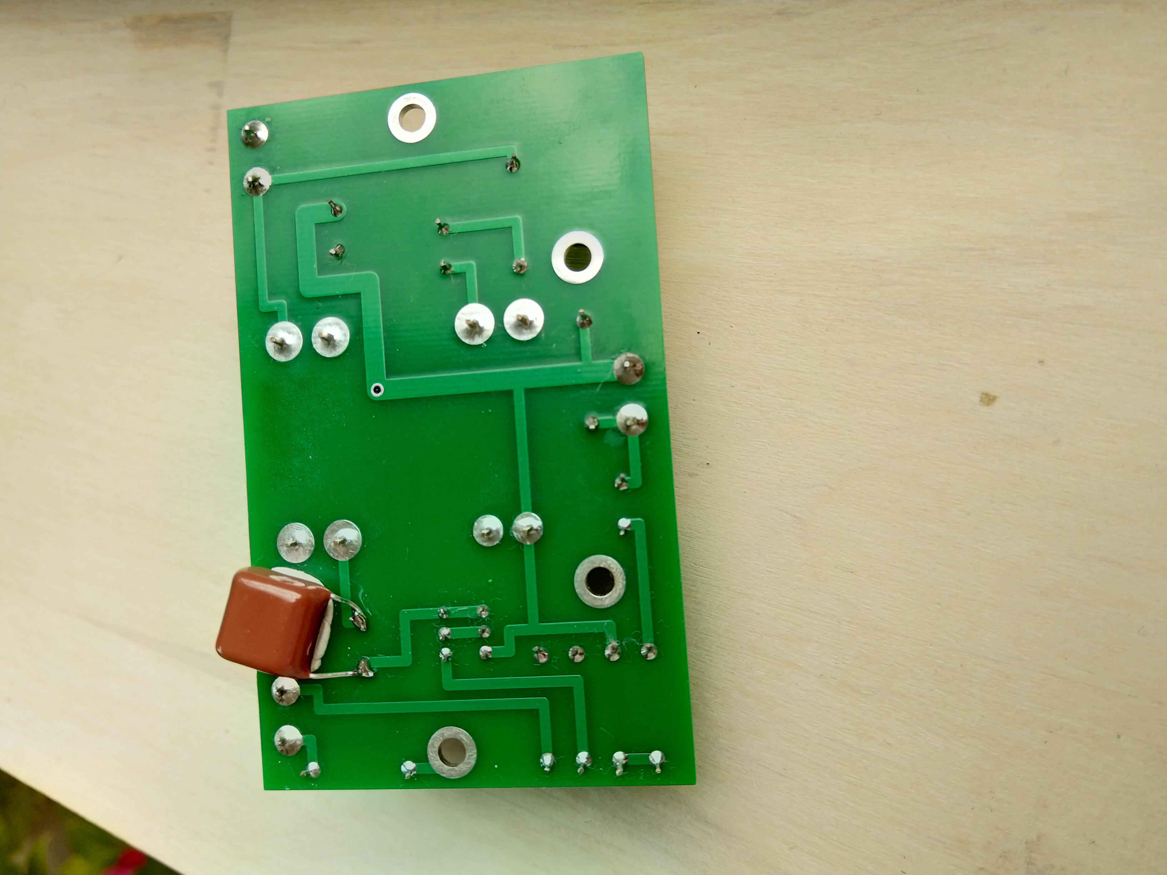

I also experimented with adding caps to the same place on the OS boards. I tested with dry fitting the 470uf 80v Nichicon caps I had on hand. No discernible change in sound, but the turn on thump was eliminated. That’s what I was going for, so I soldered them in place under the board.

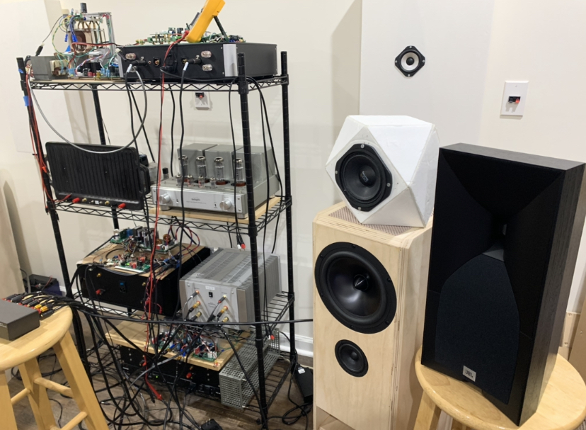

I have been playing my VFET with a set of new JBL Studio 530’s. These are really decent speakers on sale for $250 shipped direct from JBL. The price was too low and I could not resist. 🙂 Bi radial horn loaded compression driver tweeter and 5.25in ported woofer. They probably are voiced a tad bright so I added a 2ohm resistor between the amp and tweeters and that made the tonal balance much nicer. This is easy to do since tweeter and woofer have separate binding posts. The VFET can drive these to surprisingly loud levels and they still sound clear. The two are a great match.
I have 9 amps in this shelf (LuFo, LSA GaN, FH9HVX, LM-211ia, Alpha Nirvana, IcePower 1200AS2, VFET, TDA7293 Xmas Amp, and VHEX+. Most driven by hybrid tube SS SE/Bal buffer with gain. Most of the amps mounted with their rear ends facing out makes swapping amps a snap. I also have an A/B switch to compare two amps with one set of speakers. The VFET is currently in rotation for past 3 days.

Hi TungstenAudio,
Yep, those Nichicon KZ were chosen for their quality based on the specsheet and I wanted to give them a try. They were my second choice, first one wasn't avail before ages at Mouser and even these are in back order and should hopefully reach me before my summer brake.
