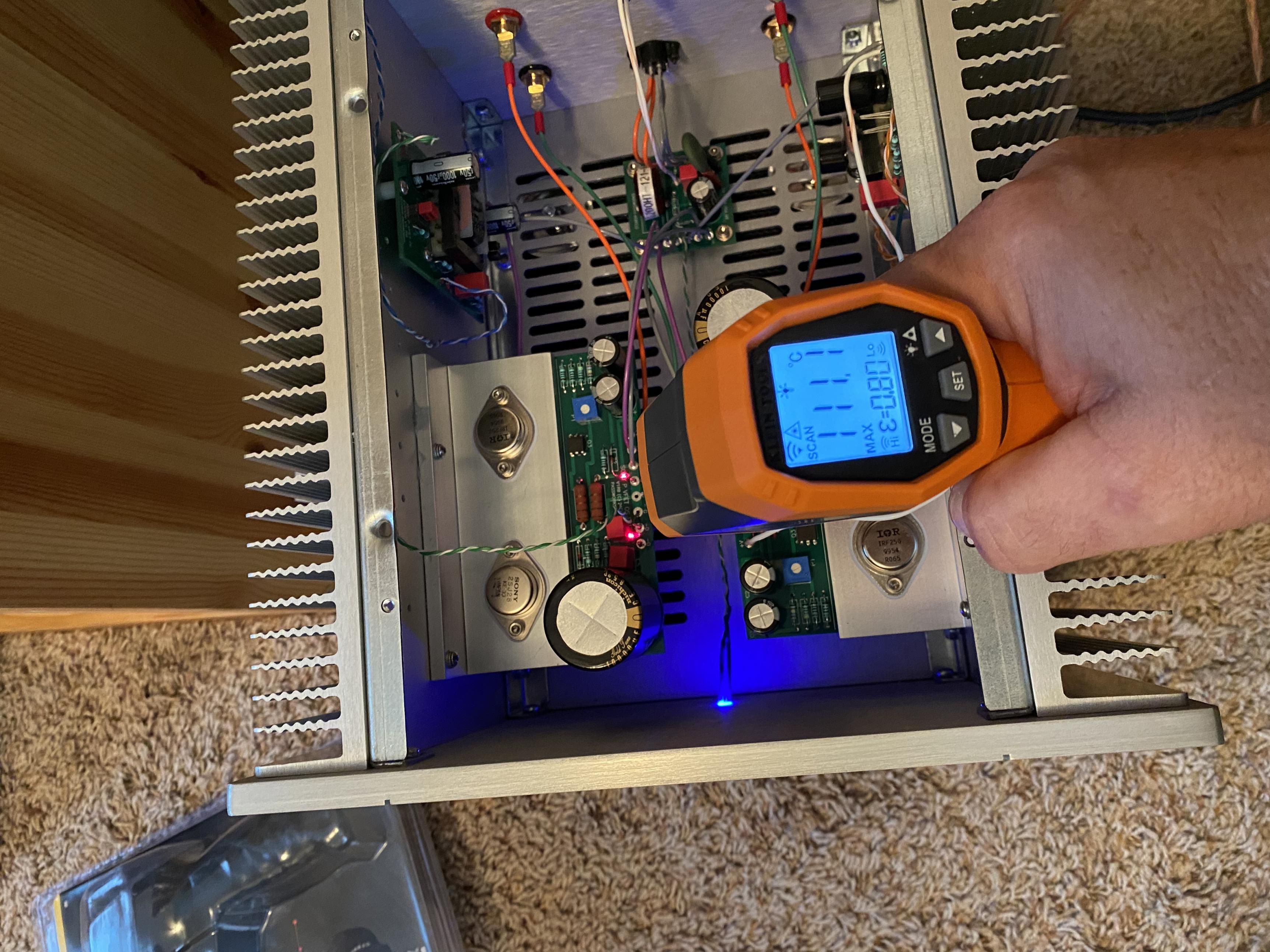

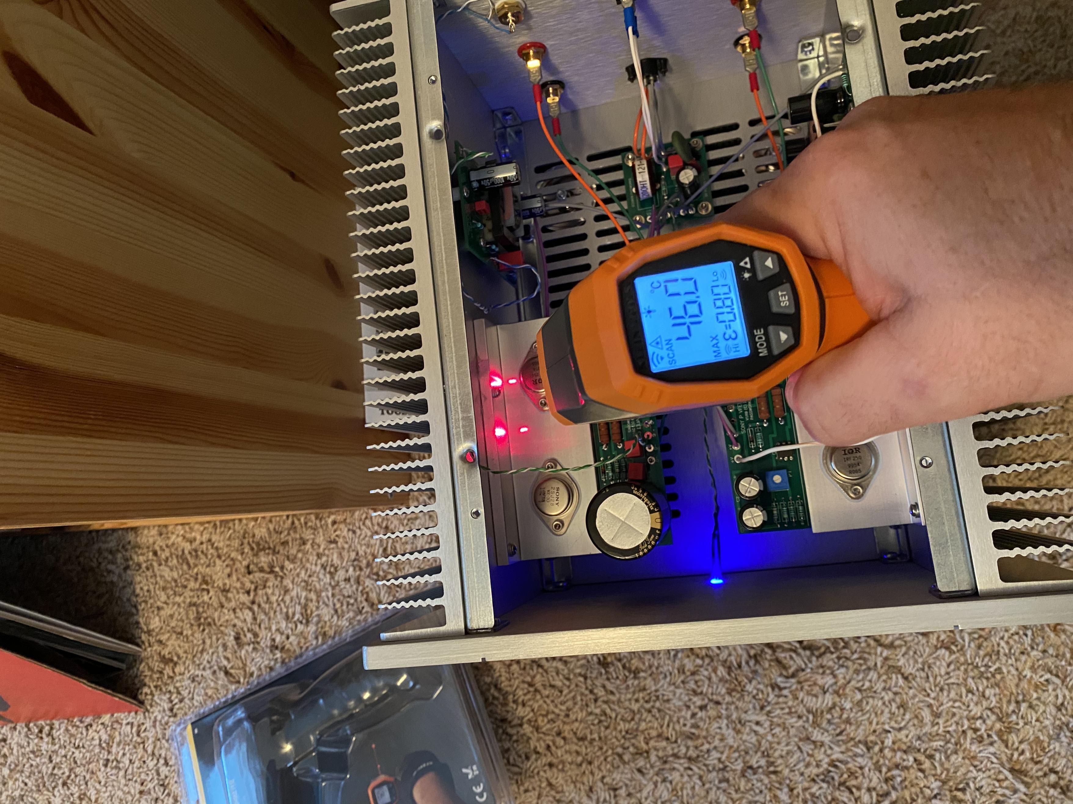

You guys are over my head lol. im just thinking that mine is running just a bit hot....it is 58c on the aluminum bracket to the heat-sink. And 54C on the fins side.
I want to buy some test equipment and get deep into more building and checking and tweaking like you guys. looking at a few things any one got time for a phone call?
That amp does seem to be running a little hot. You should be able to keep your hands on the heat sinks indefinitely without discomfort. Make sure that you installed the mounting screws with extra washers so that the screws don’t bottom out before the T brackets are in firm contact with the heatsink.
Wouldn't the heat sink be cooler if the t bracket to sink thermal. resistance was higher than normal as it would be with loose screws.It sounds like really good thermal contact instead.I would check the bias.Others have said the vfet case is around 70 to 75 Celsius as normal.

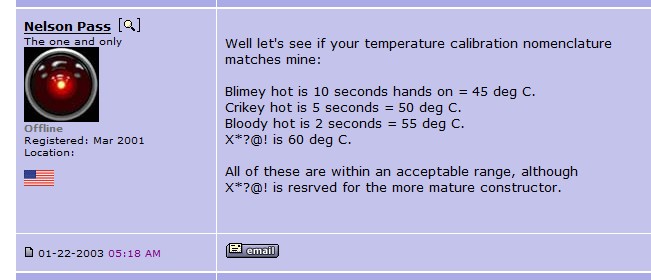

The heat is initiated at the device, so it's the hottest, it conducts to the bracket, (which has no large radiating surface and is inside the box) so it's the second hottest, only when the heat gets to the outside (the fins) is there a large radiating surface area to loose the heat to the air. Thus it's the coolest. The connections between these components are thermal barriers to a degree as you said but the relatively small temp delta tends to infer a reasonable connection. Has Mr Pass not said that the acceptable 55C on a heatsink allows a 10 second average touch time?
No. See link below.
https://www.diyaudio.com/forums/pass-labs/3748-aleph-186.html#post116146

Ok my little key-chain temp-meter is giving me some really wacky numbers. Just got a 137c # and i just don't believe that. um going to buy a new one tomorrow.

OK Klein infrared thermometer. Emissivity set to .80 and amp warm up for 1hour 30 mins. No load just on. I will check the bias again and in an hour or so
