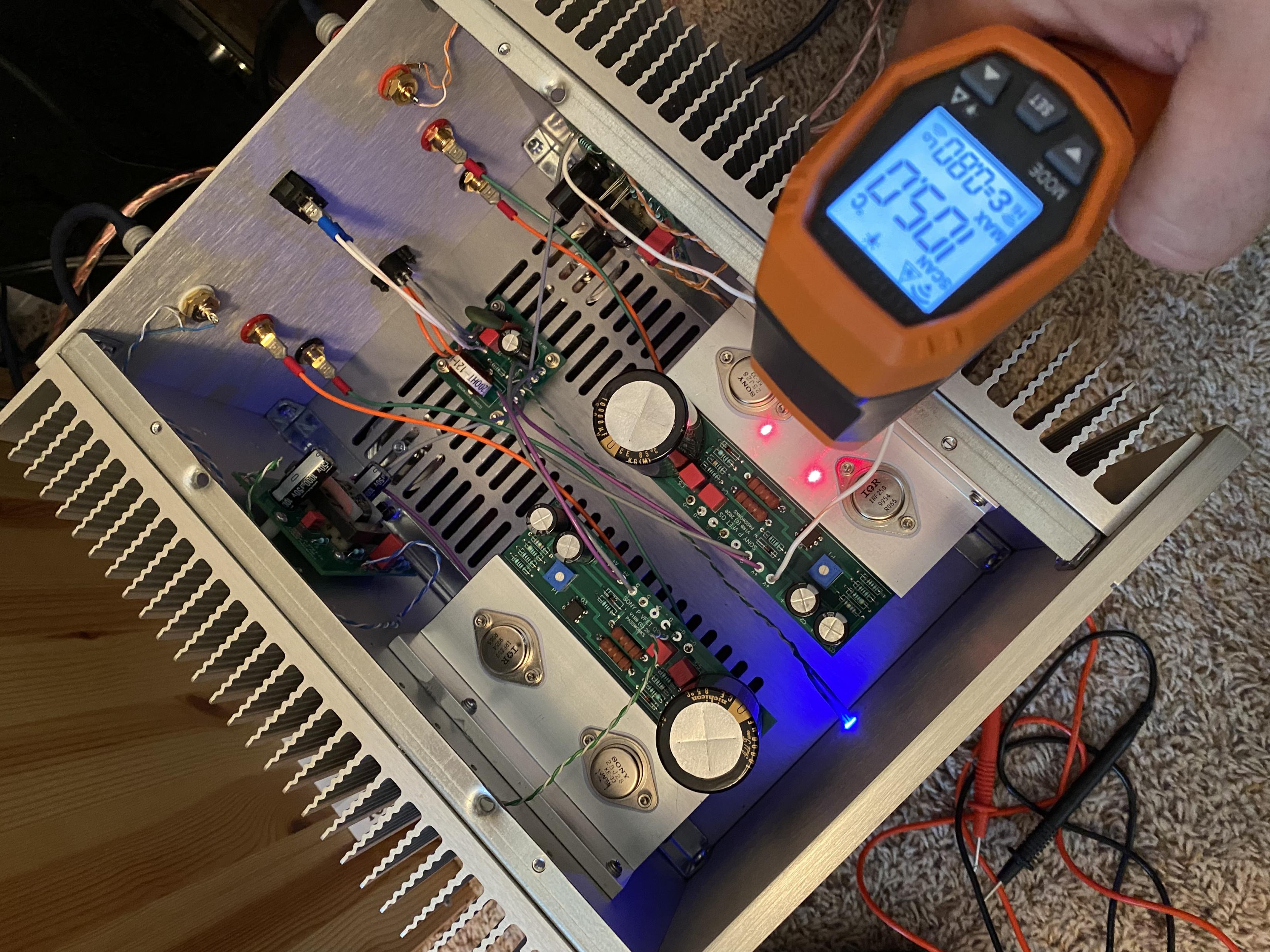

Dam it hot
Bias is 20.02 and 20.03 going to turn it off. probably won’t be able to look at it till Monday or Tuesday any ideas what might be wrong.

Yes, the T-bracket should not be at 105°C. The bias current seems to be correct. That leaves possible issue with the thermal connection between the transistors and T-bracket, or T-bracket to main heatsink. Or the IR thermometer, but I don't recommend a finger touch if they are really that hot.
I found that I was able to tighten the transistor mounting screws in my amp a little more by hand. If you have a torque driver, try 8 inch-lbs. It looks like you already have two washers under the bracket mounting screws, so try three. We want to see a good amount of thermal goop squish out from under the bracket when the screws are tight.

Well, the reading clearly marks 105° C!!! So yeah, other than Papa’s suggestion to point at your forehead and read something like 36C, I agree that powering off, let it cool, and then turning back on and keeping your finger. Remove as soon as you think it’s getting out of hand. Touching a 105 surface is NOT a good idea.
Does your heat sinks heat up at all? Did you put the thermal paste on the L bracket? If there is some sort of dissipation other than the L bracket, you should not see those temps.
But with those temps, I question if you would even feel the insane heat with your hand where you have it. Can you feel it hotter than boiling water?

Vds of 20.02V and 20.03V as well as Iq of 1.22V/0.75R=1.63A and 1.23V/0.75R=1.64A are right on the money.
However looking at the picture, it seems to me that the T-bracket is not snug to the heat sink. There appears to be a small gap between the bracket and heat sink. Add another washer if the screws are already bottomed in the holes, to increase the clamping pressure to close the gap, to improve the heat transfer between bracket and heat sink.

Either the T-bracket was not torqued enough or not enough thermal heat sink paste. I never had problems with having to double up the washers where the bolt were too long. I went with the hex bolts that came with the kit as you will get more torque pressure than bolts having phillips heads.
