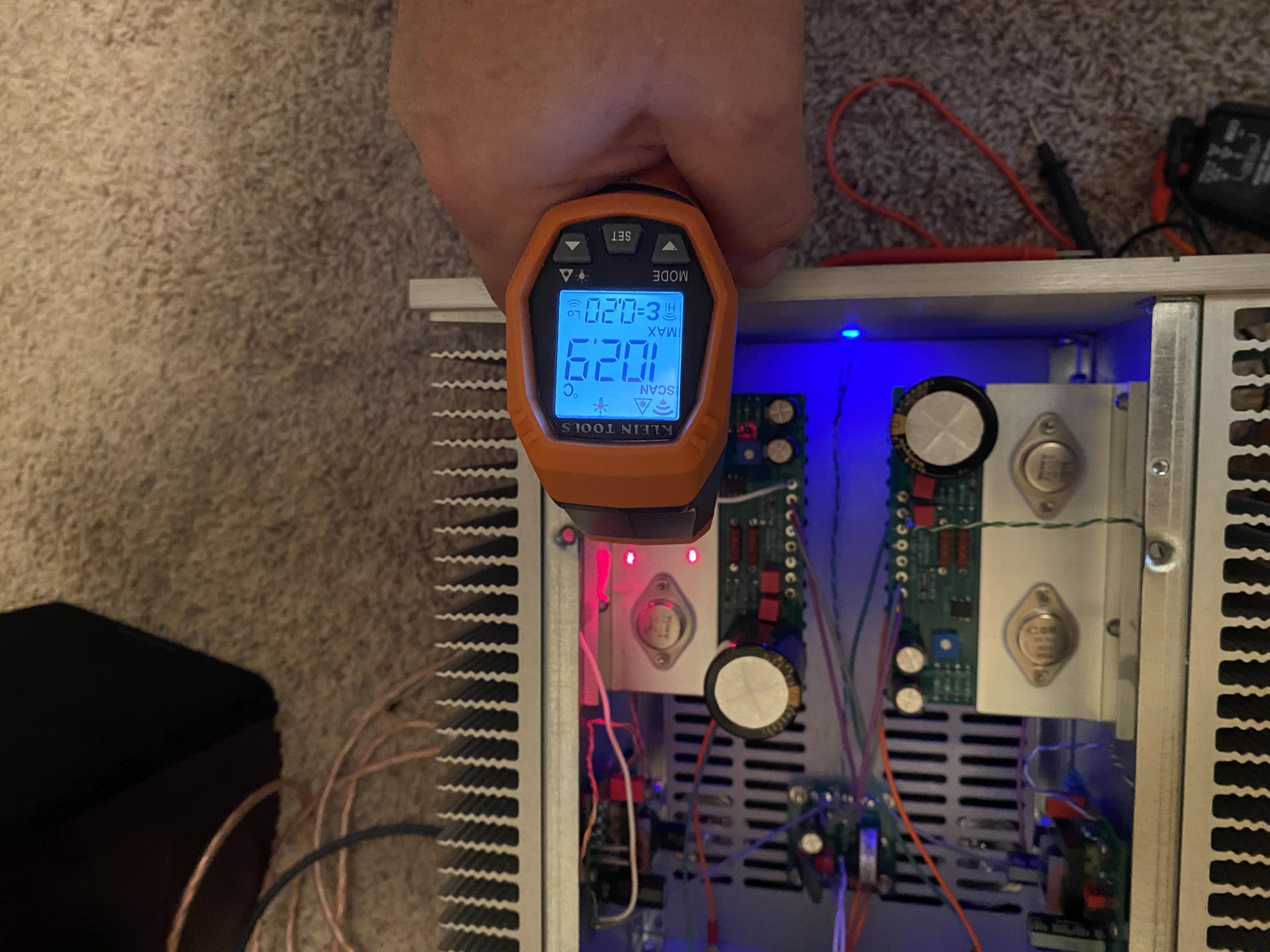

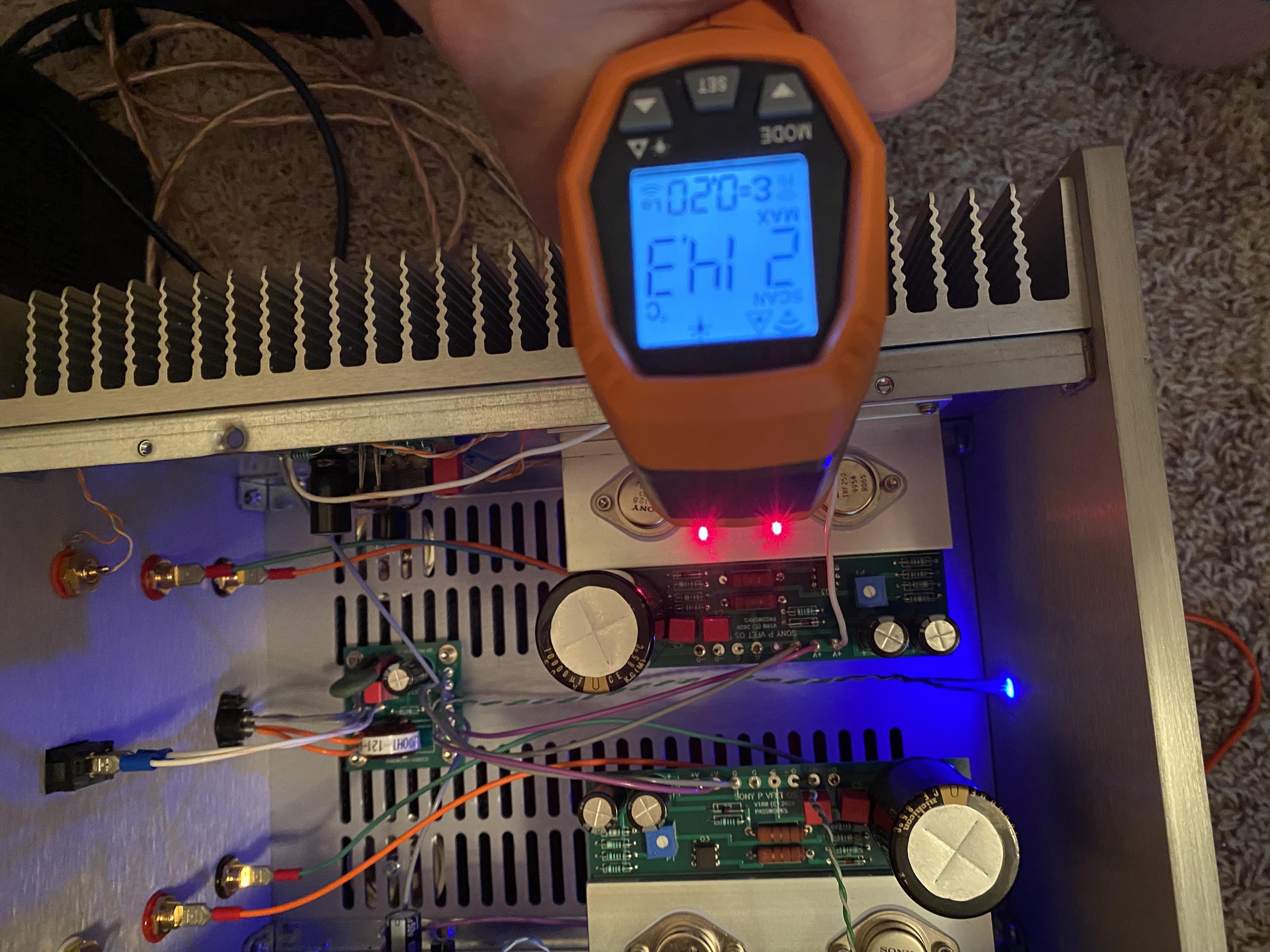

OK I think it’s safe to say an infrared thermometer even set properly is not the right tool to use to measure amp temperature. I can put my finger on this same spot for almost 8 to 10 seconds.
Can anyone duplicate my findings if they have the same type of meter and set it to .2 and check it about an hour after runtime.

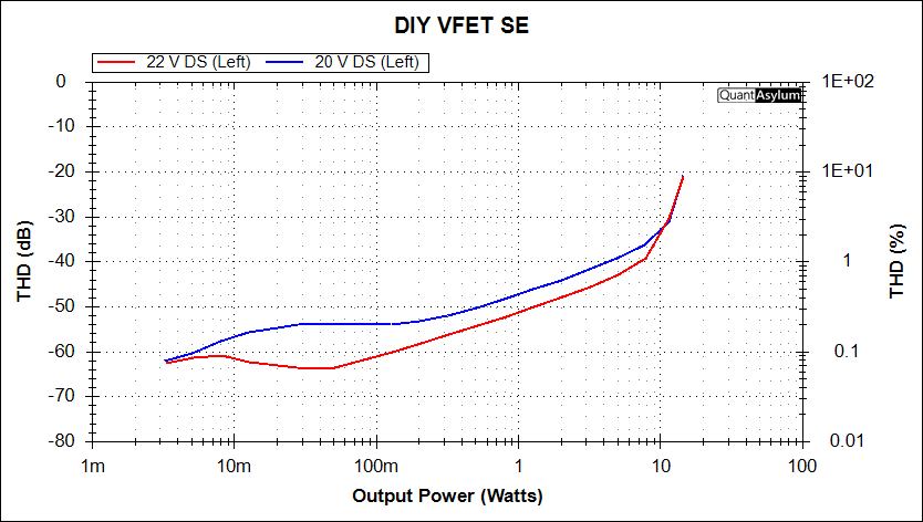

Doing some testing to see how the transformer stock front end works.
When the output is 1w into 8 ohms I see .4% THD. The stock front end hooked up driving the output makes .02% THD.
So, it seams like, as you said, the output follower is the dominant distortion. Seem to me this is what you want.
At the Nelson recommend 20v you get the .4%. Best for average speakers. Have efficient speaker? Increase it to 22v and you are at .26%.
It’s a fun Amp to play with. I’m sure there will be many tweaks coming.

No it’s actually the other way around the two laser dots show the sample area that’s being measured as the dots grow further apart the accuracy of the measurement begins to diminish. so a 12 feet it sample area is 1 foot and at 6 inch its 1/2 inch sample area. Closer is more accurate.
The laser pointer and IR reading sensor only meet at the same place if object is further apart from the meter.
In very close proximity, error where laser points and sensor reads, is biggest.
That's what instructions for mine said.

Hi Botte
You are opening an entire new field!
Indeed, I didn't even thought of daring to deviate from the 20.00V setting I have!
Thanks for your figures, and yes indeed, the key part for me of this amp is the OS board, as that is what makes this amp so special to my ears and eyes.
Thanks again for sharing your interesting findings!
My manual says the most accurate measurements are where the dots overlap. If they don't, it's measuring the area between them.
Do you have perhaps a split of H2, H3 etc. ot see how these evolve with voltage?

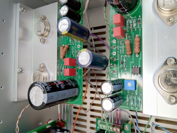

As documented in another post, this is the very simple addition of a low ESR quality 1500uF/50V cap on each OS board, between the +V and G feeds. Full credit goes to Tungstenaudio as he was I believe first to mention it.
This mod seems to work fine with caps from 470uF as other report. I don't know if it helps the FE, the OS or both, but helping it does. Oh, and our amp started several time as expected without any issue (hiccup modi etc.)
We found the mod addressed nicely the areas where this amp was less outstanding in our set up. That is:
- rising edge, speed, slam... notes, when quickly played, simply start much faster... when needed
- composture, maturity, while not losing the joyfull kid inside the unit. The amp is simply less confused on complex music with many instruments, it sounds clearer, can follow all instruments distinctively
- the addictive cinemascope soundstage is now nailed. On complex music, it could lose on spatial precision, or become a bit stretched with focus on the two LS sources. Now it still fills the room while remaining incredibly consistant in density and spatiality in all its dimensions.
- Control over the music, like a better damping factor. The groove factor is still there: it is groovy, but less boomy. That is across all frequencies, perhaps a tad less increased in the bass though, not a problem.
We couldn't hear any negatives or any change in what makes the VFET so addictive re sound quality. It is the same, relaxed, just with more torque when needed, "standing up" in a much quicker way on the "rising front" - that's the way it is perceived by us. I would strongly recommend anyone to try that mod, unless you like it very relaxed and soft all the time. For those worrying: I haven't lost any of the relaxness of the amp, it is just it sounds faster... only when needed, and not say soft all the time and somewhat confused on complex music. Also, it has gained in maturity and neutrality, but is still a very joyfull kid full of colours, nothing is lost on that account either.
An excellent amp on many aspects now gets even better, becoming more consistant across its various qualities: the excellent ones are untouched, the good ones get the very good label. I have some more bits to try, but TBH now - as before and ever - I could live with it as is 🙂
All to our ears for whatever it is worth
Enjoy music
Claude

Pix...

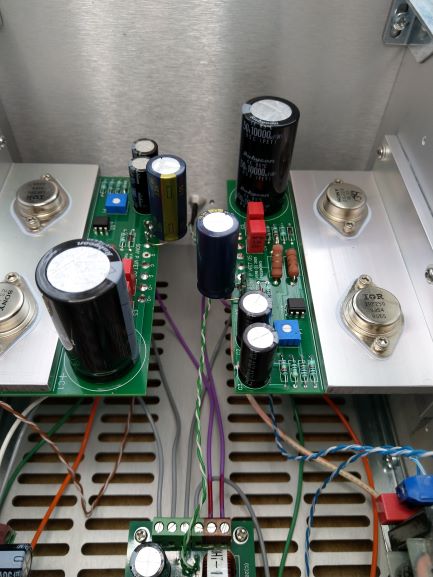

Yes the cables run underneath, +V and G went through and stand proud half an inch or so to make an easy connection to caps (fitting and removing without damaging the boards)

Well obviously somethings not right it’s not on fire in my house is still here so
6 hours run time and nothing has melted. That's a good thing, but i still have know idea what my real temp is. K-Type Thermocouple is my next temp check.

For your viewing pleasure. Look at the bottom ma! I'm not hiding any wires
