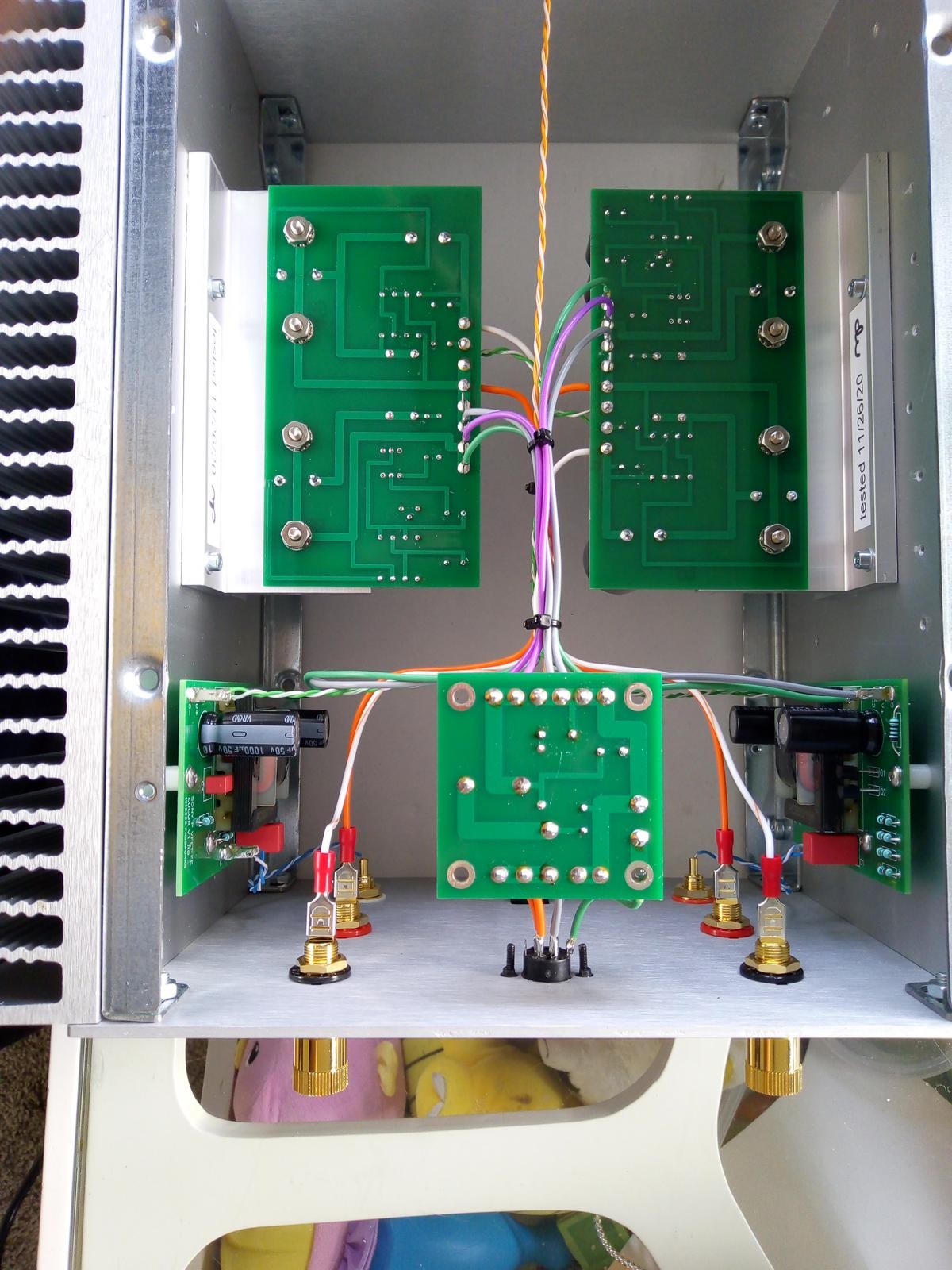

Yes, the delightful upper end is still there – airy, clear and easy to listen to. Maintaining this with the Dreadnought cards initially did require some perseverance. I knew the output stage needed to have R15 fully bypassed, and getting the rest of the sound to balance out required a few iterations of the key feedback capacitors. One of the variations simply didn't work, especially with one recording. I listened to that CD again this morning, and it sounded like I had a different amp. The right combination of tweaks on the Dreadnought cards plus the extra supply capacitance on the main power rails made a big difference.

I'm currently running mine with 37.0V incoming from the external linear PSU, and Vds across the SITs is set at 20.25V. Probably fairly inconsequential differences, but the amp sounds very good this way.
I have taken the precaution of having one diode in series with the V+ power on my Dreadnought cards. This is to protect the opamp during the initial PSU voltage ramp up and hopefully to guard against accidentally wiring power backwards during the many times the boards have been in and out of the chassis.

It appears the VFET does not only attract attention with its external beauty... but raises also a lot of praise regarding its loudspeaker terminals!
Indeed they look nice... does anyone know their reference perhaps?
Thanks as ever
Claude
They are available from the store: Gold Plated Binding Posts – diyAudio Store
