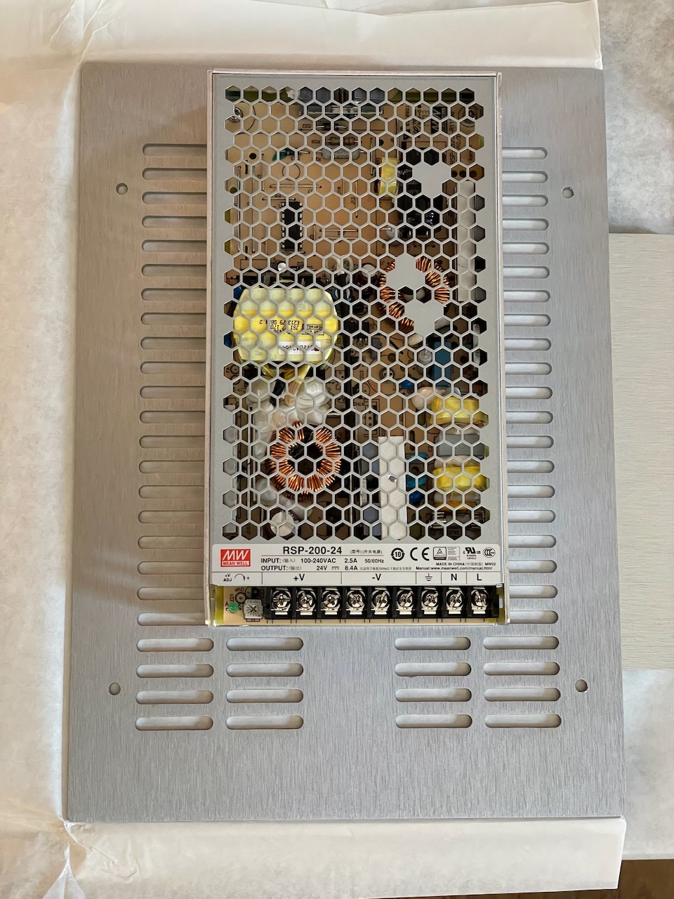

Hmm, so on a purely aesthetic basis, I want to have either an internal or secondary-chassis-enclosed power supply. There's nothing wrong with the Meanwell brick from an electrical standpoint, and I have no compunction about using an SMPS to power this amp... the magnetic field isolation benefit of physical distance is actually a nice benefit. I just personally don't like power bricks cluttering up the floor behind the stereo rack. And I feel a nice amp like this is deserving of something a little more sophisticated (at least in terms of cosmetics). For others, the SAF may weigh in this direction as well, though I imagine many won't mind the separate brick.
But, now that I have the chassis in hand, it is rather apparent that there really isn't room to fit an internal SMPS power supply module comfortably. Certainly not with adequate separation between the high-frequency switching magnetics and the audio circuitry for my taste. Here's a pic of the bottom panel with a Meanwell RSP-200 module for scale (not that I would choose an RSP-200 for this, it's just what I happened to have laying around). By the time one includes a filtered IEC jack at the rear, power switch at the front (yes, I personally do still consider a front panel power switch as mandatory), and a filter board, it's just plain too tight. Even with a smaller module like the Meanwell HRP-150 series.
OK, so on to the backup plan... power supply housed in a separate chassis. Fine by me, and retains the benefit of electromagnetic isolation from the audio circuitry. But it would require a matching chassis to stack with the amp itself, and darn it if this lovely V-FET chassis isn't a custom width (290mm) that doesn't seem to match the standard modushop offerings. So that might mean I have to order a full-custom modushop chassis... this is getting more expensive my the minute.

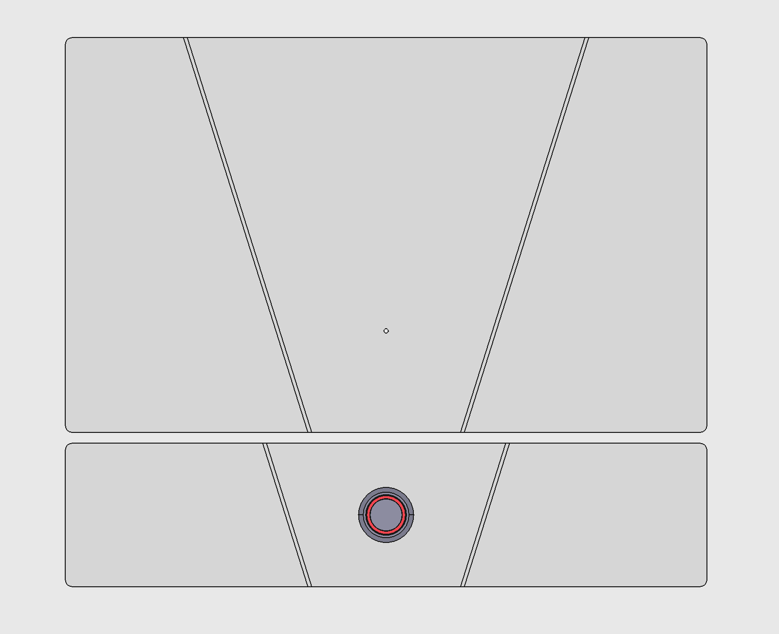

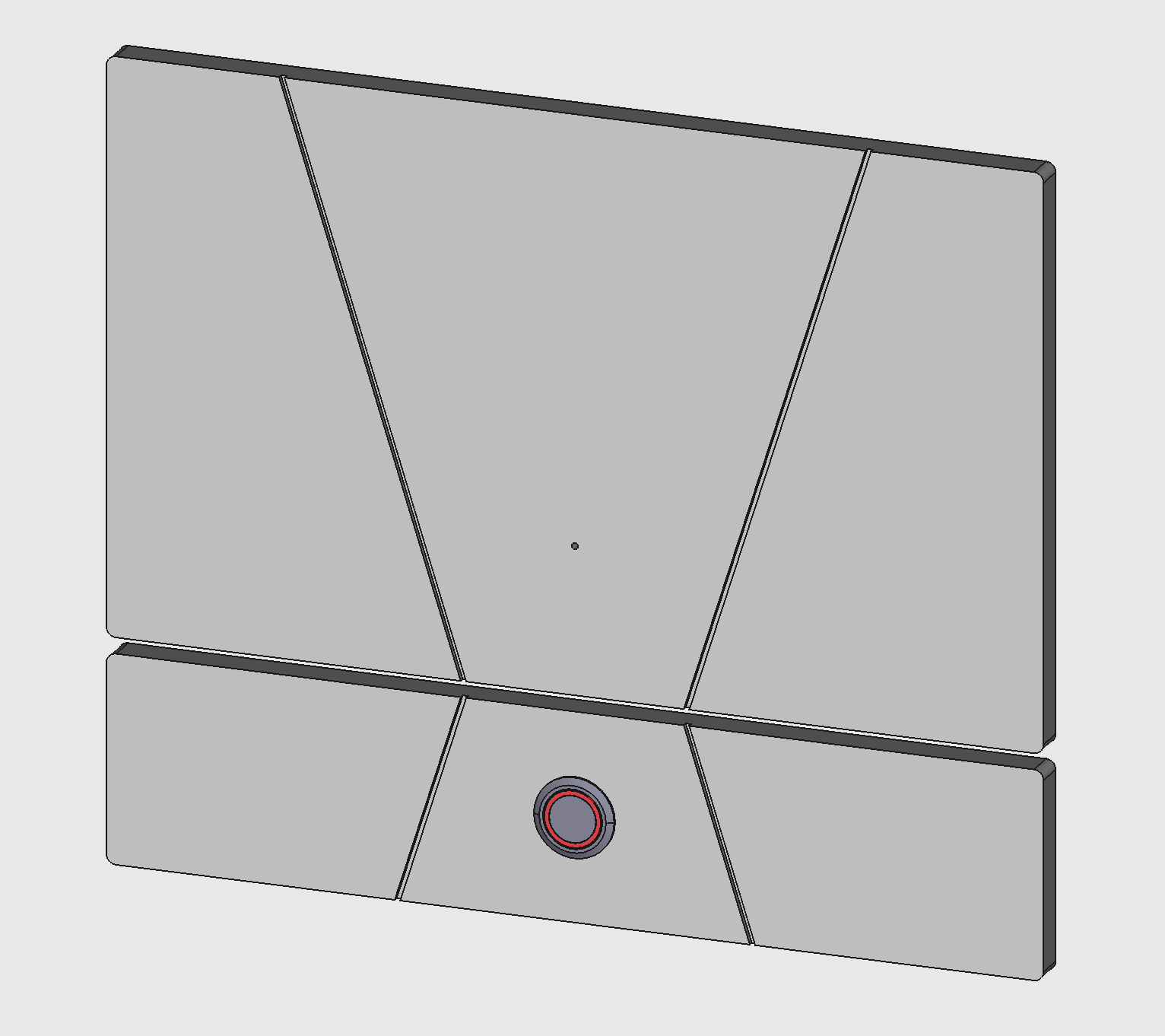

Did up a quick 3D sketch for a potential PSU chassis front panel concept, shown here stacked beneath the amp front panel for the visual. The panel could be installed either right side up to match the V angles on the amp, or inverted depending on preference. The first three are with a slightly smaller EAO power button, the 4th is with my original choice of AV25 (alas TE's step file doesn't show the illuminated ring).
These ones show a 65mm high front panel, chosen for aesthetics, but will likely need a slightly different height in order to work with an economical side extrusion - TBD. Another thought that crossed my mind is that although I intend to use it with SMPS modules only, some others might like to order a chassis which can fit an appropriate toroidal + linear supply caps, so it might be good to leave enough interior Z height for that.
And of course, I still need to cost this out and see if it's palatable or not...

I like it. For what is worth, I think the "inverted" V looks much better than the parallel version.

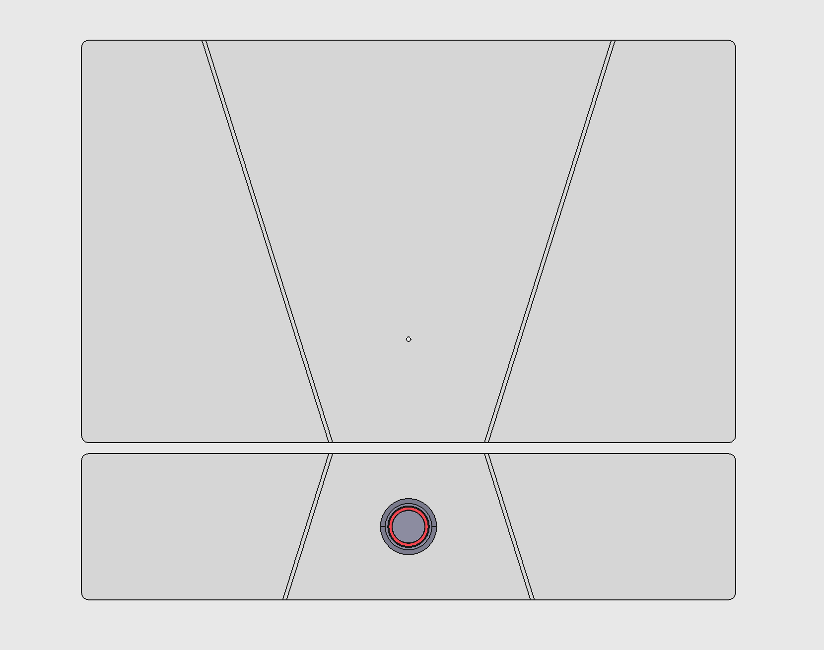

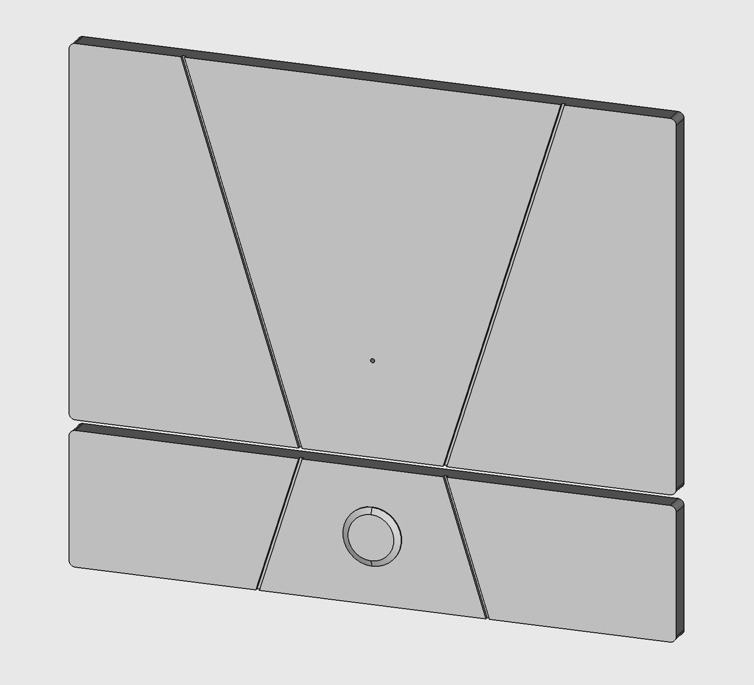

No.3 looks nice, but I just got back and got to take a look at the case: so tiny and cute! Much smaller than I imagined! I will keep the look as is, will be a contrast powering the 220L speaker cabinet and the SMPS will disappear 'back there' somewhere.
