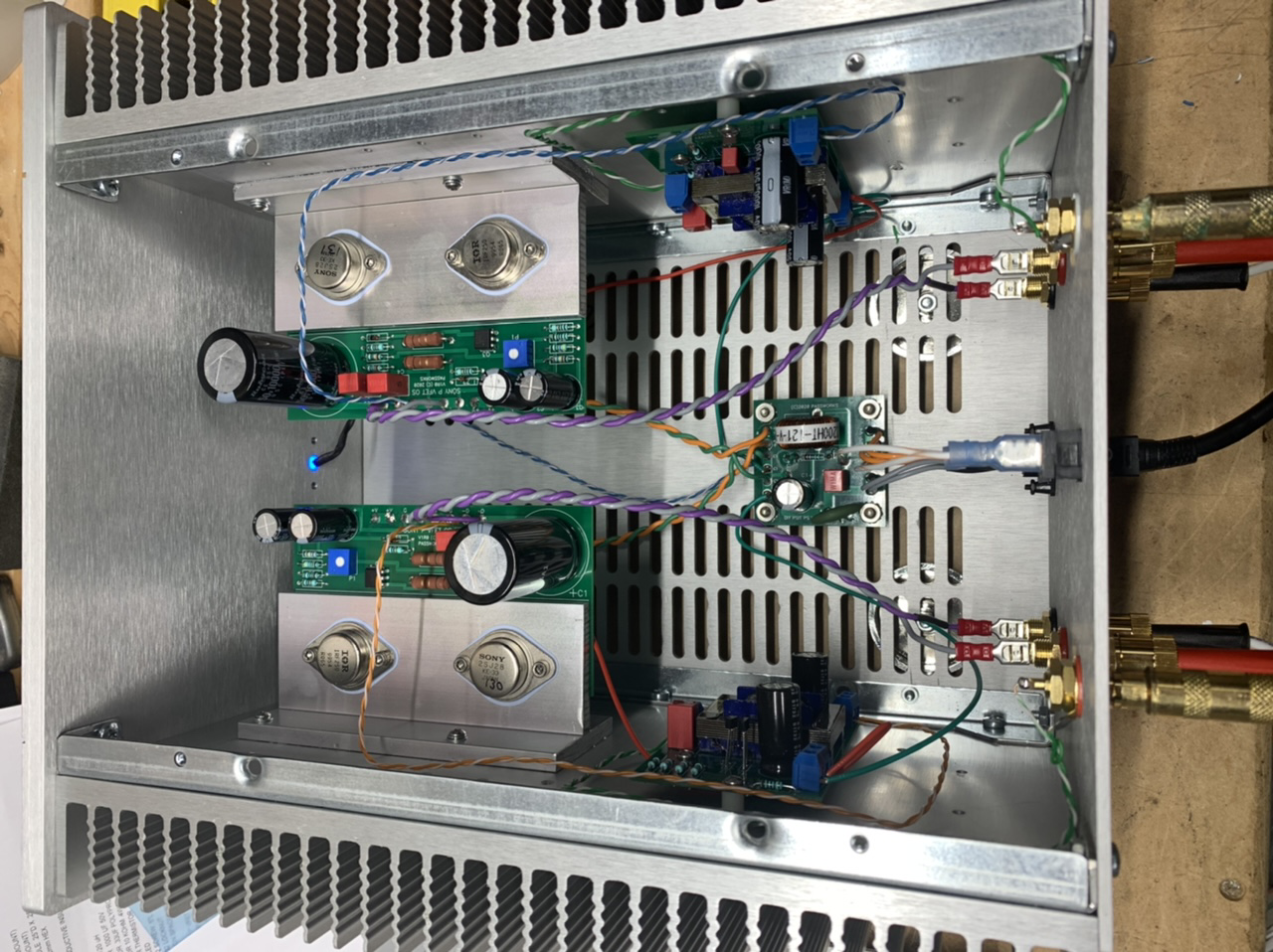

My amplifier is close, just a few more wires to go. I did run out of orange and had to dig through my junk pile to find another piece to keep it all color matched. I'm doing something slightly different with my build regarding the FE boards. I will share a picture when it's finished. Everything has gone together well, final assembly is kinda interesting with 5 pcb's / associated wiring in a bit of a tight space. I did use the screws the chassis came with along with some washers I found to mount the OS bracket to the heatsinks.

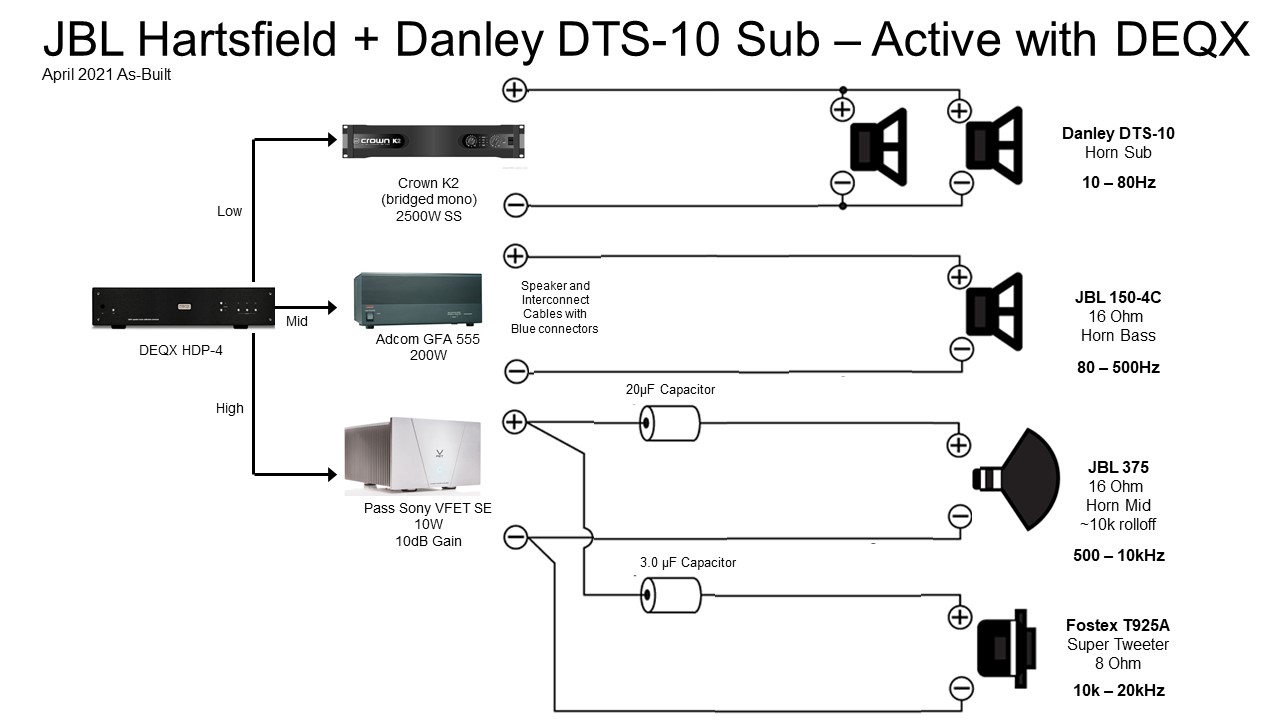

Cooked. Set. Now in the big rig.
It’s running 500hz and up into JBL 375s and Fostex T925As

Not 100% classics. I'm running a pair of JBL Hartsfield reproductions. The cabinets are probably ~20 years old. The drivers are classic JBL. The 375 compression driver has a steep rolloff at 10k, so I added Fostex super tweeters based on the suggestion of JBL expert John @ Classic Audio Reproductions. I have removed the original crossovers to make the system active. So you can say it's a classic design, modernized.
