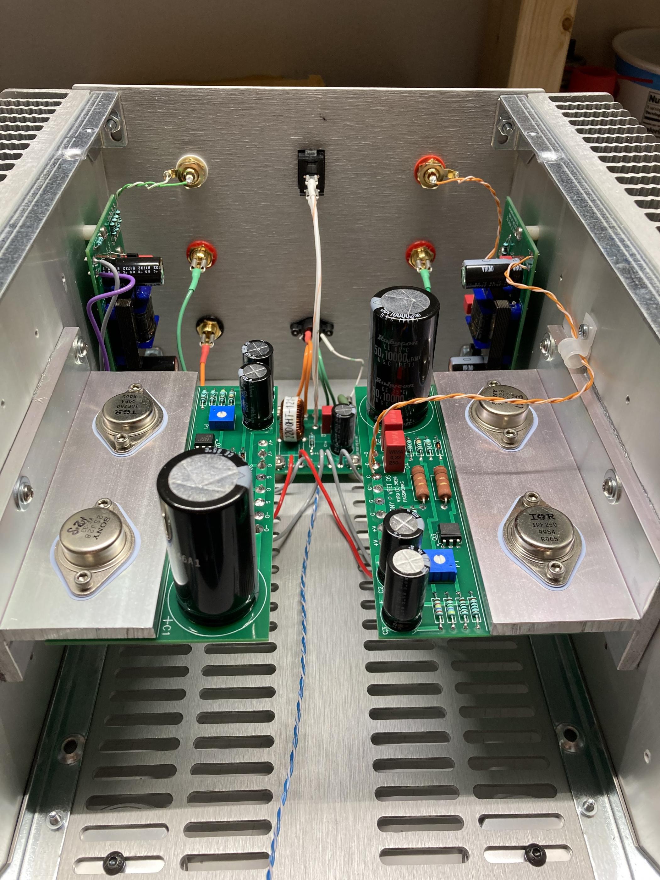

#19 is up and running! Thank you everyone for making it possible!
The most difficult part was to put this chassis together... with my sausage fingers 🙂

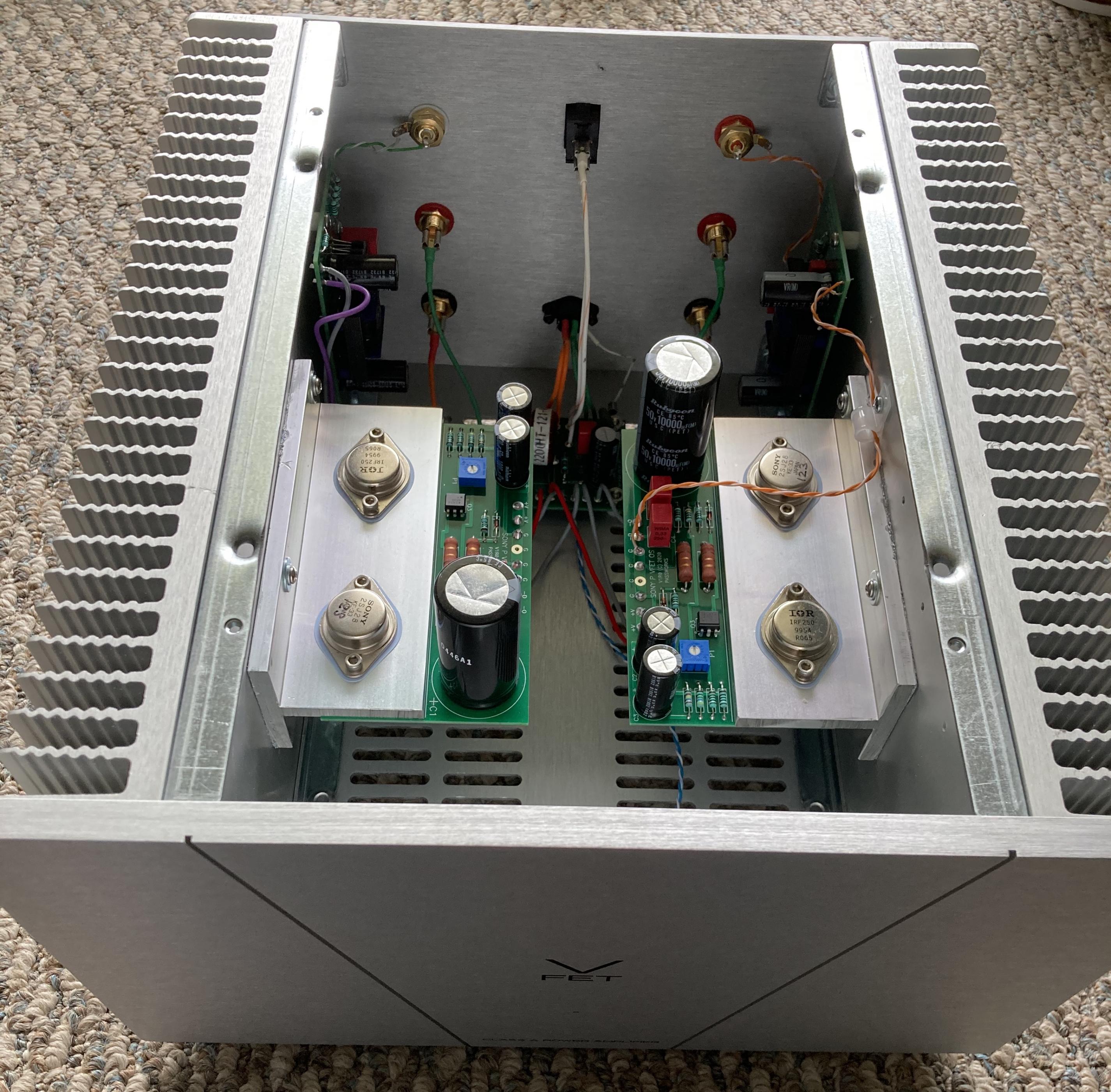

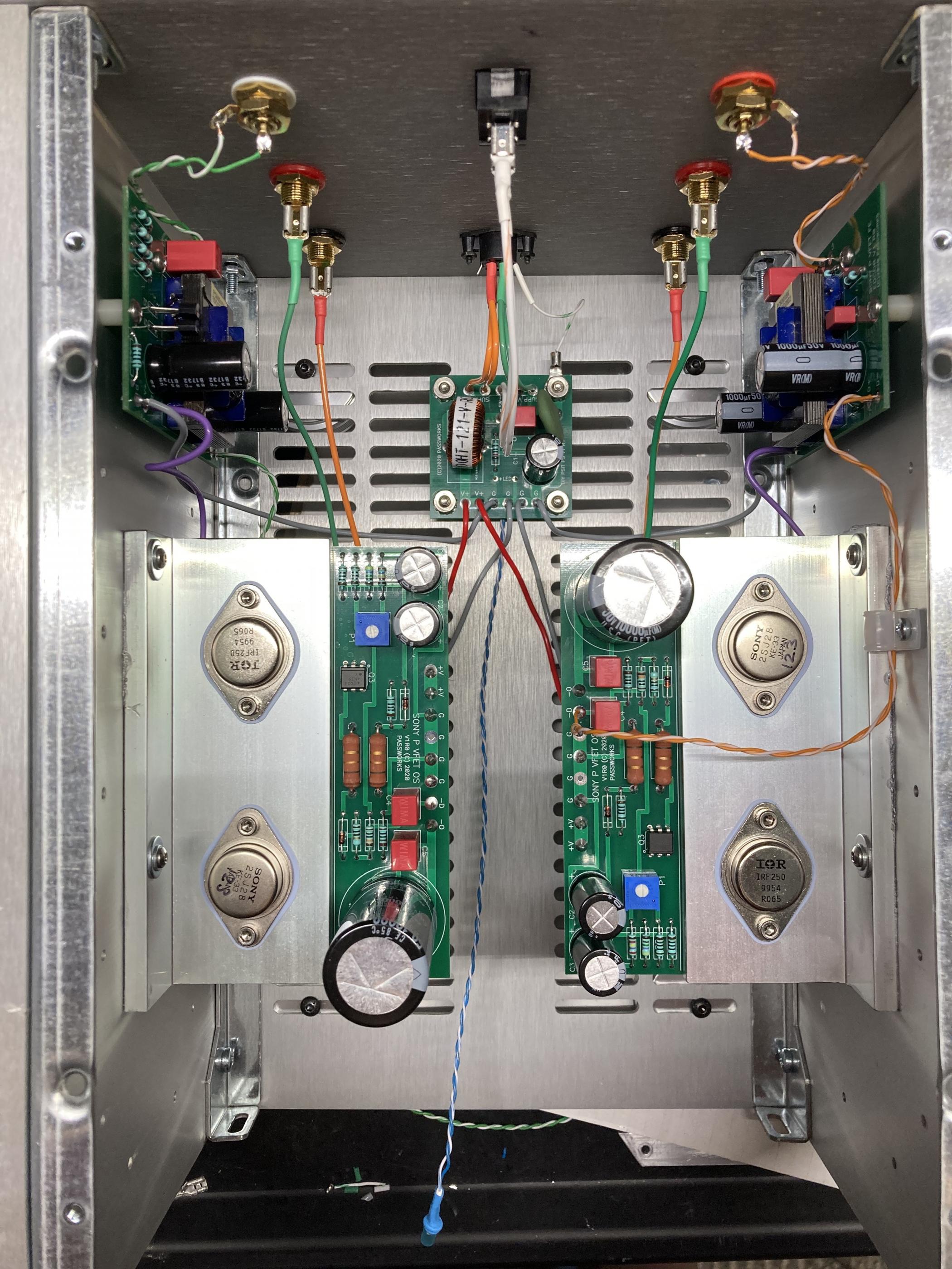

#044 alive

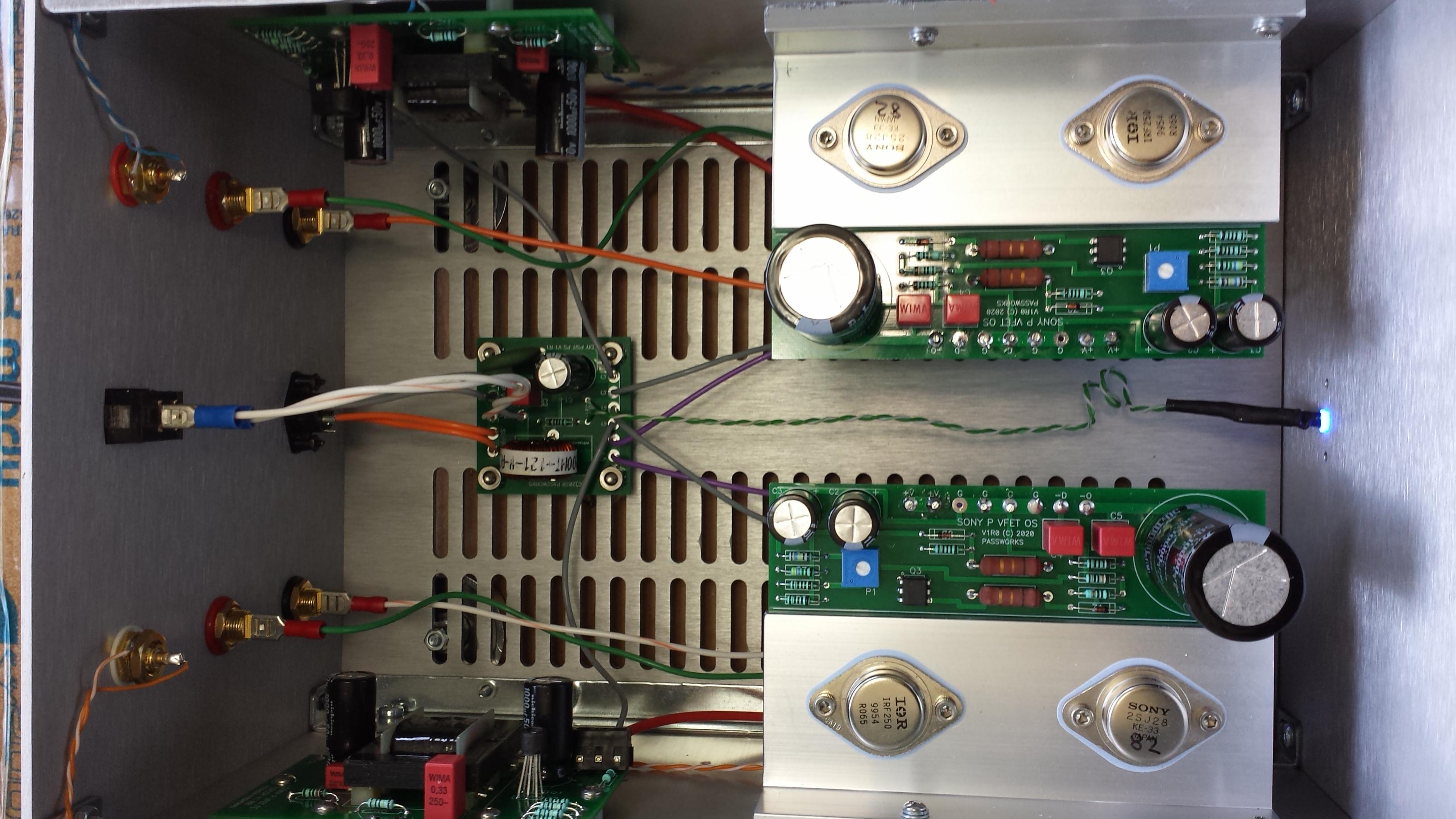

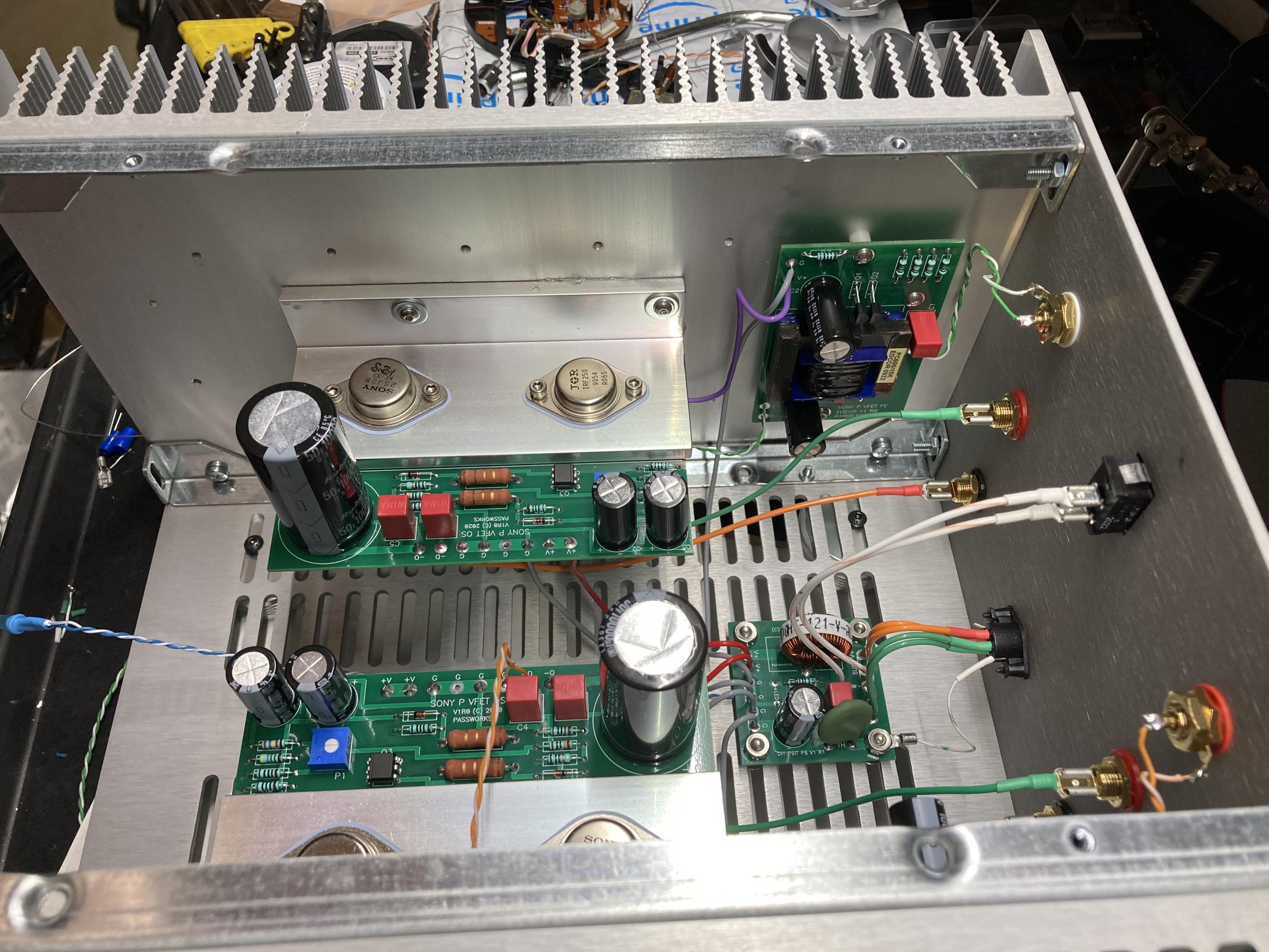

Warming up and sounding good with some Jonny Lang on my little bedroom test system. I mounted both of my FE boards with the -D/+D up. Reason being... to be able to...with some quick easy soldering....move the wire straight to the RCA jack to directly drive the OS from an external linestage with enough gain / swing, just for experimentation sake if I wanted to in the future. Mr. Pass mentions this as a possibility in the article.

Suppose you have a source with enough voltage output to drive your LS loud enough through the VFET power board without the FE board gain. Suppose then you want to try the VFET board direct, that is without any front end (well noting that the existing standard FE is also conveniently inverting phase and not just providing gain). Is my following understanding correct?
If you wire the LS terminal exactly as intented /as in Papa's instructions (eg inversing LS connections INSIDE the chassis), and you are running a "normal source without phase inversion capability, one that maintains always absolute phase", then all you would need to do to get both correct absolute phase and enjoyable "negative H2" out of the VFET amp section... would be to inverse the LS cables at the terminals (externaly). That is in fact equivalent to connecting the LS... as they would be in fact in an usual amp.
Is that right?
Asking because, depending on the loudness we will get in real life, my calculation tend to show that I shall already get reasonably loud on usual material without FE. Hence mounting a simple switch that would enable me to bypass the existing FE - in hope that this "pure direct mode" would sound even better. I see no danger as, if I am not mistaken, I can easily get the intented result re sonic signature (absolute polarity and negative H2) while the VFET power modules do have a very high input impedance and DC input protection (the input cap) enabling probably to connect directly a coventional source without dynamic or frequency response downsides. Then, IF really wanting to go party mode I could still switch back in the FE module, getting then more oomph (gain, hence output power), but admittely then - if I am lazy to do anything and I don't reverse the LS cables- with inverting absolute phase and positive H2 in that specific case. But then, if a party, who cares LOL!
My modest FE module tweak could hence be a clever and discrete simple quality switch (say one per channel for easy implementation) somewhere hidden at the underside of the chassis, bypassing or not the FE (while everything is switched off)
Does that make sense?

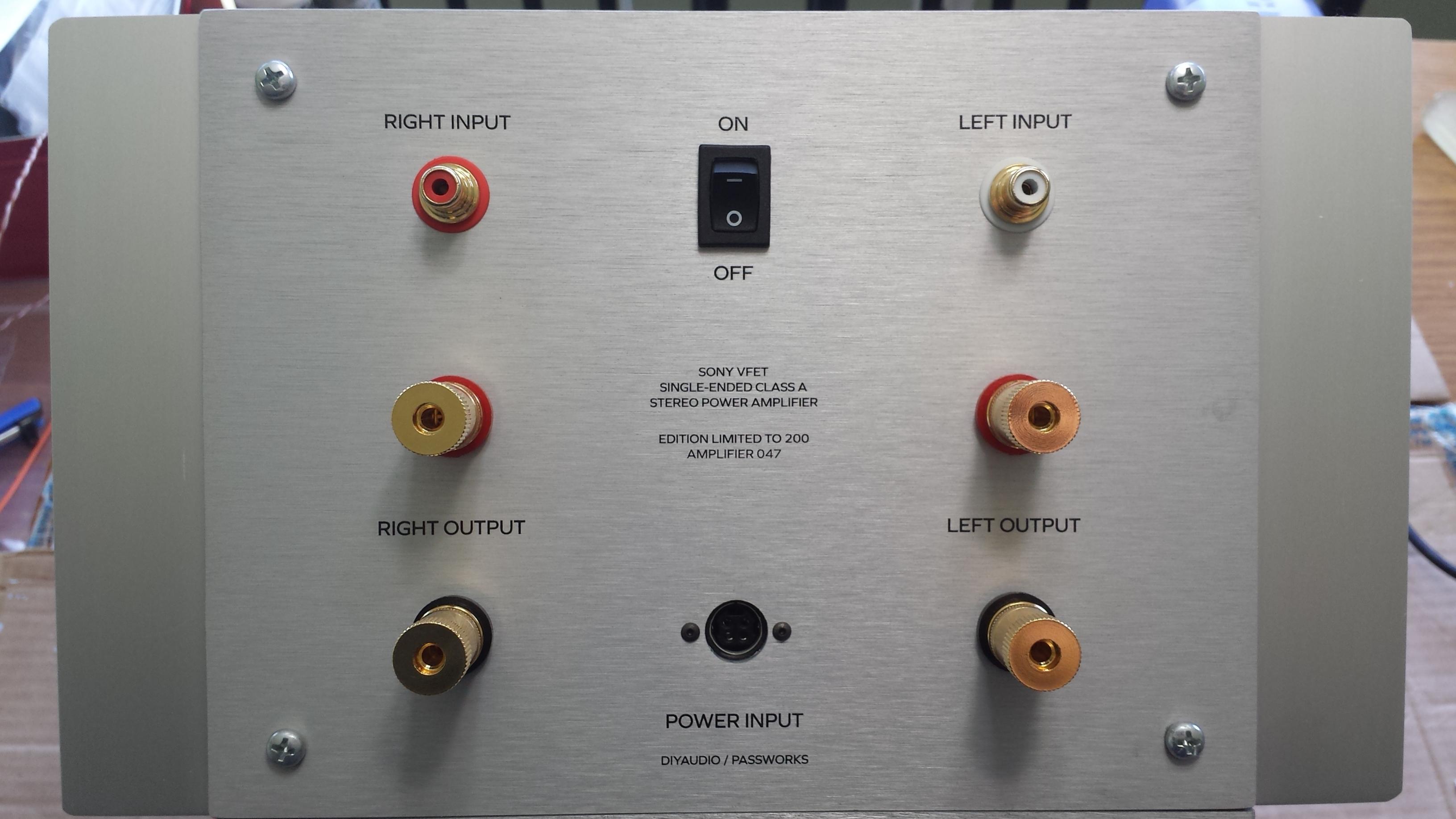

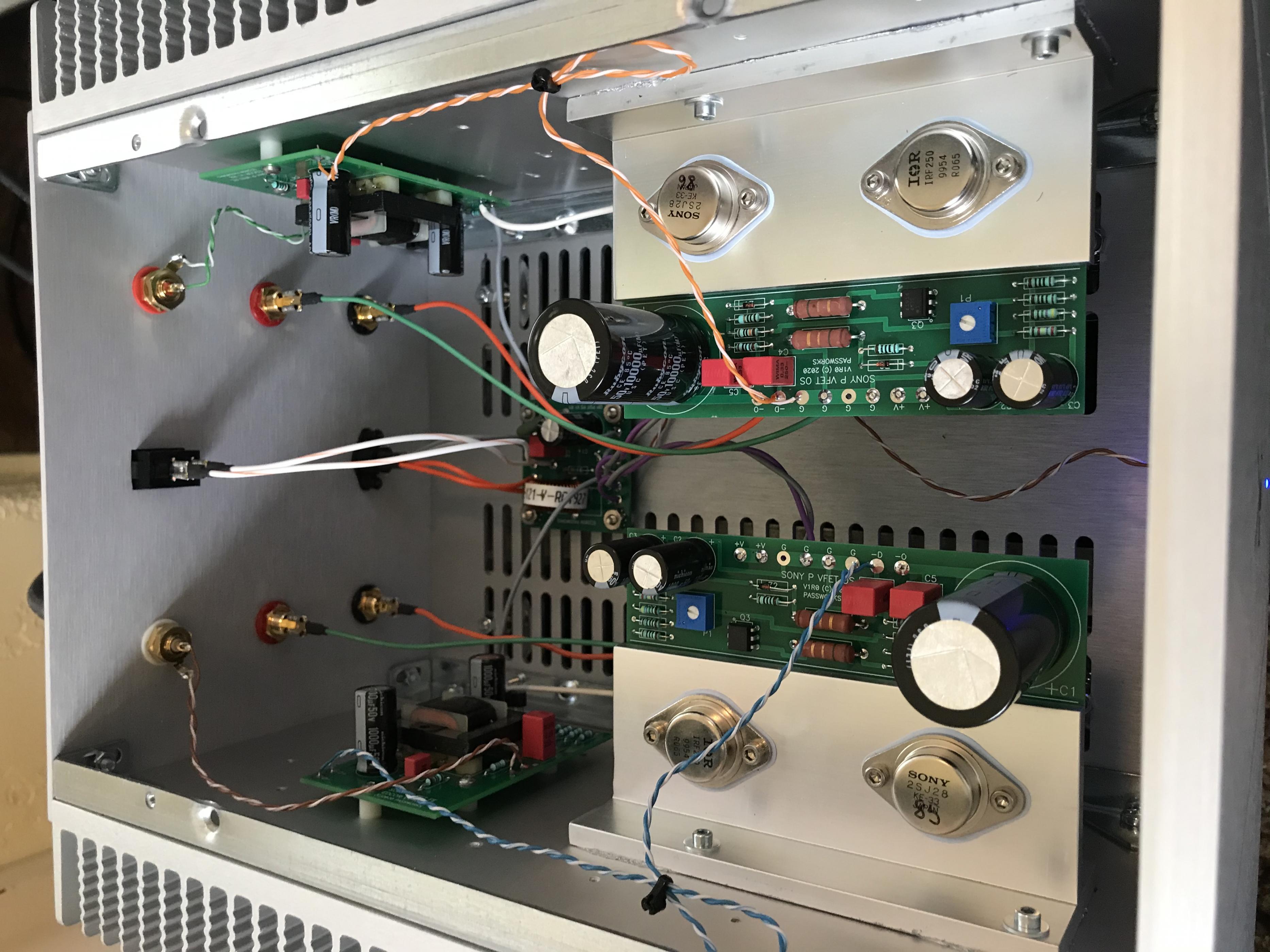

Amplifier 047 is alive and playing some very sweet music on a pair of Monitor Audio bronze on the kitchen table. Will be hooking it up to my Elsinor mk3 soon. Thanks for this wonderful amp Nelson and the whole team. A few pics for the porn addicts....
Unfortunately it doesn't work that way. On this particular circuit you need a phase inverted source in addition to a phase inverted output to get correct absolute phase and negative phase second harmonic.
The upcoming N channel does not need inversion at all.
The front end cards that don't use an Edcor transformer, have a slide switch which lets you select whether you want inverted, or non-inverted signal polarity. The ones which do have an Edcor can output either polarity, merely by swapping (or not swapping) the transformer secondary wires.
