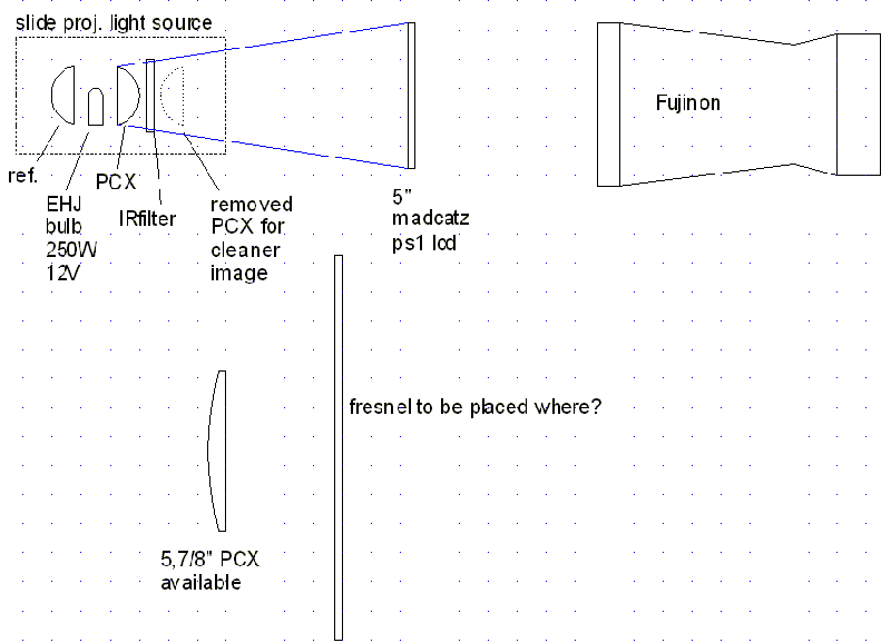

I finally received my fujinon lens and a big 5 7/8" plano convex lens from surplus shed yesterday! Never again will I skimp on shipping and not go air mail - 10 weeks it took. But now I can finally move forward with my design for rear projection using 5" ps1 lcd. I haven't posted for ages since I didn't think I had anything new to report since really progressing the front projection using a ohp fresnel design as far as I could. I have still been reading the threads as much as possible though!
I was planning on using a Delta 77 lens, however discovered that it was designed for a curved CRT, and so is no good for our purposes. The older fujinon seems to be intended for flat CRT's, so should be perfect. I had a quick test of the new lens last night, and the quality seems excellent. I do have to figure out where to put additional lens elements to correct a sort of pincushion effect I have though.
With just the fujinon lens you don't see all the picture, just a circular patch. With a fresnel just before the LCD you do see all the image, however it is pincushion distorted and the edges are not all totally in focus. Same sort of effect with the big PCX just before the LCD. I couldn't try the fresnel just after the LCD because of the physical size and my setup, but I did try the PCX there between the LCD and the fujinon, and you get a similar sort of thing again.
Does anyone have any suggestions for lens placement for this kind of setup?

OK, time for an update on my progress with the new surplus shed Fujinon lens. I have managed to get a fairly consistent square image. Turned out I was using the fujinon the wrong way around... 😱 So now I have:
Light source: 10k lumen 250W EHJ bulb with slide proj reflector/PCX lens and IR filter
Before LCD (as close as I can get it): OHP fresnel and a 5 7/8" PCX from surplus shed clamped to it in the centre.
LCD: PS1 screen 5" with pal composite to RGB converter circuit
After LCD: Fujinon lens mounted very close to LCD (approx 10mm)
Notes so far:
I was able to get the image about 1.4m X 1m which is the size of my rear proj screen with a distance of 2m between the LCD and the screen image. It seems the closer to the LCD I mount the fresnel/big PCX combination the more of the LCD screen I am able to project. Currently the curved side of the PCX is nearly touching the LCD and I get nearly all the LCD visible, just the corners seem cut off. The fresnel/pcx combo converges the light quite strongly, I think if the fujinon was not there it reachs sort of a minimum spot size of about 4cm approx 15cm from the fresnel/PCX. Fresnel on its own in not enough to make my light source converge.
I was also not able to mount the fujinon close enough to the LCD to get the image in total focus, my LCD is mounted on 12mm mdf.
I dunno if anyone is interested in this sort of setup or not, but I thought the experience could be helpful if someone is looking to use similar parts.
To summarise what I have done so far, I reckon the fujinon lens is a goer for the 5" lcd, however the 250W bulb setup is not bright enough, will look for either a better reflector/lens combination or an alternative. More work is required to ensure the whole LCD screen is visible.
I also think ultimately I will be disappointed with the resolution of the LCD, but ah well, I am committed to finishing this design before I think too much about better res...

Another progress update.
This time I have the whole image in focus and illuminated. Modified the mount of the LCD so that I could get the fujinon lens close enough to focus, and it definitely works extremely well. I get a totally in focus 1.2m diagonal image with 2m between the image and the LCD screen. I stuffed around with optics between the light and the LCD to get the light converging enough for the fujinon to 'see' the whole image. I had to drop the 5-7/8" PCX lens from surplus shed, it just wasn't large enough to do the corners of the screen. Instead I have two OHP fresnel lenses sandwidged together. (actually I think each OHP lens is actually two stuck together already, so four in total!).
I took some dig photos, but again, they really didn't come out very well. Seems really difficult to accurately capture the brightness level of the screen. Conclusions: optics are pretty much sorted out, but 250W quartz iodide globe with slide proj reflector and PCX lens is not bright enough. I looked at metal halide, but seems too expensive. I think my best bet is to make/use a reflector to more efficiently use the light from the 250W globe. I think an awful lot is wasted right now. Also if I had more brightness in the light source, I could turn down the brightness control on the analog video processing, which I think is washing out the image a bit, wasting some of the available contrast ratio.
