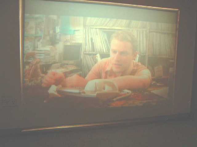

For some reason images are working now... attached is a crappy photo of a 1.2m projected image on a painted wall.
General progress:
My latest thought is to use a car headlight reflector housing and modify it to use the 250W EHJ globe. I took home an optical power meter from work and checked out my setup, and a couple of things were evident, I am not using the available light from the EHJ globe very efficiently, and consistency of intensity across the screen is not very good. Both these things you can really tell just by looking at the final projected image though...
Anyway I thought it is too difficult to build custom reflectors, why not cut an access hole in the bottom of a headlight reflector, mount the 10000 lumen globe, provide fine thread screw adjustment of position to trial and error find optimum bulb placement, add a heap of cooling to prevent the reflector housing overheating, and hopefully end up with 80% or better efficiency. I don't know what beam spread angle you get from a typical headlight, but hopefully a system of fresnel lenses will converge the light OK. Radiant heat might be the biggest problem, I might have to have another go and trying to get low-E glass.
General progress:

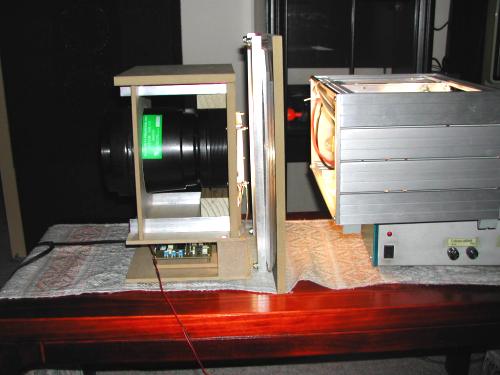

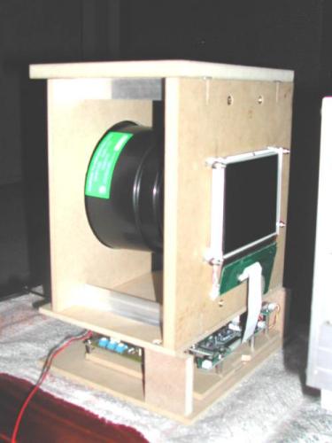

My setup is in a bit of a permanent state of flux, but basically the 250W globe is in a little chassis from a slide projector with a little reflector, IR filter and a 2" PCX lens, lcd is madcatz ps1 5", lens is fujinon, and a couple of fresnel lenses to converge the light through the LCD.
someone also asked about dismantling the ps1 screen, so here is another photo showing the lcd driver a bit more clearly. The two madcatz pcb's are just visible on the little mdf shelf under the lens setup, there is also a pal composite to RGB converter mounted there as well.

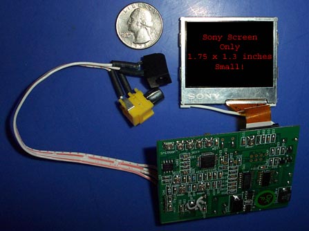

You prob. already know about it. But have you seen this one. Its a Sony lcd. Its rca input ready 12v powered and comes with the driver board. ITs as thick as a US quarter and about a slide size dont know the res. and stuff though. If ya find out let me know though.
Check here:
http://www.spybag.com/cgi-bin/spybag1/SB3002.html

That little 2" lcd is too low resolution really. It says 440 lines, but probably means 220 or less with some electrickery in the driver to make it appear more. But even 172x220 res is 37840 pixels, so 20,000 is even worse than that!

Tinker,
I, too, had been thinking about using that panel. (Spybag had it cheap on ebay) Anyways, here's the info sheet on that panel (not the board) from Sony:
http://www.sony.co.jp/~semicon/english/img/sony01/a6802586.pdf
The contrast ratio is decent enough, however the actual resolution (~290 x 220) is the pits.
