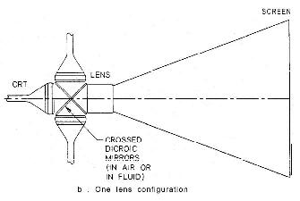

Here is an old picture of a three CRT RGB 'Recombiner'. This one does use half-mirror's (From U.S. Precision, now of Corning. They made the Delta lenses for Barco and other's).
