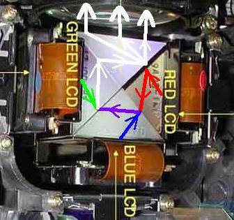

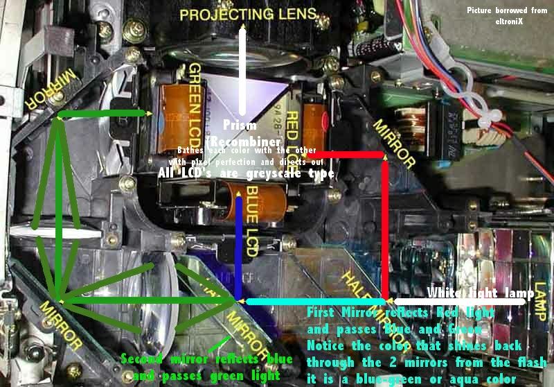

By the way, could someone explain the prism arrangement in the picture of the NEC projector? (first post in page 14)
I really cant understand it 🙂

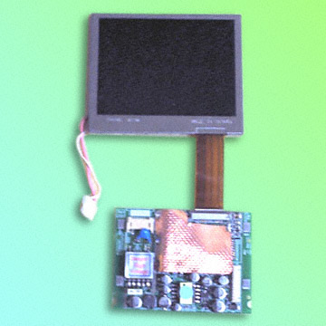

The other picture shows the 2 boards used for the 3.5" he has, they connect together with the panel for three separate boards for that 3.5" panel.
That is correct about dividing the 528 by 3 to show the "delta" configuration #'s. So there are 176 horizontal (left to right) delta's times 220 vertical (top to bottom) rows.
Looking at the Midas website they have choosen to display it as 176xRGB to let you know the exact specification to engineers. If you look at a panel for a laptop with XGA, that should be listed as 1024 X RGB X 768, but we are used to seeing it simply as 1024x768.

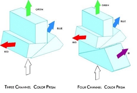

The prism is called a Three Channel Dichroic Prism. It accepts the RGB colors at three of the faces and directs each color into the other including it's previous color reflected on it.
Through a 3 half-mirror setup inside the prism the separate colors are combined into the white light output. Not sure if it starts with green or red though, but I doubt its blue.
Inside the prism, facing opposite each associated color is a thinly coated material that faces the light at a 45 degree angle. It is the same style as the half-mirror.

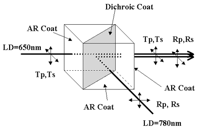

Could not find a picture of a 3 color prism, but here is an example of a 2 color Dichroic prism. This light passes through it's specific color and then accepts one or two or all three colors, in that order I believe. Little confusing for me too and difficult to explain. Let's see if I can find another picture.
I wonder if the colors are setup that way to the prism because each color slows it's speed down at a certain rate and will affect the picture out. Maybe, why Green's channel is so long to the lcd. It's compensating for the slowing of the wavelength of Red and Blue inside the prism. Anyone?

Looking at the projector picture, I would say it starts with red and goes into blue and then green. There looks to be a baffle on the one side of the red prism area.
There are 4 triangles, hence 4 prisms mounted to one another.
Here is a picture of a 3 and 4 channel Dichroic prism.
A paragraph from ScienceNet on prism's:
"When light passes from a less dense to a more dense medium - which is what happens when light, that is travelling through the atmosphere, hits a prism made of glass and therefore denser than the atmosphere - the velocity of the light slows down. This causes it to bend. Different wavelengths within the white light bend different amounts. This means the white light, made up of several colours with different wavelengths, is spread out so that each of these colours appears separated."

Finally, a picture of how the light is bouncing around in the prism used for a 3 panel projector. A simplified description.
Also, I wonder if the panel that was marked green was actually blue (look at the blue sticker on the ribbon and it matches with the 3 Channel prism posted up above)? Not really important at this point. Don't let it confuse you though...
When the red enters the blue prism it mixes to create a purplish color (magenta?) and then when it goes through the green one it creates white light.
Just in case. If the blue lcd is actually green, then the green and red would mix to create a yellowish color (cyan?)
