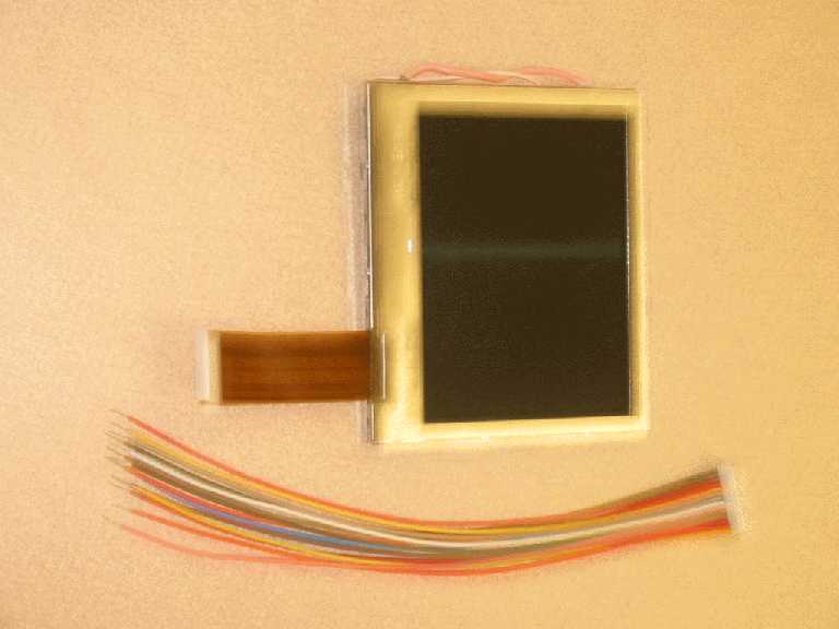

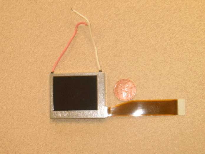

I finally managed to get a hold of a digital camera, took a few pictures of the components I received from Data International. The first picture is the 1.8" LCD:

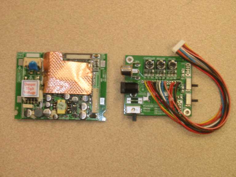

The second picture is of the driver boards I received. The one on the left has a sticker saying 3.5" NTSC on the back, so it's definitely for the 3.5" display. The reason why I think they didn't send me a driver board for the 1.8" display is that all the driver boards came packaged with the 3.5" display, and I didn't get anything else with the 1.8" display.
shark-they should give you the other board to. Contact them Tell them they didnt send you all the boards. Dont seetle for that!
But They might be intruseable-hard to say offhand. you can chek by seeing if the connectors are teh same width from both lcds. see if they both fit exactly and not loose in that slot on the top right ofthe left board. if they both fit in their exactly they are probly the same.
and do both of the multicolored connectors fit exactktly in that spot on the bottom rigth of that same board?
I would still call those people thera and get a techy to talk with you about your questions. And get the other board to from them. they probly forgot or soemthing

Sharkwong,
could you post a picture of the back side of the unipac 1.8"?
I havn't seen anyone confirming that you actually can strip it to allow light from the back to pass through.

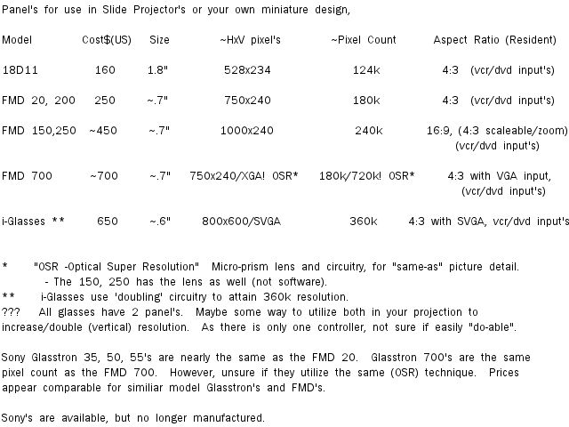

Currently available panel resources:
With the exception of the Unipac 18d11, open up these puppies and mount the panel in your projector.
Here is a link showing how the Glasstron's can be dissassembled. Pretty straight forward disassembly and the Cannon FMD's should be roughly the same.
Simple pics (no description) of disassembly of Glasstron's
It'll take a minute if you have a "dial-up", to get these pics in all these links.
Another, with a more detailed explanation of all the Glasstron's being hacked.
Web page with details on opening and utilizing the panels from several of Sony's VR glasses
And another...
Another showing the insides of the VR glasses. This one used in a foreign language converter.
These links would give anyone considering using these panels an idea of your plan of attack for using in a slide projector or your own mini-projector design...basically, unscrew the parts out and mount suitably in your projector.
Chart comparison of the lcd panels (1.8" and smaller) that can be purchased currently, full color, single panel 1/2 VGA to XGA:
And another...
