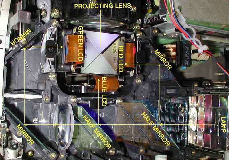

Typical LCD projector layout
I thought that this LCD projector (NEC) layout may help people understand how a commercial 3 LCD panel projector works. Note complicated optical path to get from the lamp and to the 3 panels, one for each color. The 3 existing images are added in the prism arrangement before it exits to be projected through the lens on the top.

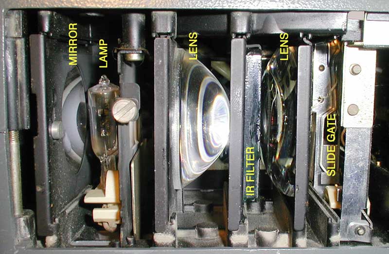

Typical Slide Projector Optics
This photo illustrates the optics of a typical slide projecor. Note a bare bulb, in front of the concave mirror, producing a pretty much pointed light source. The light passes through one colimating lens, before it goes through an IR filter (that strips most of the heat from the beam). The light then passes through another lens (making light beam parallel), before it goes through the slide gate. That is the area, where a small LCD panel would have to be placed. This projector is a S-AV model made by Kodak, Germany.
i applaud you eltroniX. that is some of the best info this forum has had in awhile! that gives us a little better idea that maye using lensesto direct and concentrate light is a good idea. it will definately help everyone out.
