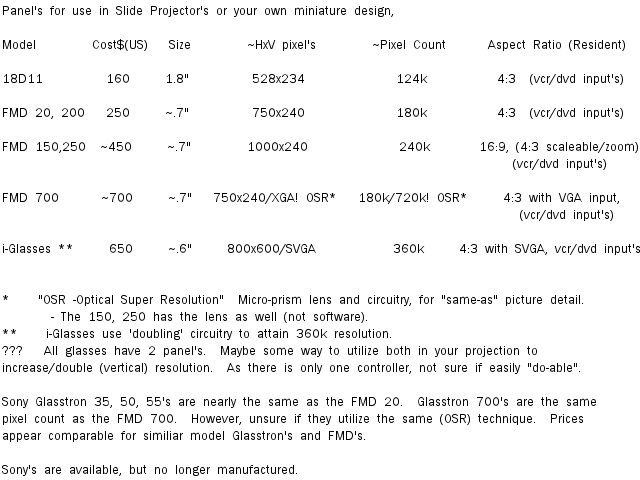

Small panel thread was just for any small panel
But, you're right about it fitting in a slide projector. And, for that it has to be 1.8" or smaller.
WE HAVE FOUND .7" SVGA one-panel's that can accept video, svhs/dvd and vga connection for 800x600 resident resolution.
We'd rip 'em from VR glasses. Controller's are included.
I didn't see any people that were having a prob finding boards without controller's, as all the one's I've seen mentioned in this thread are purchased with them.
#6) Well, you know it's money prob's. Not a conspiracy, ha-ha-ha!
Just have to wait. Maybe someone, including myself will wave the shiny card and get you guy's some proof.
Please continue reading our humble page's, they're caked with info that usually get's glossed over.😀

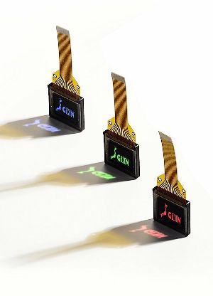

Just so there's no confusion...
Those panel's just linked would require three. They have color picture's shown on them. But that's for the birds, he-he. They are monochrome.
Wonder how much though. It say's further down they have low price stock. Maybe an email is in order...
Here they are R, G and B. Pretty cute
