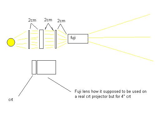

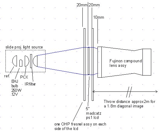

Sorry, I really didn't explain it very well.
The current problem is not that I don't get the whole LCD visible through the fujionon, that problem was fixed by putting 2 OHP fresnels before the LCD to converge the light strongly. Here is a diagram (should have used this before!) of the current setup:
The problem is that the image brightness and quality seems to be reduced using this setup probably because of the very sharp angle of light through the lcd. Ideally light should be parallel when passing through the lcd. So the setup I had in mind was:
Hi Muzzman,
Cool idea. With this arrangement, you could either follow Xblocker's advice, and find a replacement input lens for your Fujinon (The fresnel might itself be the one), or, you could put a diverging lens (PCV), with the same focal length as the fresnel, flush with the input to the Fujinon.
In this arrangement, the fresnel would have reduced the diameter of the output beam from the LCD to something the Fujinon could use. A diverging lens that balanced this would then straighten out the cone at the propriate diameter for the Fujinon, AND move the virtual image forward towards the Fujinon. (The fresnel would move the virtual image of the LCD away from the Fujinon.)
Bill.
