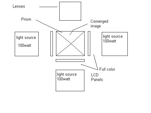

Someone here had one without the cover on and that was when I was thinking of it. Heres a realy quick crappy drawing of it. (oops, file size too big it says)I'm prob. way off. Like CRT, you mean have 3 or even two full color lcd's images merged and projected then. A prisem will do that just the same wont it-I mean just like in the 3 panel deals right?
I see what you mean about the panel still fltering out the light. So you'd need monochrome ones to gain the ANSI-lumens advantage. Makes sense. Alls you would gain then would be contrast right? So a similar to crt type deal would make sense aswell. It would be brighter as more light would get through seeing how it would be x3 the panels. Even a single light source would still yield nearly 3x the effect as it (LCD panel) only uses about 10% of light source. So it would be more like 30% effective use of the light source. That is if your talking about converging the image, then projecting it. Hmmm, it would be easier too.😀
CRT like-like this? LOL bad drawing I know but you get what I mean. Am I thinking right? This way instead of 1 300watt bulb with alot of heat on one panel. You could have 3 100watt bulbs less heat per panel and more light useage cause of the 10% per panel thing it would be using 300watts 30% on 3 panels (10% each) instead of 10% of 300watts on one panel! It would be ruffly 3x brighter at the same watts and cooler per panel so I can see how it would work. But will a prism pull that together? Or will it have to be a mirror trick? Watcha think?😕

Really tricky stuff aligning 3 LCD panels.
On a CRT projector there are mucho electronics that can size each tubes output so the image of all 3 lays on top of each other plus there are knobs for paralax adjustment, skew, barrel distortion, up, down, left, right, intensity etc all of which helps get 3 CRT images to register and look good. . You dont have all that flexibility or easy adjustment with 3 LCD's so guess it would be a lot harder to do.
The big guys do use a prism kind of thing to combine the 3 LCD images before sending it off to a projection lens. It is descibed a few pages back in this thread if you are interested.

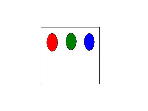

No I was thinking along the lines of how a normal crt projector works with three different tubes that you see can on the outside. R G B . Then align the panels so they converge together with no prisms at all.
Ohh I see! Yes, I know what you mean now-DUH, what was I thinking. Wouldnt that be really hard to align though aswell? Or is it alot more feasible that way? Heck you wouldnt even need three just two would still help alot.

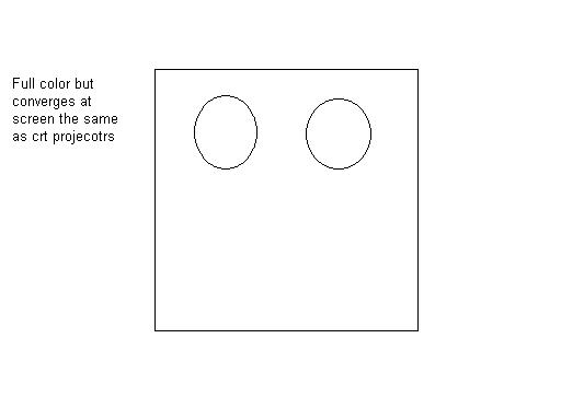

One like this (normal crt). I know my Paintshop skills are, well I have non that about explains it.😉

So how do you make the two converge at the screen without having them do the keystone efect or making the edge lightly out of focus. Is it more than just the mirror like digital or what? I have never gotten to see the inside of a real crt proection unit. To be honest I thought they just aligned the barrels (focusing tubes) to make them converge it and not a mirror. I guess I was wrong, do you have any links to where I can see how they do that? Thanks.🙂

CRT projectors have a lot of electronic controls for pic size, position and shape which allows relatively easy convergence of the 3 images into one on the screen.
LCD panels don't have those controls to the same extent so its much harder to do. Nobody does it that way. They make 3 images with 3 panels and combine the 3 images in a single picture before it leaves the projector box.
You could try converging 2 or 3 individual pictures on screen but keystoning would ruin the whole picture.
"You could try converging 2 or 3 individual pictures on screen but keystoning would ruin the whole picture."
Thats what I figured. that crt's used some kind of digital keystone correction, without you are lost.
"LCD panels don't have those controls to the same extent so its much harder to do. Nobody does it that way. They make 3 images with 3 panels and combine the 3 images in a single picture before it leaves the projector box. "
Yes, I know. They use a G R B lcd then they converge with a prism. The prism outputs into the focus tube. But you couldnt do this with say 2 color panels though right you need 3 and monochrome, I mean use a prism. And if you could it would be expensive finding good res./contrast panels that are that small. A prism that would do a 5" image would be very expensive I imagine. That means like a 2" lcd or whatnot. So that only really leaves the monochrome lcd's. That means needing a driver board! Now if you can get a 5" prism and you can converge two or three full color image with a prism -then horay, but I dont think it works that way. Actually I guess you could use a negative lense to make the image smaller to pass it into the prism at need size. But will a prism converge 3 all color panels or does it only work with monochrome?
Tinker,
They use 3 monochrome panels. Polysilicon ones that pass more light than the colour ones we use for projection. Impossible to locate I understand.
