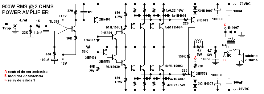

In post 85 if any emiter resistor draws too much current, the transistors 2n5401 or 2n5551 turn on, sending a signal out A that too much current is flowing. The diodes summing the current of the 4 emiter resistors is a good trick. Makes an "or" circuit of the 2n5401 and 5551. Some circuitry is missing between A the overcurrent detection output, and C the disconnect relay driver. Probably there is also a power on silence circuit to hold the output relay out, as well as a possible heat sink overheat detector to trip on fan failure.

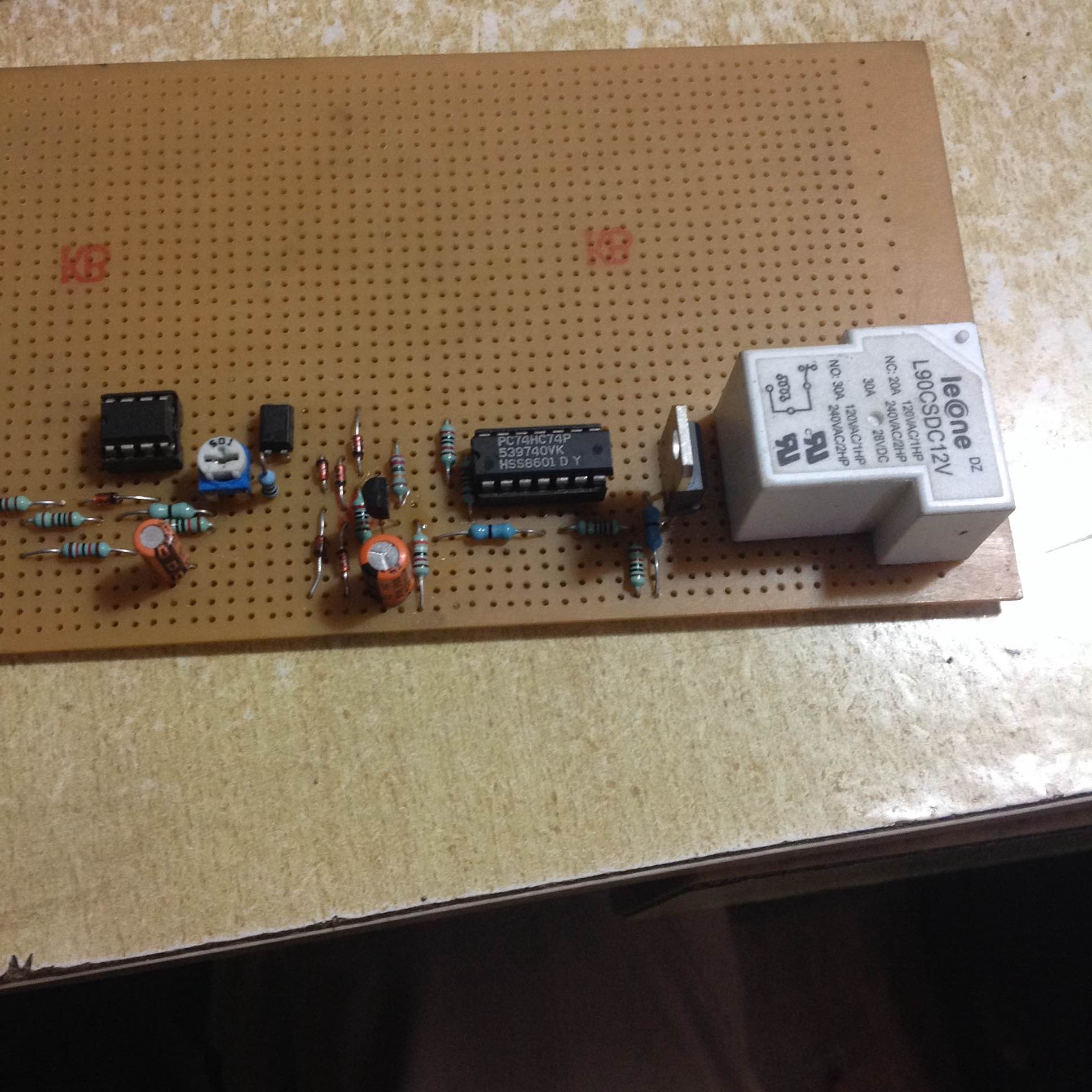

I just so far have the built DC detector from the PV-1.3k triac crowbar tripping the fault latch (a 74hc74 IC in my board) I'd been monkeying with opto isolators reading the voltage across the fdp52n20 to detect overcurrent, then setting the fault latch. A third input could be the thermal switch on the heat sink of the PV1.3k to detect fan failure.
The nice thing about summing the 8 emiter resistor overcurrents the way this circuit post 85 is shown, the overcurrent signal is already ground referenced. Reading the rail fets, i have to use an optoisolator to bring the two overcurrent signals from both rails back to a single point (the speaker ground) Unfortunatley the PV-1.3k speaker ground flies around with the music, so I'm still probably going to use optoisolators, and a separate "logic" ground for the fault circuit close to the case and safety ground voltages.
The one thing I see wrong with the overcurrent detect in post 85, one intantaneous overcurrent will trip the transistors. I'd put in a capacitor on the base of the 2n5551 and 5401 to slow things down a little bit where it took 2 or three overcurrent cycles before the overcurrent fault went off.

I'm sending the "DC voltage present on speaker" signal through optoisolators (since the ground flies around with the rail voltages on Peavey equipment) to a 74HC74 latch, powered by a separate wall transformer (installed in the amp case). That way the fault cricuit goes on and stays on until power is turned off by the roadie (or me) . A transistor driven by the 7rHC74 drives a fault LED visible through the front vent slits, The green side of the LED drives the the FET driver IC's to turn on rail current.
Current sensor transformers on the outputs are cheap in bulk, Peavey uses them in the CS800s amp, but individually the distributors want >$10 for them.Those I don't know if the output is sensitive enough to produce .6 v for a transistor base. I don't like the Hall effect IC boards for current sensing, at $9 each + $9 freight (not sold by general distributors). On 22 amps expected speaker current , the pins or solder holes of the hall effect sensor board aren't big enough for 10 ga wire.
Optoisolators are about $.50 or less each, I've got about ten of them in my circuit for each channel. At normal 22 amps the fdp52n20 MOSFET in the supply rail between capacitor and output transistors will drop .88 v, so to set off an optoisolator at 1.2 v the circuit would be drawing 30 amps from the rail, pretty **** sensitive current detection IMHO. Your amp may need a lower current trip point with less than the 5 MJ15025 output transistors my PV.1.3k has.

Does post85 work?
I would put the relay in the collector as the load and connect emitter to power ground.
No I wouldn't.
I would add an extra transistor. This second transistor becomes the "switch" and must run saturated, i.e. Ib:Ic ~ 1:10
Then the existing transistor drives the base of the switcher.
No I wouldn't.

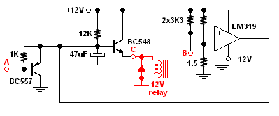

That top sch works.
But I would move Z1 to the other side of Q2, or change it to a grn LED, also between Q2 & Q3.
I don't understand the purpose of c3.
R5 is not required.
It just increases the leak in parallel to the timing capacitor. It's a very crude way of increasing the delay.
R5 is not required.

A triac is used because once it fires, it latches the SSR OFF. If it did not latch (as would be the case for example if a normal Opto wee used), it would cycle on and off
do you have schematic using triac to avoid the above problem or is latch circuit better
once overload occurs relay remains energised its very crude protection but will save amplifier

The latch off is good.
NX discusses this and of course Mooly's Thread on SSR.
But the latch drops out when the current drops below threshhold.
I use a 555 timer.
It pulls to OFF, when triggered and then restarts the timer delay before power comes back on.
If the fault is still detected, the timer ON after delay is overridden and the power does not come back on.
If the fault were cleared, then power would cycle in 5second periods.
I use a 555 timer.
