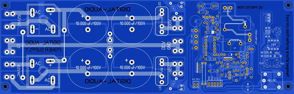

POWER SUPPLY PCB
Hello
greetings trying to make power supply pcb with all protections need SHORT
CIRCUIT protection can anyone help out pcb has clip signal dc protect and thermal cut off adjustable till 125 degrees any schematics of short circuit protection will be helpful for me to try out
warm regards
andrew😉

90V rails .... you think a chinese relay will work here ? 🙄
Dang , just disconnect the rails entirely upon a fault condition.
2 big MOSFETS on the PS board - just as good as"pulling the plug".
OS
I use this http://www.diyaudio.com/forums/powe...ply-cap-multiplier-electronic-protection.html for my amp and it is serving me for years, ones saved my speaker.
