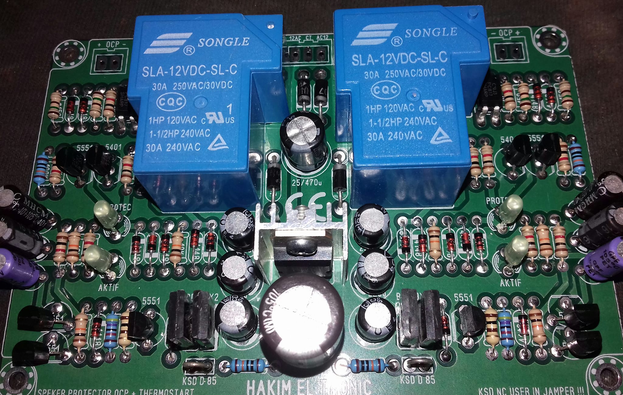

Hi Terry,
for the OCP, it has you sensing the voltage across the top side emitter resistor, so sensitivity depends on the emitter R size.
they should have used 2 more resistors, allowing you to form an attenuator, (R across the 2u2) so you can change the sensitivity, but you can add that if needed.
Good luck
Good luck

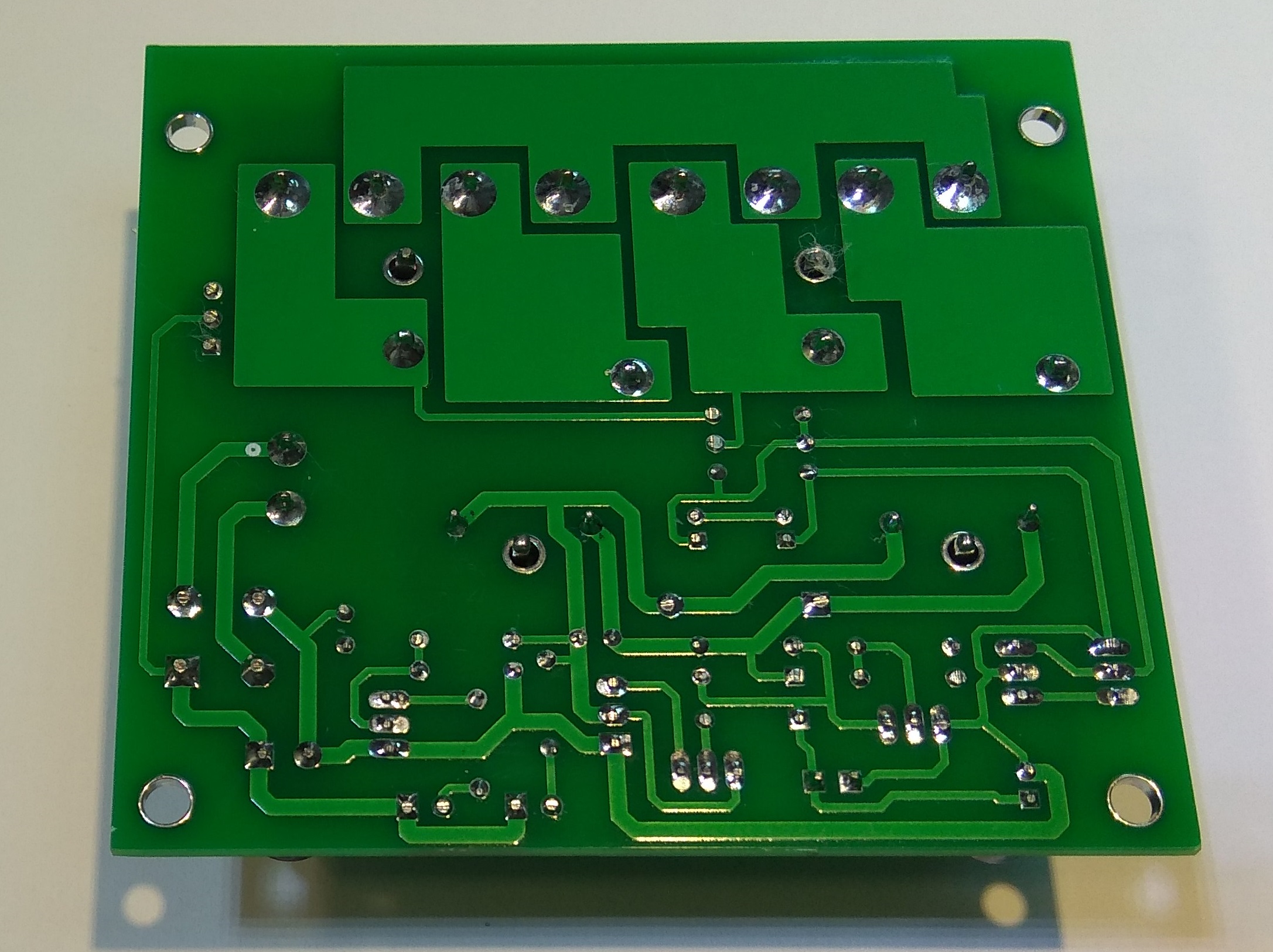

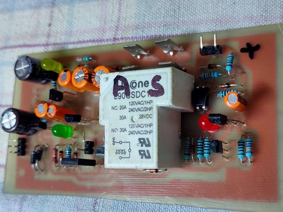

Over current and dc protection

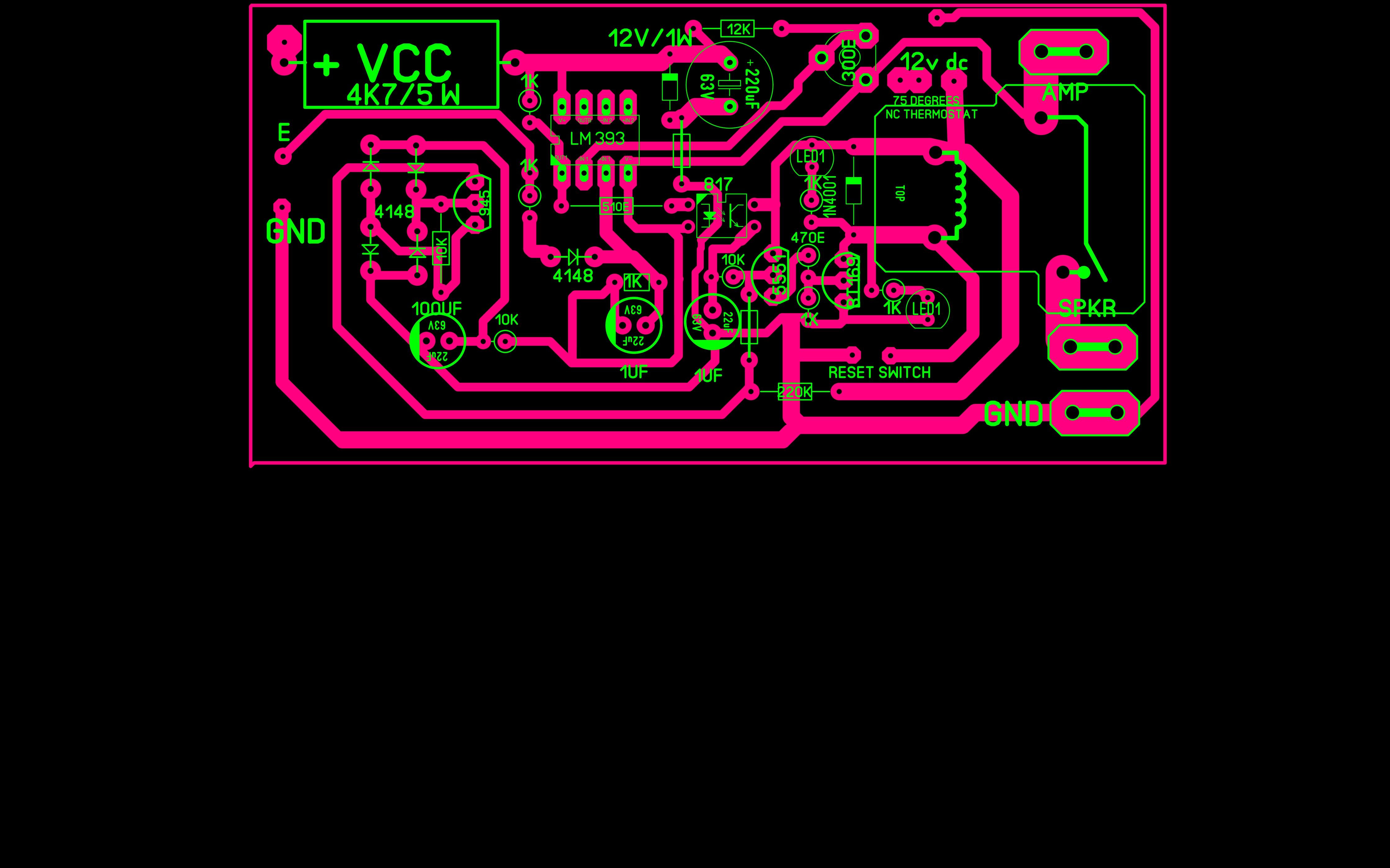

Ho andrewlebon, can you share this pcb?
Hello Thimios
greetings just give me few days for proper pcb design.
warm regards
Andrew😉😉😉;
Ok thanks!
