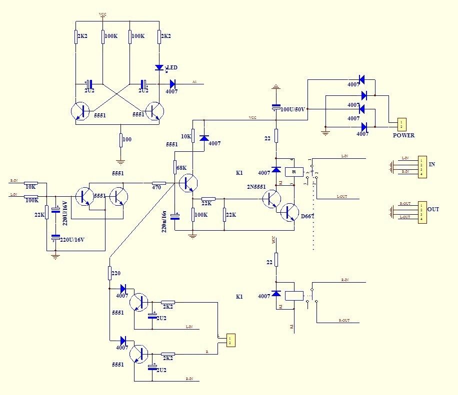

I'm really glad you guys brought this subject up. I recently bought a speaker protection circuit from ebay...
Check the input resistors for different values, please. 10 kOhm and 100 kOhm must be an error.
I checked. They are both 10K.
I am not sure if this discussion was ever resolved back in 2014, but I think I have figured out why the two resistor values are different:
If one of the two channels goes to either supply line, it does not really matter if the resistor is 10k or 100K, the protection circuit would surely trig.
However, if one channel goes to the positive rail and the other goes to the negative rail, (could happen if the amplifier is used in bridged mode) then if both resistors are equal the sensed error voltage might be very close to 0V, and the protection circuit might not trig. At 100k + 10K the offset voltage would still be huge, and the protection would definitely trig.
Ofcourse one could conjure up a situation where one channel would have say 4v offset, and the other -40V ( in case of a +/-40V supply), but that situation is highly unlikely to happen, and definitely more unlikely than +40V and -40V.
The optimal protection circuit will ofcourse have separate DC-sensors for each channel, but this trick will save you two transistors, two resistors and two caps.
Tell me what you think 😀

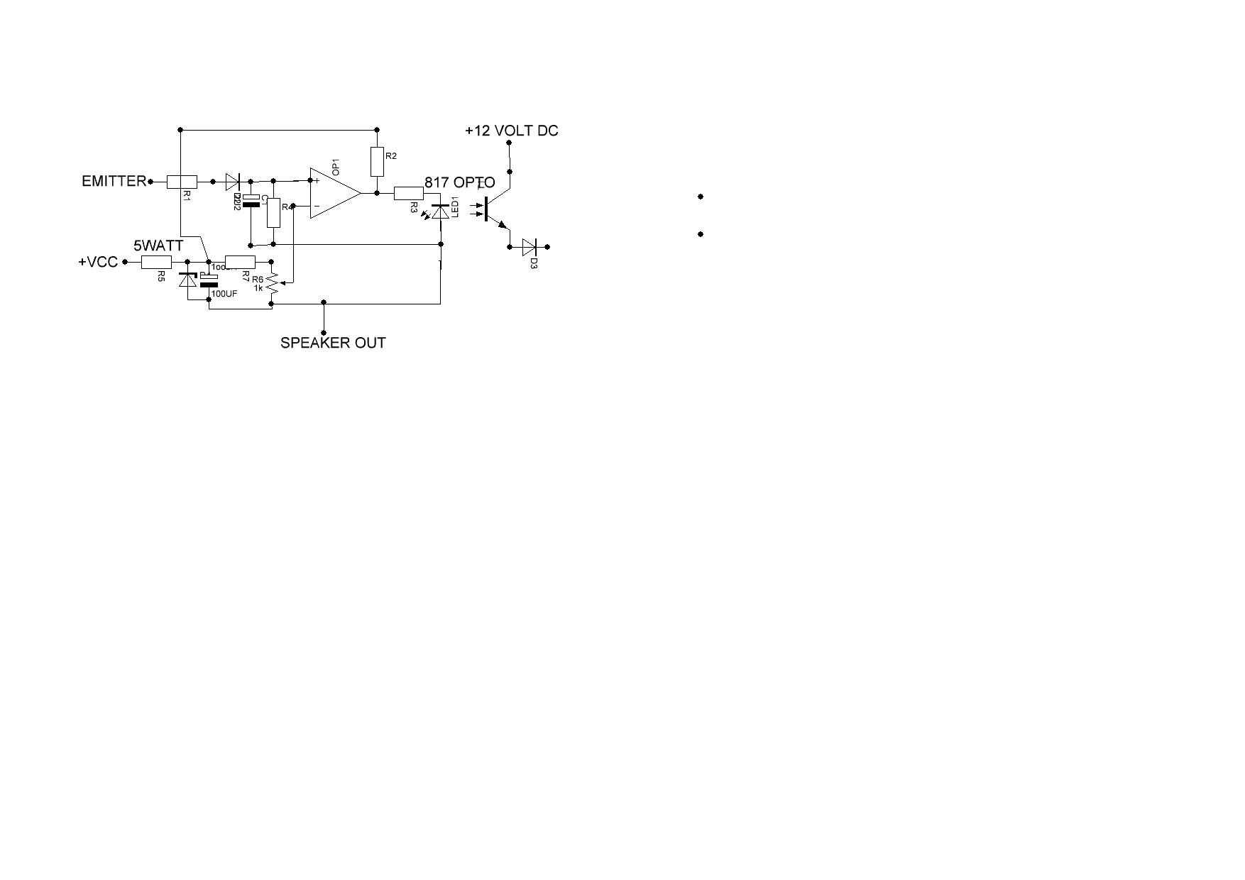

just an idea for overload protection😉
something wrong in circuit...????
with zener diode no gnd used and speaker ac voltage cannot used with zener diode.
just suggestion
greetings
this short circuit working at low level volume with adjustable pre set

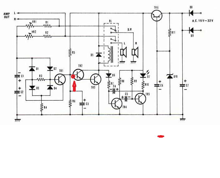

Hello greetings
is it possible to add a latch circuit after the red point marked on
schematic relay delay on with latch scr one all ideas are
welcome
warm regards\
Andrew😉
yes, and you can use a small signal scr in place of the sensor trannie TR1.
