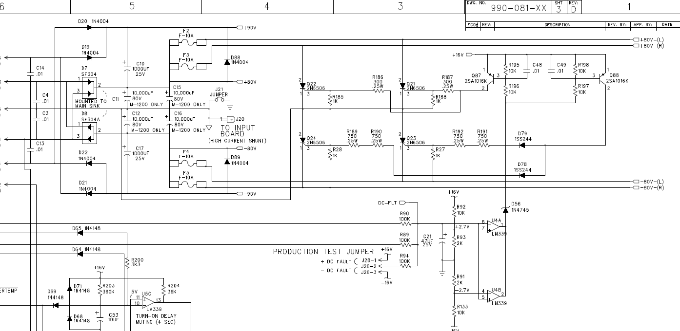

I think we have a misunderstanding. The crowbar is good protection against DC output, this protect the loudspeaker. But You need to protect the amplifier against the overload, not the speaker.
I/V limiter would be much better solution! Fast and reset itself if the overload ending.
Sajti
If you install the fuses from the PS feeding the rails and the crowbar after the fuses you will protecting also the amplifier.

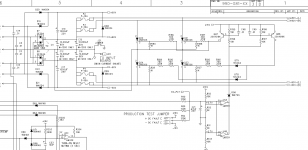

bgw750 was the first amp i saw using scr crowbars...https://www.hifiengine.com/manual_library/bgw/750.shtml
In the way they are doing it is possible to damage the output transistor by grounding it to ground. I think it should be doing it at the rails not at the output transistors.

I agree. One output transistor blew and caused DC on speaker. A crowbar triac from speaker hot to return can blow the other nine. I have an amp with a triac crowbar where the main breaker never blows, just the output devices blow one by one at $5 a pop until they are all gone. Then the current surge out the base line blows 114 other parts.Hi,
I'm installing rail disconnect nfets to stop DC when DC on speaker is detected. Flirting with idea of using the current across the rail nfets to cause the protection latch to trigger - the current across them when dangerous causes more than 0.7 v drop. Don't know how much integrator I need to prevent nuisance trips. 2 ohm load is valid for this amp, so that is 22 amps.

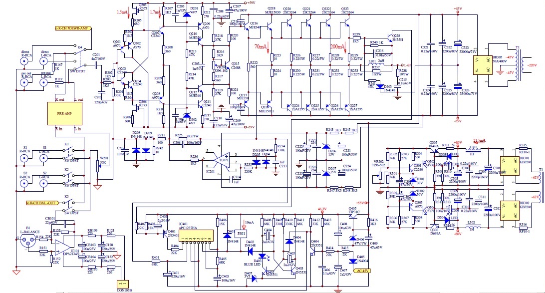

But on speaker protection circuitry [DC and on/off thump] are there any ideas why pin 1 of the uPC1237 doesn't seem to be used in any of the kit or built boards available out of Asia?
Simple enough circuit but needs to be tuned for specific amps for that trip threshold I suppose.
All the boards I find on .au site [includes International listings, admittedly filtered to only venders who ship OS] of that type seem to omit the subject O/L input now. 😕

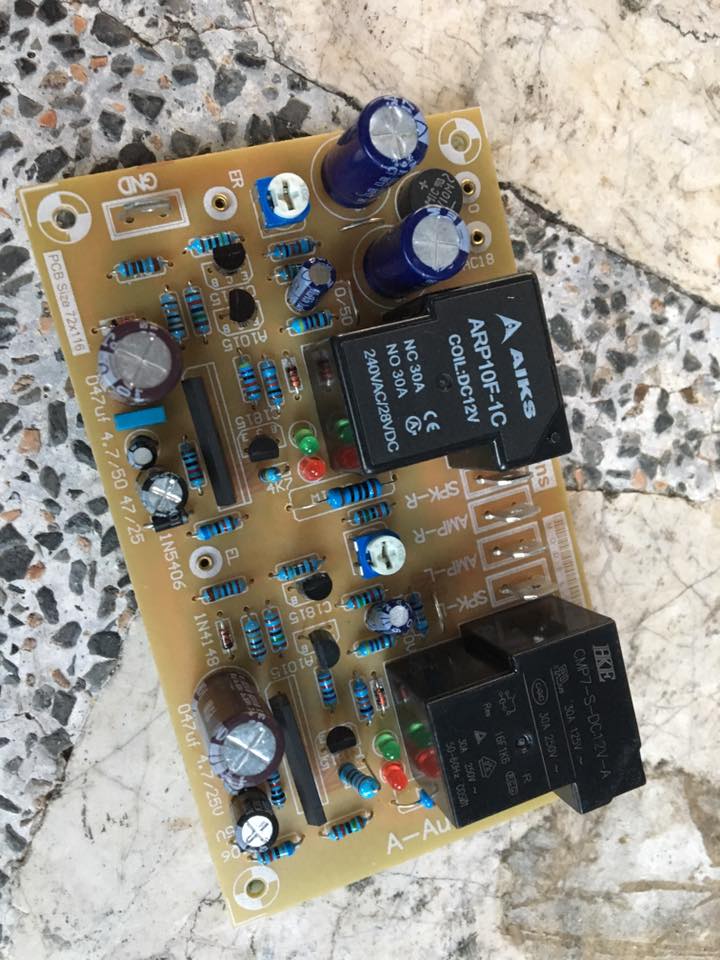

If you go to ebay and search for "30A Speaker protection board DIY Kit including 7812" you will find it. There are a few folks selling it. The one I bought is item #221255947264.
Thanks Terry
OK, without circuit for O/L signal from emitter resistor node thats looking similar to what I have drafted up. Pretty simple device to connect.
However, my use is for mono [subwoofer amp] and I'll use 2 relays to double break speaker circuit.
