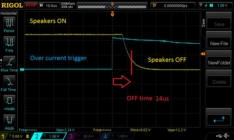

I have made recently a short circuit protection that works perfect and is very simple. Can disconnect the speakers in 14us. I just have to made some fine tuning to finish it up. The whole PSU is 10cm x 11.5cm. Protection circuit total current consumption is approx 5mA only.
The movie is bellow (I do not know how to tag it in the post).
https://www.youtube.com/watch?v=R4u4BiysseA&feature=youtu.be
For now sorry for the language ( I will prepare a new movie in English in next few days).
The yellow trace is output voltage and the blue is current.

Is this based on some form of Solid State relay?I have made recently a short circuit protection that works perfect and is very simple. Can disconnect the speakers in 14us. I just have to made some fine tuning to finish it up. The whole PSU is 10cm x 11.5cm. Protection circuit total current consumption is approx 5mA only.

Yes I am using a mosfet switches plus shmidt trigger to speed it up. The histeresis is used for temperature protection. Speakers are disconnected at 90C and connected back at 60C. Have to make some final adjustment only.

Because to be effective as protection, a wire fuse must be rated very close to the maximum power rating and at that point, it will be heating and cooling rapidly, distorting the output. See "fuse distortion" https://books.google.com.au/books?i...6AEIUDAL#v=onepage&q=fuse distortion"&f=falseWhy not ?
'Seems mosfet, you couldn't resist coming back for more.
I don't even use mechanical relay to avoid the mechanical contact. I use 3 pairs of MOSFET to get the on resistance down below 3mohm. But that's a different topic for another day.
