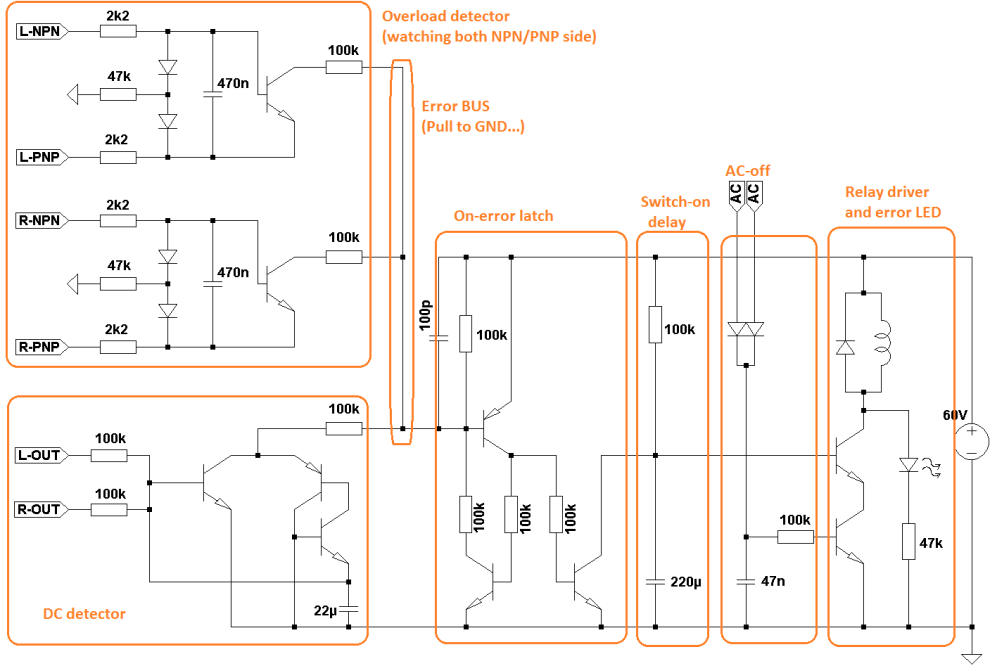

An RC filter is a very crude version of DC vs transient pulse discriminator.
It can be made to work adequately well. You will find it in MANY circuits, Crimson & Cyrus use them in protection circuits that are required to pass high transients but able to detect lower DC currents. The output offset detector uses an RC filter. It allows BIG AC pulses to pass and yet detects much lower DC currents.
That would be where the pulse tester would come to your aid. To "see" how the detector protects.

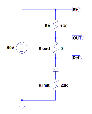

In the meantime I created a pre-test setup simulating the output stage.
Voltage source: amplifier with sinus on the output
Re: NPN emitter resistor (value = 10x in this setup)
Rload: the load (value can be from 0 and should be 10x as well maintainang the voltage divider)
Ref: this is the absolute reference point for the R-D elementin the overload detection cicuit
Diode: for simulating the NPN side
Rlimit: limits the current so the short-cicuit can be simulated as well
I tried it with 100Hz/1kHz sinus and it worked perfectly.

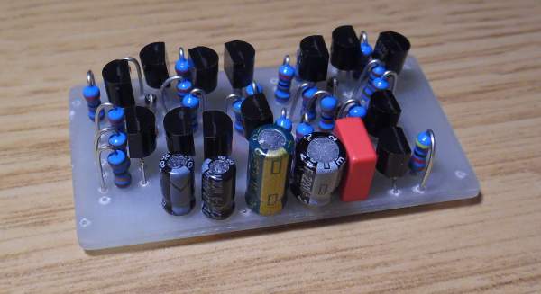

Maybe a bit closer to a real life environment... 😉

Hello Cortez
greetings what happens when an overload occurs does the relay go on and off
warm regards
Andrew
warm regards
Andrew
The switch-on delay (~1s) will be applied in this case as well before going ON again.
With very heavy overload maybe, but with light overload, the relay will turn off, and on almost immediately.
Sajti
I think it is only possible when the load current varies exactly near the switch off current for seconds.
Yeah, I tested it and with a constant sinus around the switching level and the relay turns on/off almost immediately.

Hello Cortez
greetings tried your DC detector didnt work on my latch circuit
warm regards
Andrew
warm regards
Andrew
How did you connect it with your latch?
This one pulls its output (after the 100k) to GND.
Maybe your latch is positive triggered, isn't it?

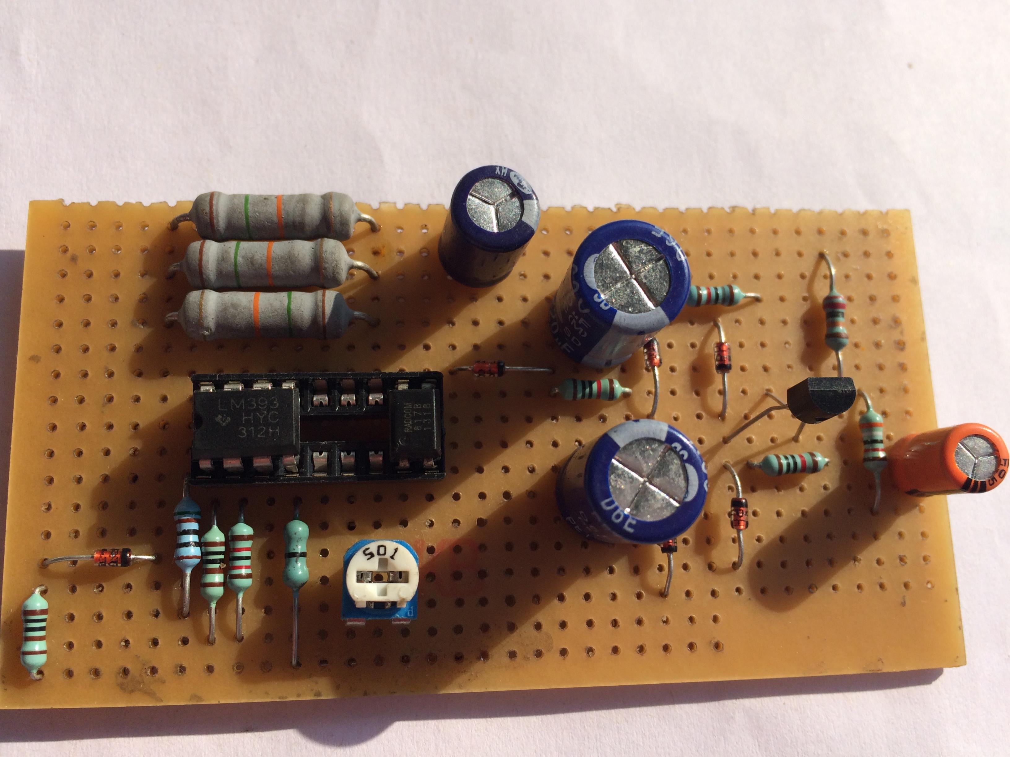

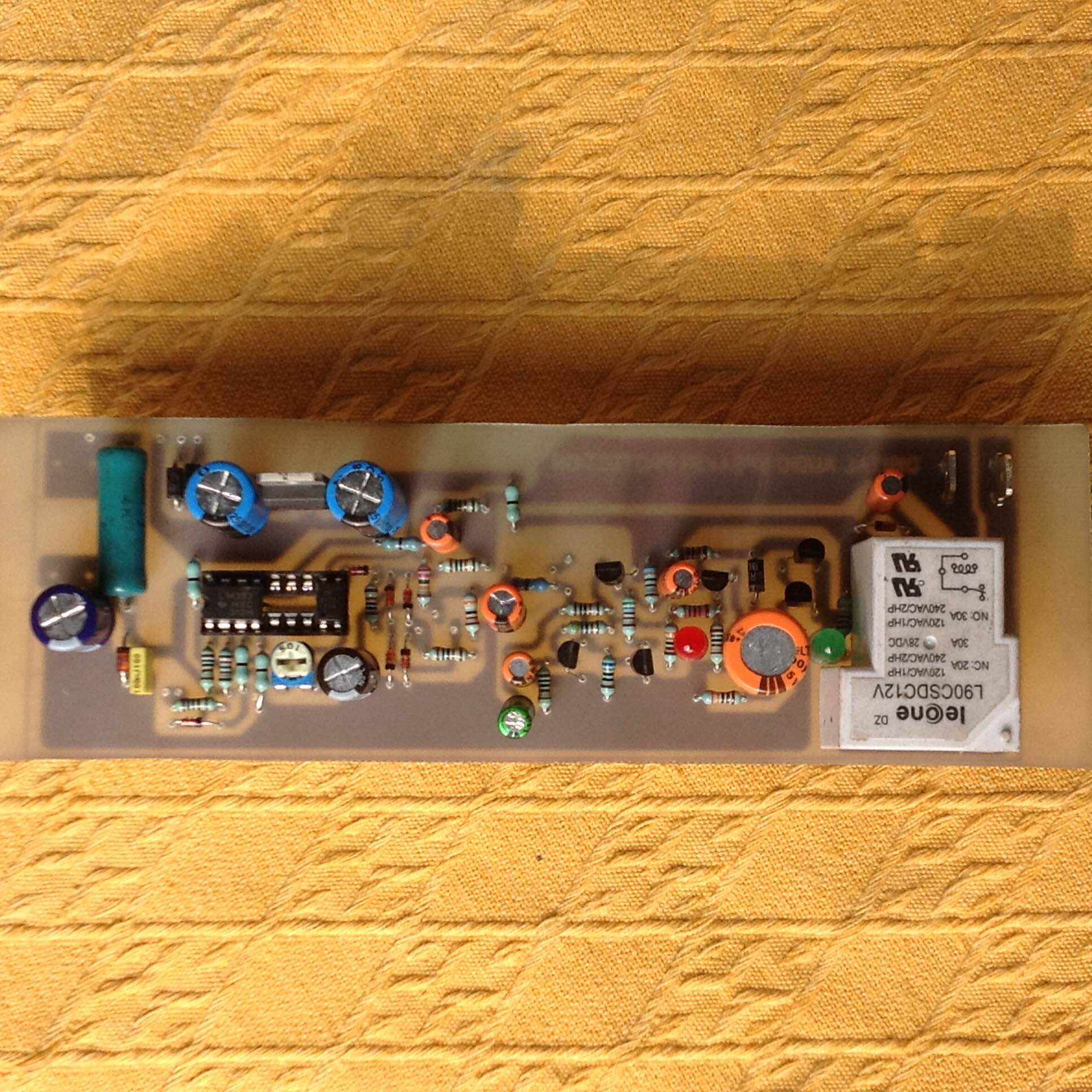

Hello Cortez
greetings its ok solved my short circuit protection its working 100%
i will try to design a pcb for it and post a working vedio of protection
in action it took a long time but i learnt some new ways to safeguard amps
time permitting will add a solid state relay as mechanical relays contacts
degrade in time
