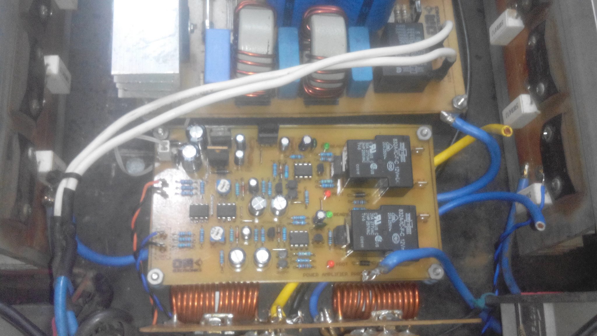

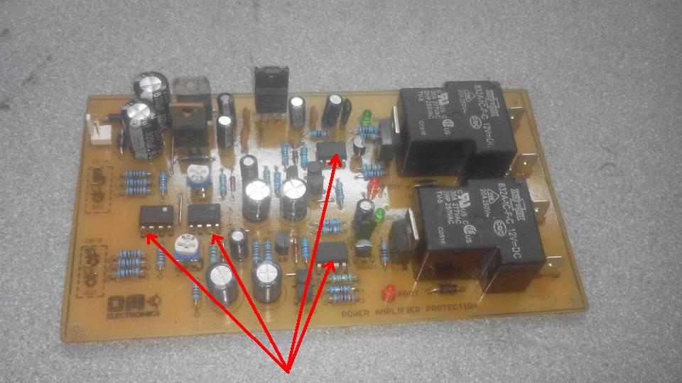

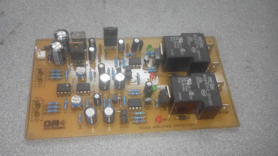

I ask again for schematic and pcb....Finished protection system amplifiers, has Power On Delay, Protection and Protection DC short circuit in the output OCP.

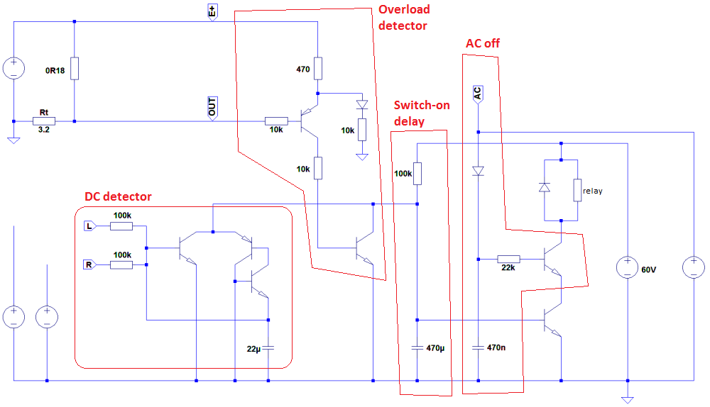

Hi, Z1 avoid immediate activation of the relay, an LED could also function as limiting, but I have not experienced.That top sch works.
But I would move Z1 to the other side of Q2, or change it to a grn LED, also between Q2 & Q3.
I don't understand the purpose of c3.
R5 is not required.
It just increases the leak in parallel to the timing capacitor. It's a very crude way of increasing the delay.
The C3 is to ease the burden of the relay (optional).
The R5 avoids mis-tripping (optional).
To increase the timing, rather modify the R2 instead of the capacitor ...
Cheers...

The overload detection is still under development but the other parts are pretty much the conventional solutions.
The signal source on the left top is just for simulating the amplifier output stage
with the PS + emitter resistor (0R18) + the load as a resistor (3.2 in this case).
If anyone has advices to the overload detection please do not hesitate to share your thoughts! 🙂

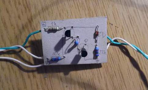

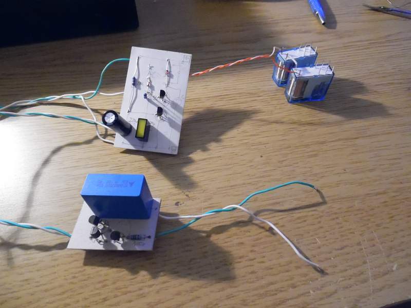

Hi!
I built it on paper "PCB"... 🙂
All the features are working great and I just started to test the overload section deeper.
The first test setup was a properly scaled voltage devider (1k8 instead of 0R18 emitter resistor and 10k instead of 1R dummy load etc...).
I only drive this with a DC supply yet just to check the current levels where the protection is activeted.
Its clear that the R-D member in the overload detector works as well, check out the "simulated" results:
That looks great so far nevertheless I dare not to test it on my hardly built amplifier... 🙂
Does anybody have any idea how to test it in action but without risking the output stage..?!
