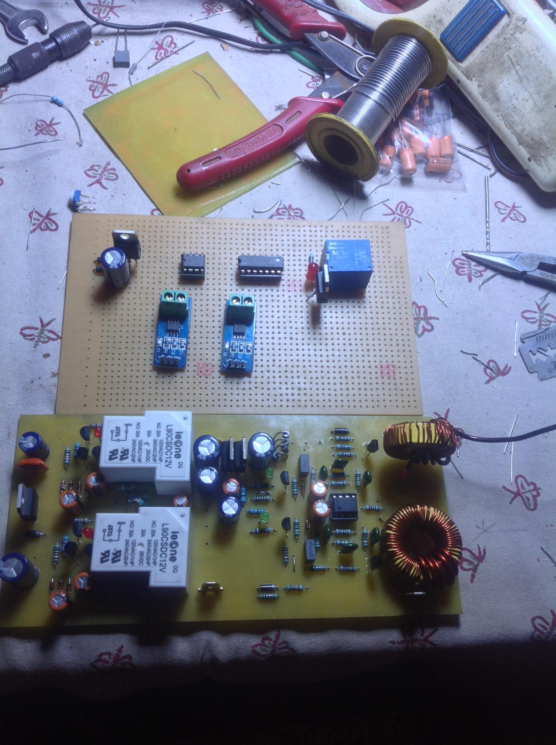

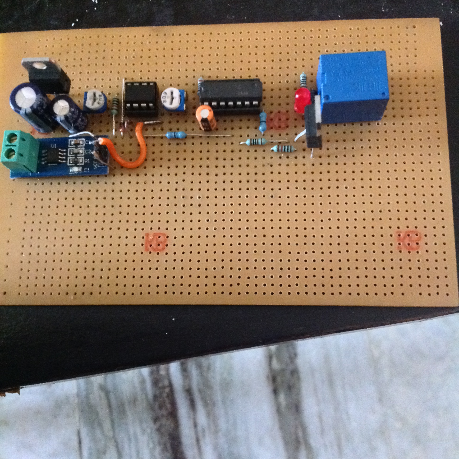

ACS712 SHORT CIRCUIT PROTECTION
just in testing process looks promising

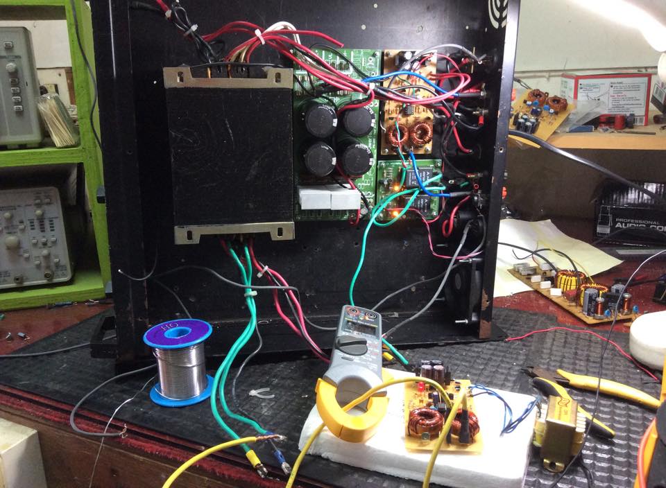

Shorting speaker wires protection working

Congratulation. I can not belief that a simple circuit worked out so good. I forget to mentioned you that can add the second channel to the output of the op amp since the comparators output are an open collector. That will make an OR gate. Any one of the two channel with enable the flip/flop.
