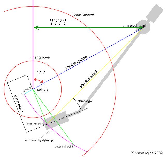

Can someone let me know what is the correct angle from spindle to the arm pivot? I think that is very important to get the correct protractor!
It must be some position, otherwise the arm pivot can move up or further from the spindle and I still get the right overhang measurement.
I think Frank gave me that info to probably I need some explanation.
I put question marks what is not clear. The rest look like OK to me.
Thank you very much!
Greetings Gabor

Good morning Gabor,
Just stick to the pivot to spindle distance figure given in my last posting. Then draw a circle (r=291,6mm) around your platter. Now you can place your arm pivot anywhere on that circle, as long as it doesn't interfere with the lid or other parts of the plinth and as long as it looks good to you.
The green line in the drawing is of no importance for the geometry of an arm and has no bearing on the correct choice of protractor. Imagine a prefectly circular turntable plinth and it becomes very clear that you can place your arm anywhere on said r= p to s circle.
A protractor based on Mr. Dennesen's design will give you the correct angle and overhang in one operation, an arc protractor like the one from Ken Willis may need a little more fiddling, but some feel they're getting more precise results. Try both and decide for yourself.

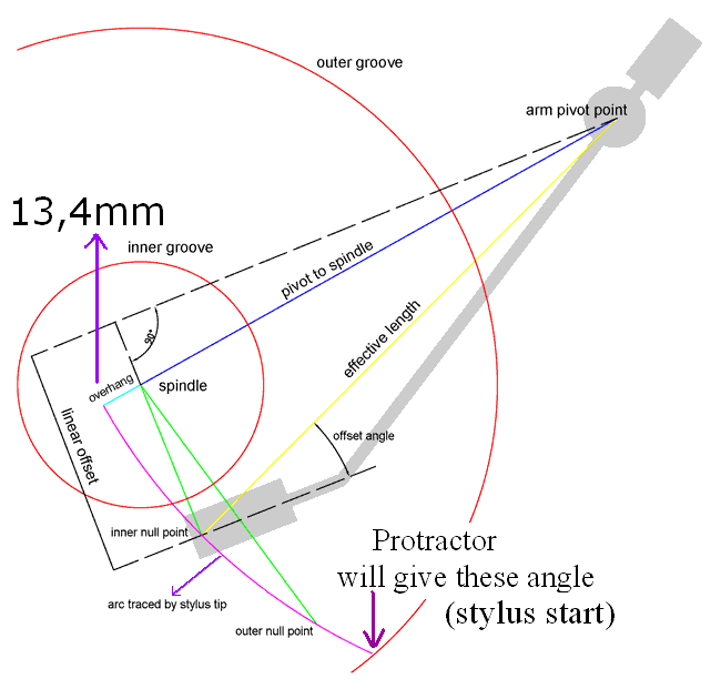

Hello Frank
If I understood right one of the most important to keep the given overhang and use a protractor to get the right angle on the record..
I did tested several (5 or 6) turntable from the outer groove to the inner groove angle and I get from all different angle. Interesting all has S shape 9" tonearm.
To me a bit confusing, supposed to be some rule or something.
I will register and download a protractor and with that I set up the arm (stylus start) angle from the outer groove to the inner groove after the protractor.
I do not have dust cover or any other parts to interfere with.
I will design the plinth after the two arm size.
How I stated earlier I'll use two arm on these deck one 15" and one 12".
One will be at the top another next to the platter like most regular TT has.
Can I use for the 15" the same measurement as for the 12" or I have to calculate that to. If case if have to be calculated I have to ask for help with that to. I ashamed to ask you since you help me more than ever I can thank you! Reason I use two arm because I purchased diferent material for arm wand and I pick the two best.
The protractor will give the angle for the stylus start and that will give the arm pivot to. That is correct?

You need to adjust your cartridge/cantilever for perfect tangency at the null points. Only when using an arc protractor, you are effectively "aligning the arm (angle?) from outer to inner groove", by trying to follow that arc precisely(valid for one eff. l. only!).
Just download such an arc protractor and try it on an existing deck. You'll figure it out...
Send the 15" ers exact eff. l. and I'll send the corresponding numbers again. Or go and download the Elison excel sheet, as suggested.

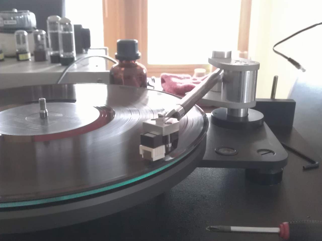

Finally got back to this arm - prompted by also playing with the opus cantus arm. I've only gotten as far as mounting it on a junker tt with an unknown mm cart. It plays although it looks a little "wobbly" or springy. I think playing with the gap might help that.
Next up is to wire it and mount it on the main tt with a proper cart.
Fran

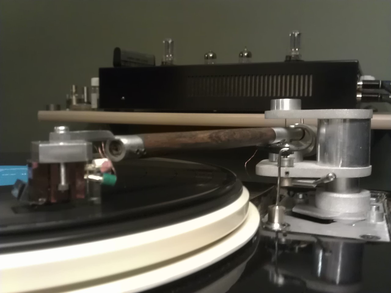

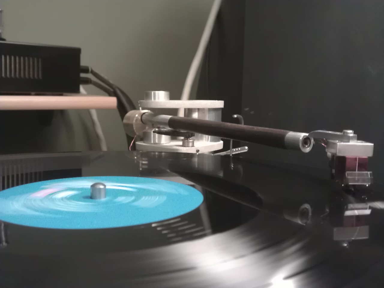

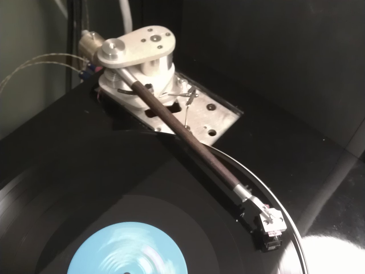

I did another few bits with the arm. The most significant thing was something I remembered frank saying a while back. I decoupled the counterweight. So it now sits on 3 o-rings very similar to how the original rega counterweight was done. The difference in this is not small.
I also made a rest so I can lock the arm when not in use. Makes it a lot safer when kids are about. Anyway I think it's time for a few pics!
I shot a short video that's up on YouTube:
http://youtu.be/U9nncN1E7M4
Fran
