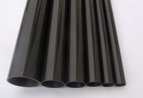

With the 3K type carbon fibre I can get the same weight or less like the arrow shaft or the titanium. But not with the graphite golf club shaft.
The 3K carbon on tube is 13mm but 0.5mm wall thickness. (after your advise I did pick)
Another I got 11mm but that 1mm wall thickness

Can you tel me what is the difference between the carbon and graphite please.
The golf club wand I pick is pure graphite not mixture with boron or other material.
Carbon fibre pipe I purchased on Ebay, that is nice and the weight right. One with 1mm wall other 0.5mm wall thickness
I think the carbon fiber use some other material at list the 2mm carbon fibre sheet I have is a mixture of glass fibre and woven carbon fibre.
They told me all solid carbon fibre sheet like 2mm or so is a mixture,
Pipes or smaller (thinner) material pure carbon???🙄
I'll see when it arrives.
I do not worried about the 3K carbon fibre tube I see some SME expensive arm use that material. Picture attached.
That is a very nice material, if pure carbon is OK. If mixture with glass I'm not sure..
That is the reason I tried already 4 golf club shaft because that pure graphite. $4/each used club..
All golf club wind heavy need to take off some weight to get around 20gr with a 15" long tube.
The biggest problem most of the times the hole not at the center, one side the tube thicker 1mm or so. When I drill into tho take out some weight the thin side crack.
I drill slowly and I use step by step thicker drill bit and still I end up with a cracked tube.😕

The difference is geographical. At least in the fly fishing rod world!
In Europe the tube is made from Carbon-fibre....
In the USA it is made from Graphite fibre.
They are exactly the same material, but beware it comes in many grades of fibre blanket and also of resin. These qualities certainly effect sound quality, but my own experience has been that This material has no advantages over most other more normally used materials other than being lighter than some.
I would not consider using it other than with a high compliance MM cartridge when low mass is essential in a PUA. If using lower compliance cartridges I would stick with woods as used by Frank in his production arms.
IF I was using CF tubing as an arm beam, I would go for as large an outside diameter thin wall tube as I could use...this will make for greater stiffness, but will also be far more brittle than - say - a golf club shaft. Ask your local fishing rod dealer if he has any broken rod sections....he will probably give you some as a present!

I got some carbon fibre tube (seller told me Japanese material)but still on the way to me.
It was shipped by surface mail from Asia.
One 13mm in diameter and 0.5mm wall. That is ultra light..I got one more because I have a nice Linn head shell it is 9mm that has 1mm wall thickness.
I will see if pure carbon not fibre glass mixture that will be good.
Fibre glass also crack easily, I do not think they use for aviation. These carbon fibre tubes were produced for aviation.
Greetings Gabor
