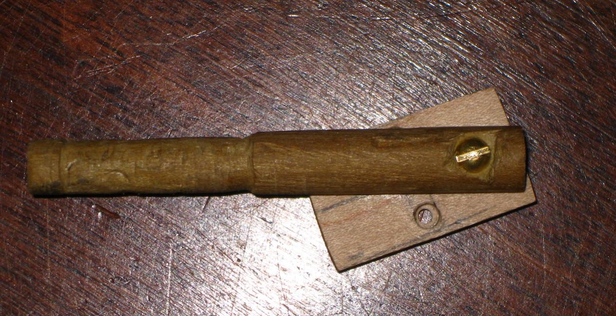

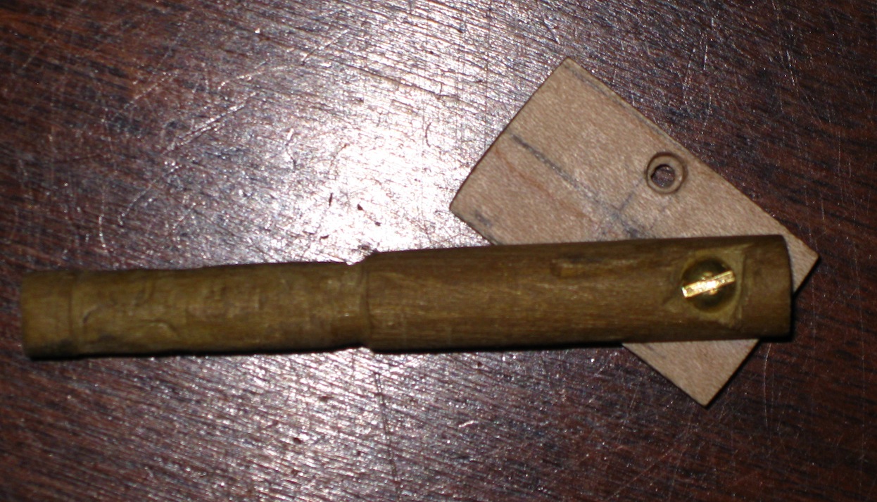

I'll take a photo of what I did in less than an hour using crude hand tools.

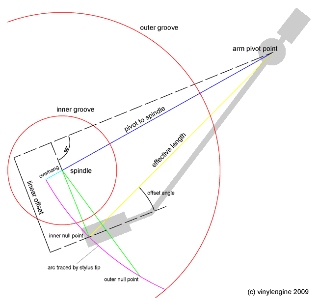

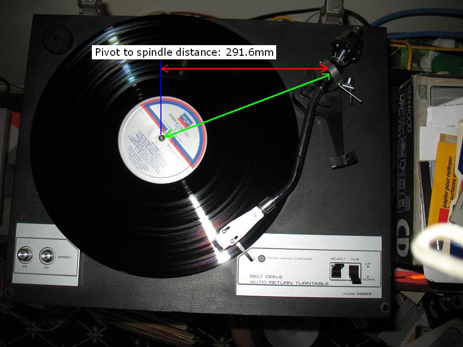

Hi Gabor,
If the effective length of your arm is exactly 12", the millimeter equivalent is 304,8mm. Lets round this off to the nearest millimeter. For an eff. l. of 305mm, the following figures can be derived for Baerwald alignment(0-points at 66 and 120,9mm):
Offset angle:17,84°
Pivot to spindle distance: 291.6mm
The overhang is (eff. l. minus p. to s. distance): 13,4mm
The resulting, tracing error related distorsions will remain below 0,5%
Make sure you get as close to these figures as you can. A deviation of only 0.3mm(!) or 0,3° is enough to put you in 9" arm territory(in terms of max. distorsion)
If in doubt, it's better to adjust the cartridge with a touch too much overhang or an ever so slightly smaller offset angle. Most people do not have tools that are precise enough or good enough an eyesight to tell the difference. But proper arm cartridge set up is another can of worms....
Good luck,
Frank

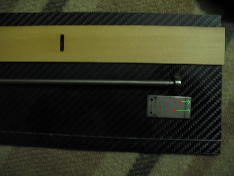

Hello Frank
Danke schön!🙂
First question to avoid the mistake - here the red or the green is the correct measurement?
Please let me know. If I can guess the red but I must found out the rest of the given measurement because the red alone not much.
I have to go to that site and study the angle- names etc.😀 Yes I have to do my home work.
Thank you very much!!!🙂
Greetings Gabor

Hello
OK I found several answer to my questions.
I will study until I get the right all clear to me. Right now any way I'm busy with the arm suspension.
Look like I will need some precise took for angle measurement.
One more time thank you very much Frank!🙂

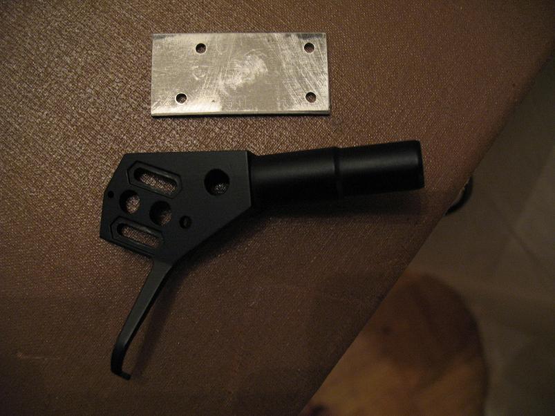

Hello Nannok

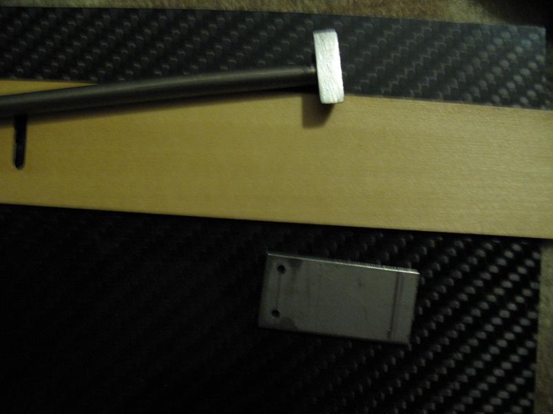

I'm happy because the Linn head shell investment it was not waste of money.
It cost me $30 with shipping. I just measured the angle with online tool and I can use her.
Also what I made from titanium that plate close to 18 degree angle. If I drill 3mm holes I can shift that much the cartridge.

Frank helped more than I can ever thank him!I work on the suspension , all hand work. Not even half ready but slowly will take (get in) shape. These material for two arm suspension.
Greetings Gabor
