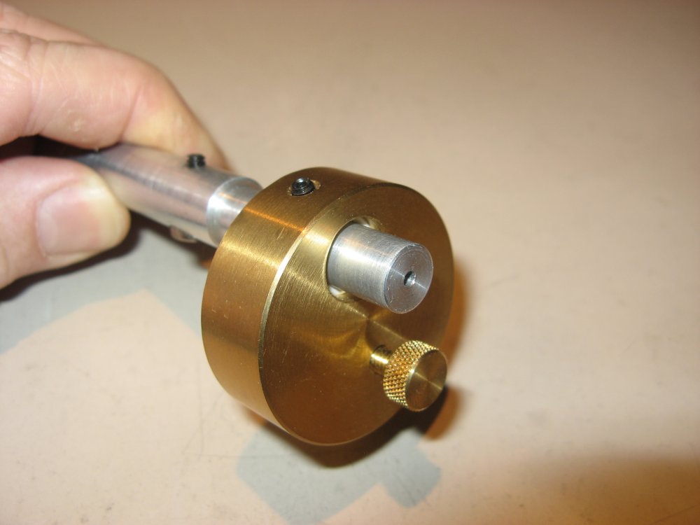

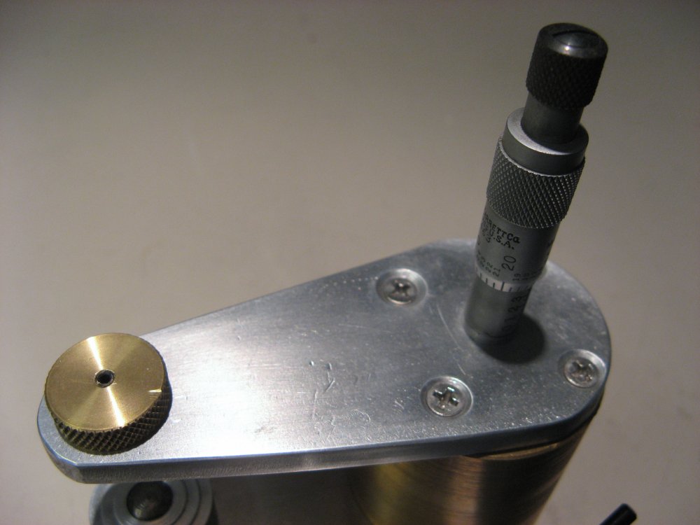

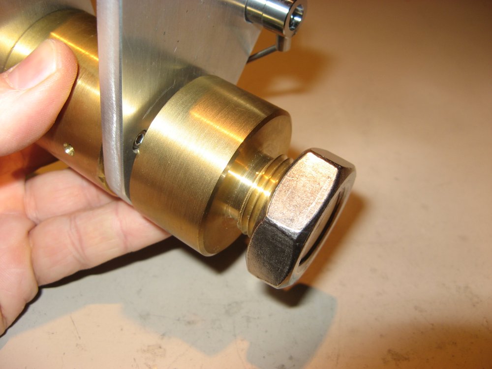

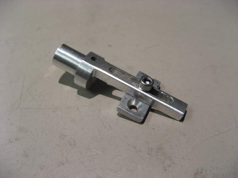

I did another few bits with the arm. The most significant thing was something I remembered frank saying a while back. I decoupled the counterweight. So it now sits on 3 o-rings very similar to how the original rega counterweight was done. The difference in this is not small.
I also made a rest so I can lock the arm when not in use. Makes it a lot safer when kids are about. Anyway I think it's time for a few pics!

Hi Fran,

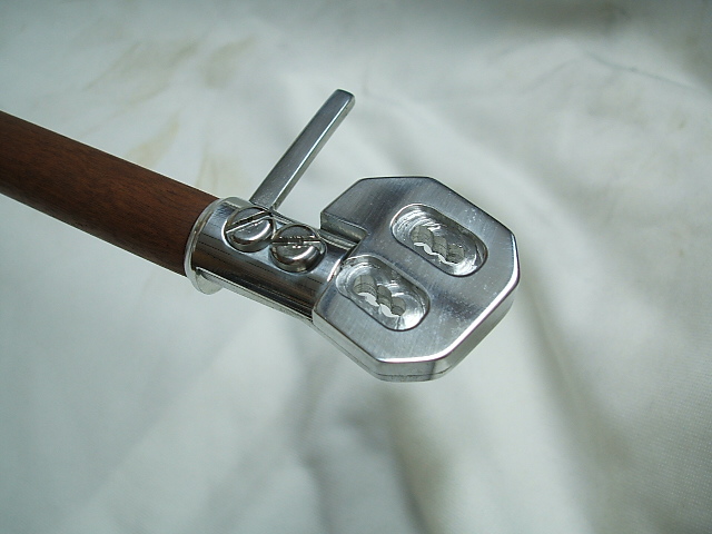

Why did you make the headshell/armwand interface so fragile and the mounting plate so massive?

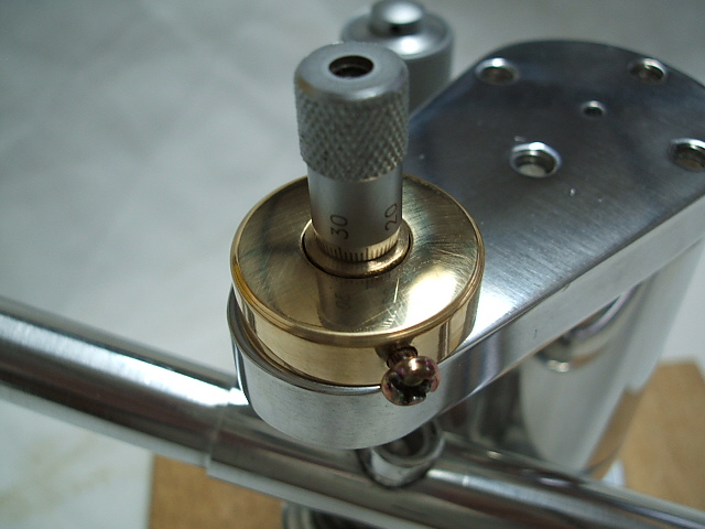

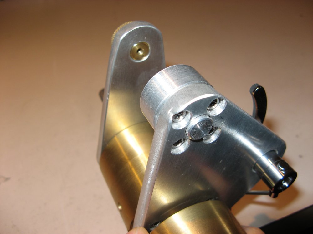

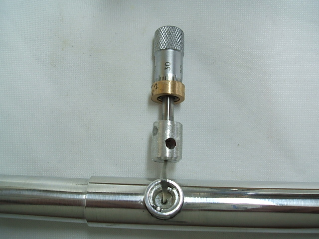

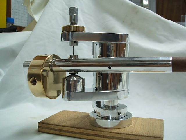

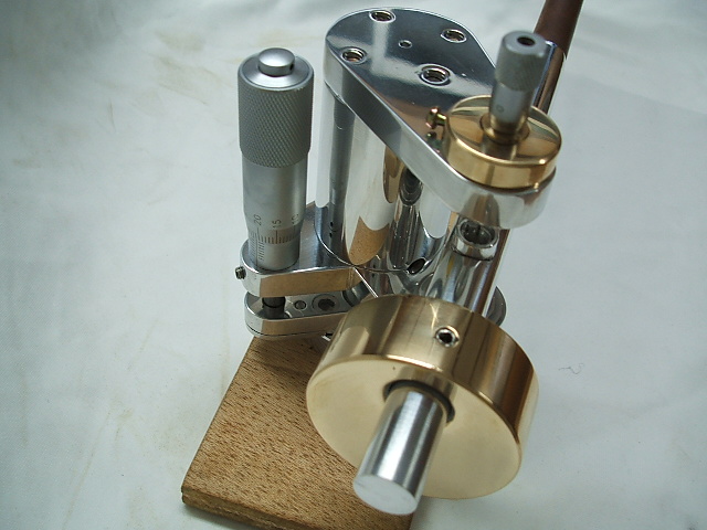

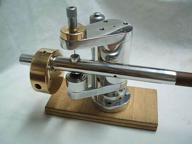

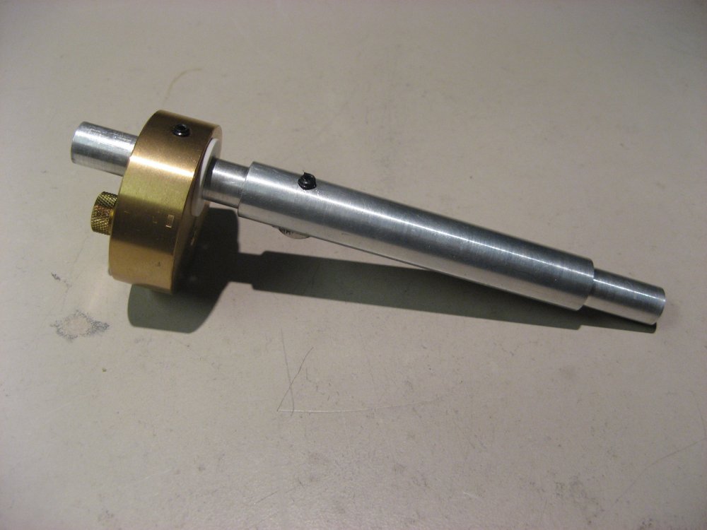

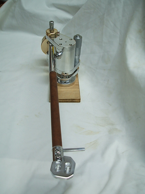

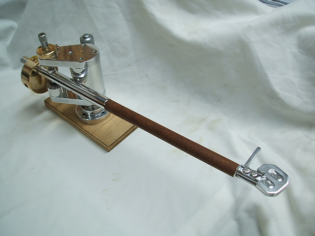

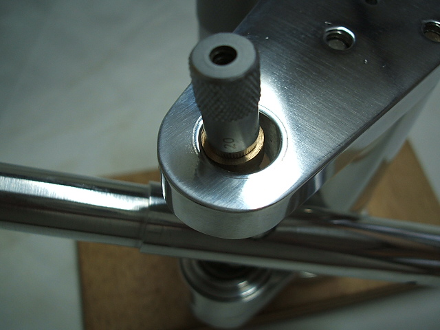

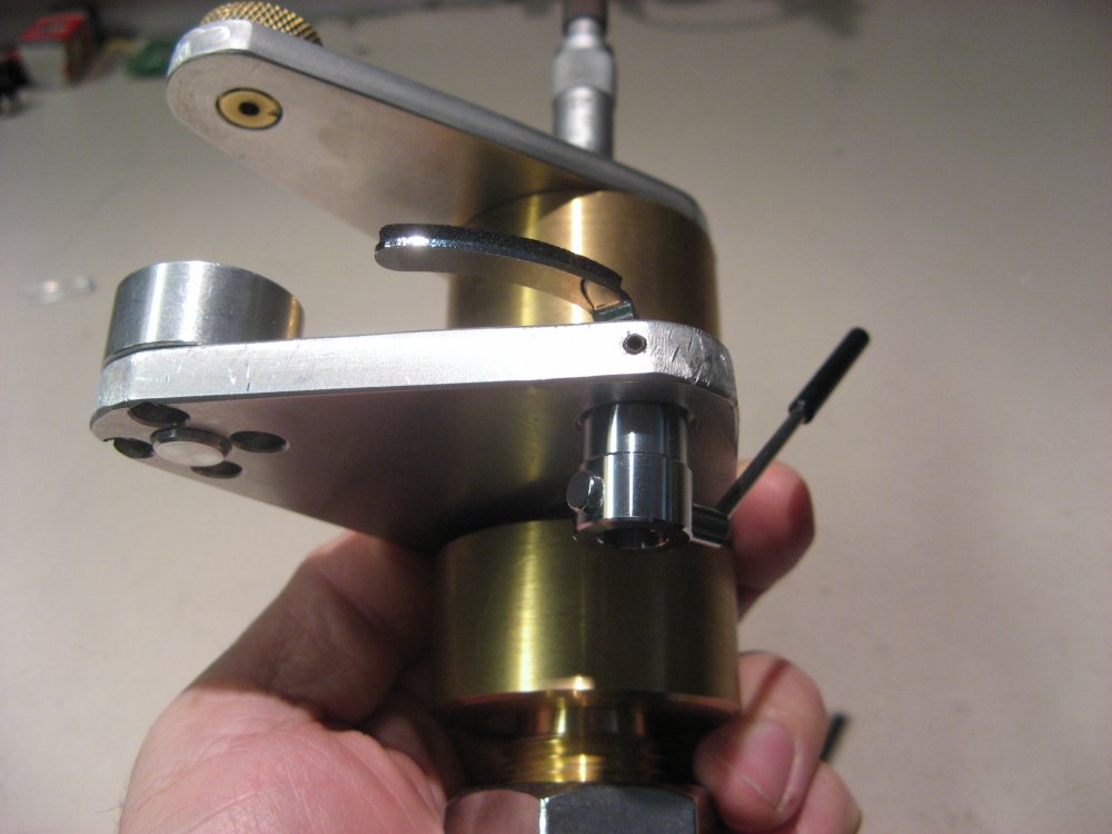

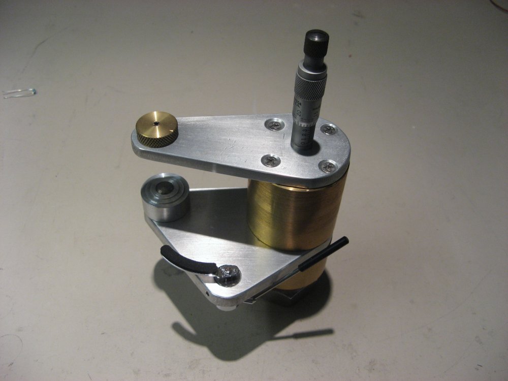

My Schroeder arm is almost completed. It missing only the wood wand tube. Here the pictures. It has a micrometric VTA adjuster kind like the one on the Graham tonearm. Counterweight with fine adjuster brass screw, plastic (Rulon material) sleeve insert between arm tube and counterweight for smoother adjustment and vibration control. I'll use a kevlar thread for the pivot point. The mounting hole is the same as a REGA, lifter (JL-45) from Jelco. It will need a custom slide section. The standard one is not long enough.
