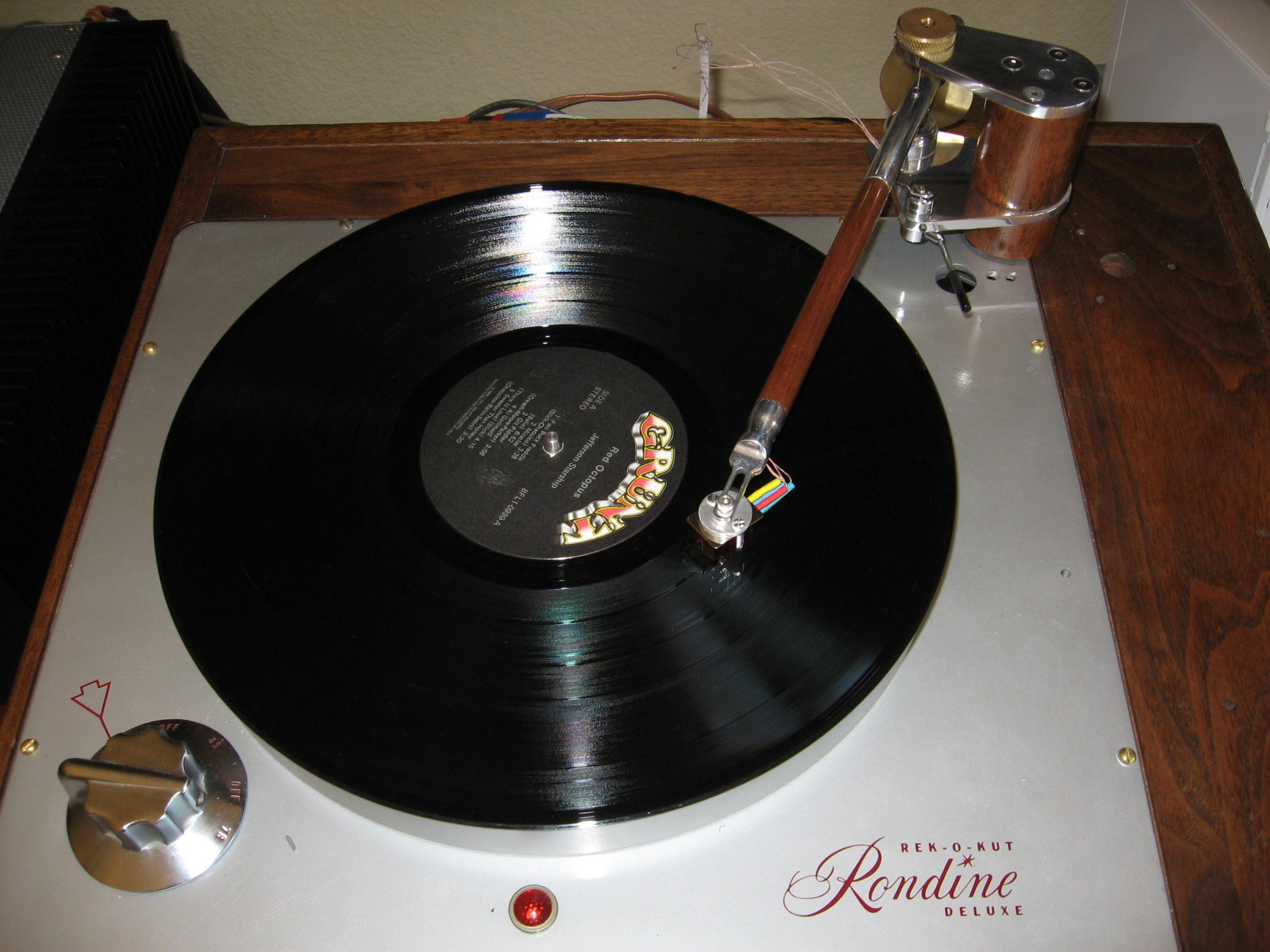

I've finished the majority of work on my version of the "clone" and have it temporarily mounted on a REK O KUT table.
The problem I'm having is when I set the weight of the tonearm it changes from the outside of the record (1.8g), to heaver near the spindle (3.5g).
I think I recall someone else having this trouble, but can't seem to find that post.
The only thing I can think of is that the lower magnet is somehow causing this? (Not perfectly aligned with the tonearm magnet?)
Any ideas and/help would be appreciated.
Also when I change the gap of the magnets I also need to change the counter weight location. Does this happen with everyone else?
Thanks,
Ron

Ron,
I cannot comment yet, my tonearm is not mounted yet. Try rotating the bottom magnet housing in small increments and see if you do get an improvement. Secondly, make the bottom magnet spherical, I would say 3-5 degrees. Hope you solve the problem! Happy listening!!! Ernst
Ernst,
Your build is exceptional, very beautiful, I'm jealous.
Rotate! Brilliant! I'll give it a try and post back how/if it worked!

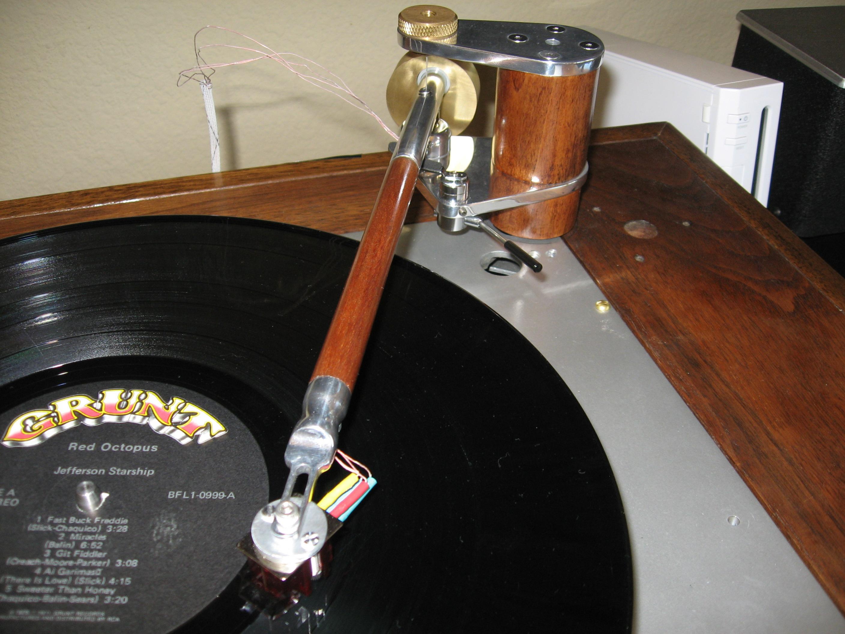

Thanks to Ernst, I was able to find and correct the tracking weight, or VTF problem I was having. The upper and lower magnets were not aligned vertically. The lower hole was off by about 2mm. I now get a only small differences on VTF from the outside to the inside of the LP.
Out of the frying pan and into the fire; I just can't seem to get the anti-skating to work at all. The tonearm tries to skate freely across the record when lowering the needle. I twist the knob and the string twists up which raises / lowers the tonearm distance to the bottom magnet and then tracking force is all screwed up again, which effects the anti-skating............
I'm so frustrated I could just toss it in the trash.
Frank you were right, it's not as easy as it looks. LOL
Sorry to ramble here. Has anyone else had this much difficulty ? Perhaps the tolerances just have to be closer than I can accomplish without proper tools. A Lathe comes to mind. Where's my hammer?????????

Ron,
Take a look at my post #801 Adjuster detail. I modified the design of the anti-skating wheel and magnet gap adjustment to permit magnet gap adjustment without changing the anti-skate twist setting. By implementing this adjuster you can set the anti-skate force to what you want and then set the magnet gap with a vertical only adjustment of gap. This worked out better for me than any other arrangement. Good luck.
BillG
LFM,
Thanks for the thoughts and help, yes the string is made up of many filaments, way to think outside the box. I'' replace the string with a new one just to be sure.
BillG,
Thanks for pointing me to #801, that would work very well. I think because my "string" is so short < 1 cm it effects the anti skate dramaticly when anything is adjusted.

Hi Ron,
I was out of town for a week, so excuse my late interference 🙂 . The diameter of the thread in conjunction with the inherent stiffness of the thread-material and -geometry chosen ought to render a skating compensation force that is sufficient for one gram of VTF for each full turn of the thread. Try something like a 0.3 -0.4mm diameter...
The magnet gap can easily adjusted independently of the skating force without having to resort to Bill's adjuster. Just "hold" the screw that the thread is attached to(like an Allen head grub screw) with the Allen key(with one hand), then turn the "antiskating disc" in which the screw is sitting(with the other hand). The screw will travel up or down, depending upon the turning direction, therefore raise or lower the armwand/magnet assembly, closing or widening the gap between the magnets.
Perfect perpendicularity of the thread/magnet/magnet alignment is a MUST, otherwise the VTF and/or the azimuth will vary across the record(said that many times 🙂
What makes this so difficult is that many easily(ebay) available magnets are not even close to "flat" or even round. Carefull when you grind them, NeFeB dust is toxic(lung, liver) once inside your body...
Frank

DUMKOPF am I for not realizing how simple independence of the two adjustments could be achieved. Make me wear a duncecap for a week or two Frank. I still like my adjuster. Bill.

Bgruhn,
You can have that "cap" when I'm done with it. LOL😛
Thanks Frank for your generous (as always) input and hard earned insight. I understood the mechanical functioning of the anti-skate wheel/knob, my problems were of my own making. (most of them are) The magnets were not aligned well and it went "south" from there. Just got worse and worse.
After staying away from "the project" for a few days and thinking about it. I'm sure that the shortness of my string is the main problem. I used the multi-filament that Mr. Davidson uses. Alas, I am not in his league when it comes to metal work. I used too much super glue and it ran down the entire string making it stiff as heck. I think I'll rebuild the pillars out of wood (I like that look) and need the extra string length.
Wish me luck. 🙂

Must be my month to post
May I present to my fellow admirers of Mr. Schroeder work, my humble version the the AWESOME tonearm! 😱
After almost ditching it in the trash, I went back to the beginning and started again. this time measuring everything with my digital calipers.
I am SOOOOO glad I didn't give up. The sound stage is so wide it's almost unbelievable! .................I heard bongos on a Jefferson Starship album I've never heard before. Extremely clean, crisp and analogue. 😀
I played "The Eagles Greatest Hits" for my 25 year old daughter and she said it sounded like it does when it's live music. She has never heard an LP before.
A Giant THANK YOU to Frank for all you help and patience with us.
Another great big thanks to all my friends on DiyAudio too.
Very Happy Man.....Wifee too!😉
Ron
