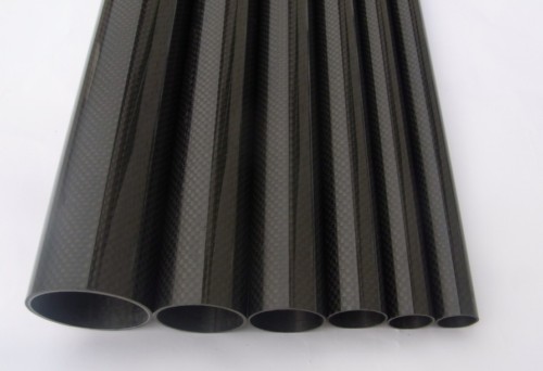

Recently i compared a thin walled alu tube to an even thinner walled carbon fibre (arrow) tube using the knife edge bearing from an old SME3012. Both tubes undamped and obviously with very different mass. Signet mm cart with sufficient compliance to benefit from a lighter arm mass. Result: carbon fibre tube sounded really awful compared to alu in any possible way. Not sure if it's the lack of damping. Of course the knife edge bearing places different requirements towards the tube material.
Thank you very much!
I'll plan to test these 3K type of carbon fibre. Very stiff and light weight.
Also I'll test graphite tube which from golf club shaft. I don't know the difference between the carbon or graphite material.
One think is sure many expensive tonearm built from carbon fibre. Many of SME still in production today.
Very valuable your info!
Thank one more time.
Greetings
Greetings

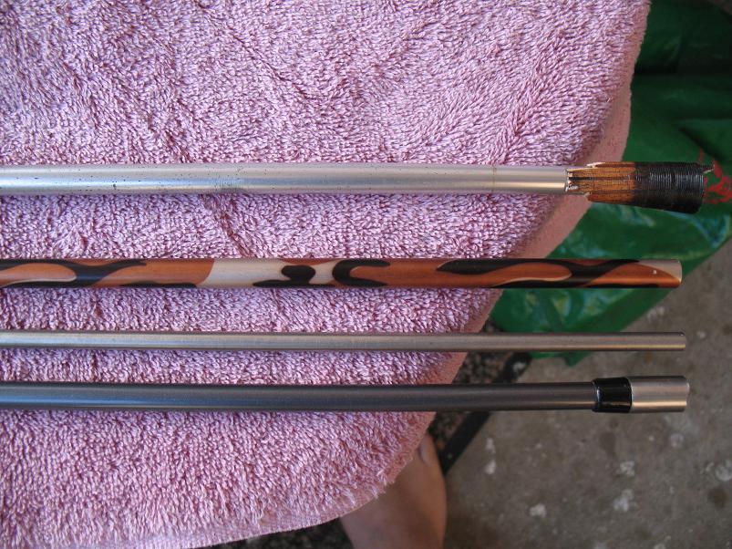

Hello Nannok
I tested the arrow shaft how you wrote and you right! Even the graphite golf club shaft since to me resonate worst than the arrow shaft.
Now the "pure" titanium at least as good if not better than the arrow shaft,
2PC only cost $6.50 (22" each).
I wish you live here nearby because you could tested to.
Also I have a aluminium alloy golf club shaft, that is very stiff, resonate badly and if I bend it it will jump back.
I don't know what type of aluminum on the picture the ticker titanium coated piece.
The 3K type carbon fibre didn't arrived yet so I can say nothing about.
One think is sure how you wrote I want to test a long arm around 15" or so.
If these suspension not the best for long arm I try something similar like yours.
Also I tested the oak wood broom stick and resonate badly, of course that solid not a pipe. I hold one end and drop it on the concrete the other end from 2" or so and I can feel it.
Of course longer the tube resonate worst.
The titanium ultra light and stiff enough for these purpose. 6mm tube with 04mm wall thickness.
http://cgi.ebay.ca/ws/eBayISAPI.dll?ViewItem&item=160737999888
I purchased from here, also I purchased several other type for head shell etc.
Even if I use some dumping material for the titanium because it is thin pipe will remain light.😀
Greetings Gabor

In my project I used carbon fishing rod. Second part of 3. First is too thin.
Regards zeoN_Rider
Regards zeoN_Rider
aluminium arrow shafts and things...
guys:
Remember, I am not claiming "ultimate performance" using the aluminum arrow shafts, but if it was good enough for the Naim ARO tonearm, probably good enough for me. And at least in Canada and the US as close as the local Canadian Tire or Walmart, or local archery range/supplier.
Regarding the use of titanium, I just have never had a local supplier, and I prefer to see/touch/feel things before I do anything. I know the aluminum works. So if it ain't broke, why fix it?
I do think there are sonic benefits to using wood available, I just don't have the means to turn the material down and the time to experiment with shapes. If I was to try using a wood, I think my first choice to try would be good old hard, straight grained Canadian Maple.
We must all recognize that the material choice is part of the equation. The design should be a good one to begin with. A poor design implemented brilliantly will not be improved by material choices, however a good design implemented less than brilliantly will be improved by better implementation and materials. So where does one begin? Personally I'd suggest the later, because it allows for optimization of the tonearm, while the former doesn't without introducing too many variables to isolate.
gabby:If you follow along in this thread, really consider berlinta's comments (re-read the complete thread if necessary). As he is the designer of the tonearm in question his insights are great and carry much weight. One thing I learned relatively early on in my life is that as much as one may learn while pursuing a hobby (in a complete lifetime) it is nothing compared to one learns in a single year doing the same thing full-time.
guys:
