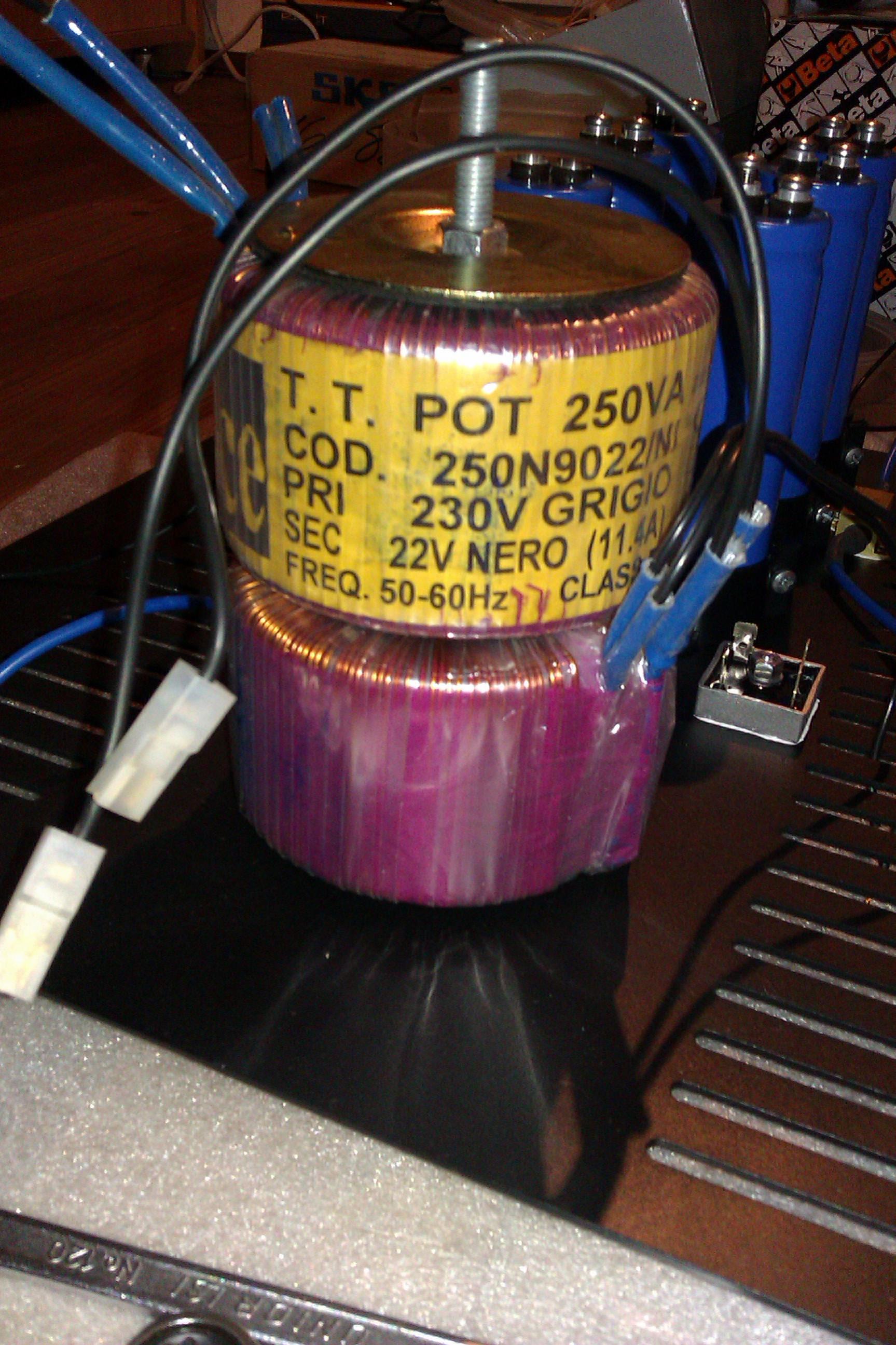

Can I mount 2 toroids in that way?
If not any sugestion.
Yeah! even some well known companies do it that way to save space. Bryston has some amps that way!
