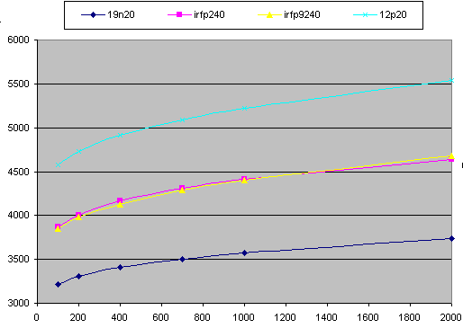

Manu,
Measuring IRFP240, IRFP9240, FQA12P20 & FQA19N20C at 200mA @ 25 deg C and 1A @ 50 deg C I found a relatively strong consistency in the matching.

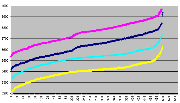

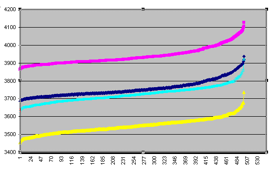

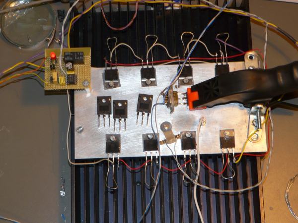

I put here my own experience about matching mosfets.
The method :
On a thermostated table home made, regulated at 35°C +/-0.3°C :
I measure the Vgs when Gate and drain are connected, and Ids injected by a regulated source of current.
The Ids are 100ma and 200ma
Two full batches of Irfp240 and Irfp9240 (2x1000 mosfets).
Here the results for the two batches :
Vgs of the Irfp240 and 9240
Magenta : Batch 1, 200ma / Dark Blue : Batch 1 100 ma
Cyan : Batch 2, 200ma / Yellow : Batch 2, 100ma
You can see that the batches of 240 are better than the 9240 ones.
These batches permit to have a good sextet matching (1mv for 240 and 2mv for 9240).

Thanks for your feedback ... 😎
philbyx said:
Hi Philippe,
Nice setup and interesting results
Thanks for sharing ...
Manu

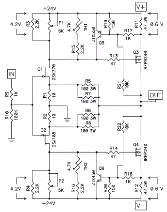

ya mean this ?

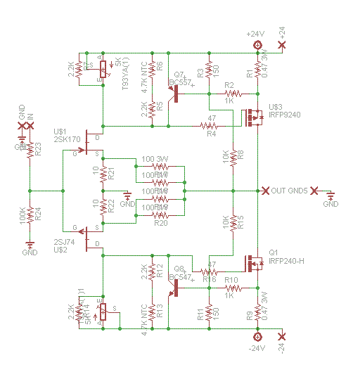

Had you reversed the D-S pins, the 10R wouldn't be source resistors anymore
(Donkey ride : arrow pointing to the JFET gate => gate is P => junction is PN => channel is N => drain is positive => source is negative)
Had you reversed the D-S pins, the 10R wouldn't be source resistors anymore![]()
you're right. the beautiful weather must be getting to my brain
thanks!
