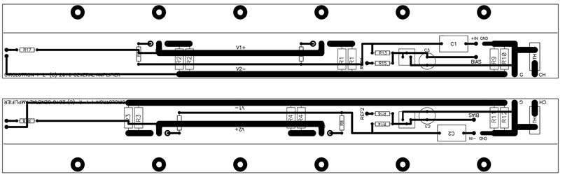

Well, it's not like I don't have one...
:cool:

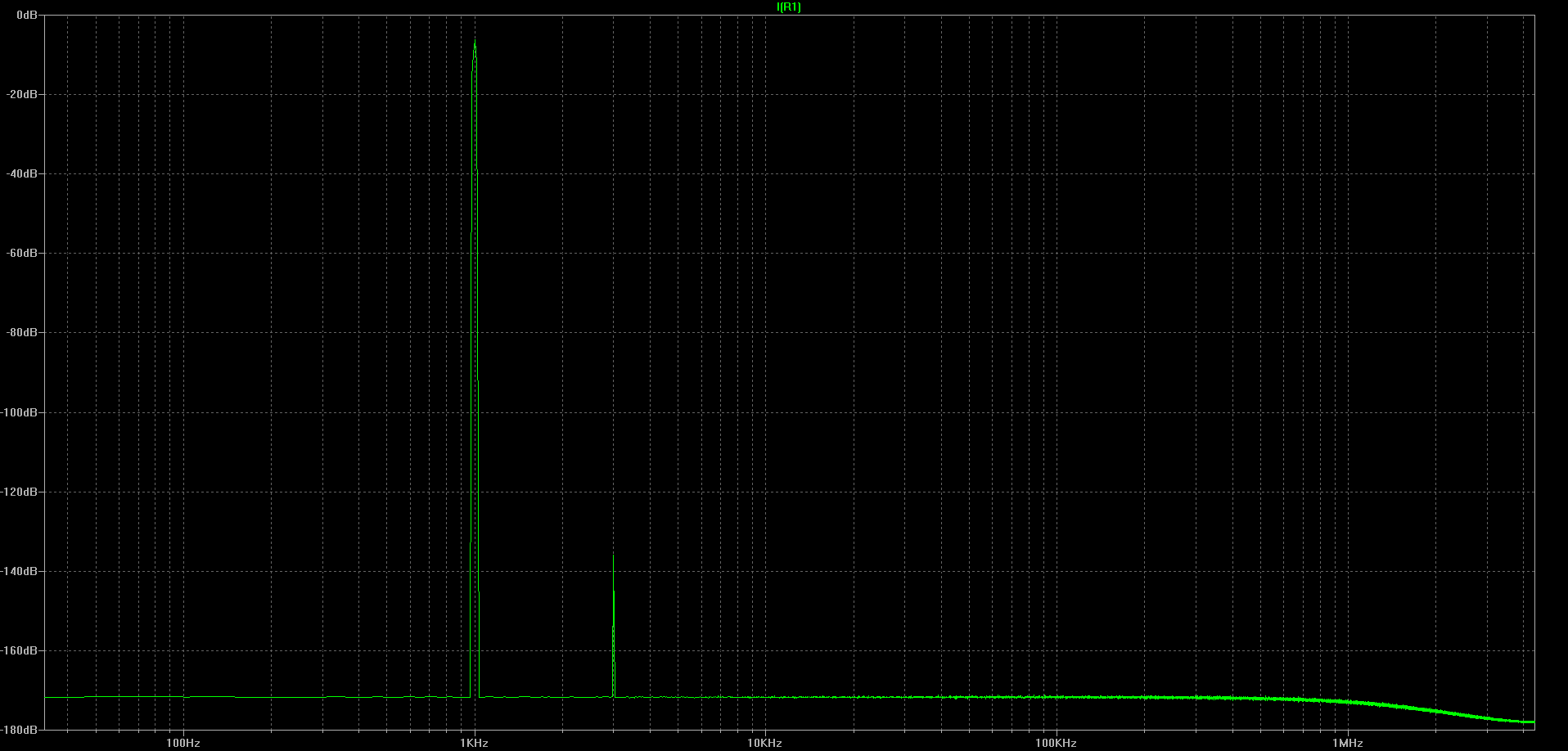

No, the copper we see makes Circlotron sense. There is some skinny traces going off to the left that would only be an LED thingy. And, no big holes for pwr supply connections or speaker outputs... But, the "Ref1", "Ref2" and "Bias" is an important area I have not suceeded in developing enough stability in output offset. I think that is the biggest area to conquer. But, Biasing the 2 halfs into a semetrical complamentary/balanced behaviour is also important.
I wonder though? Is it posible to apply susy to these things???
