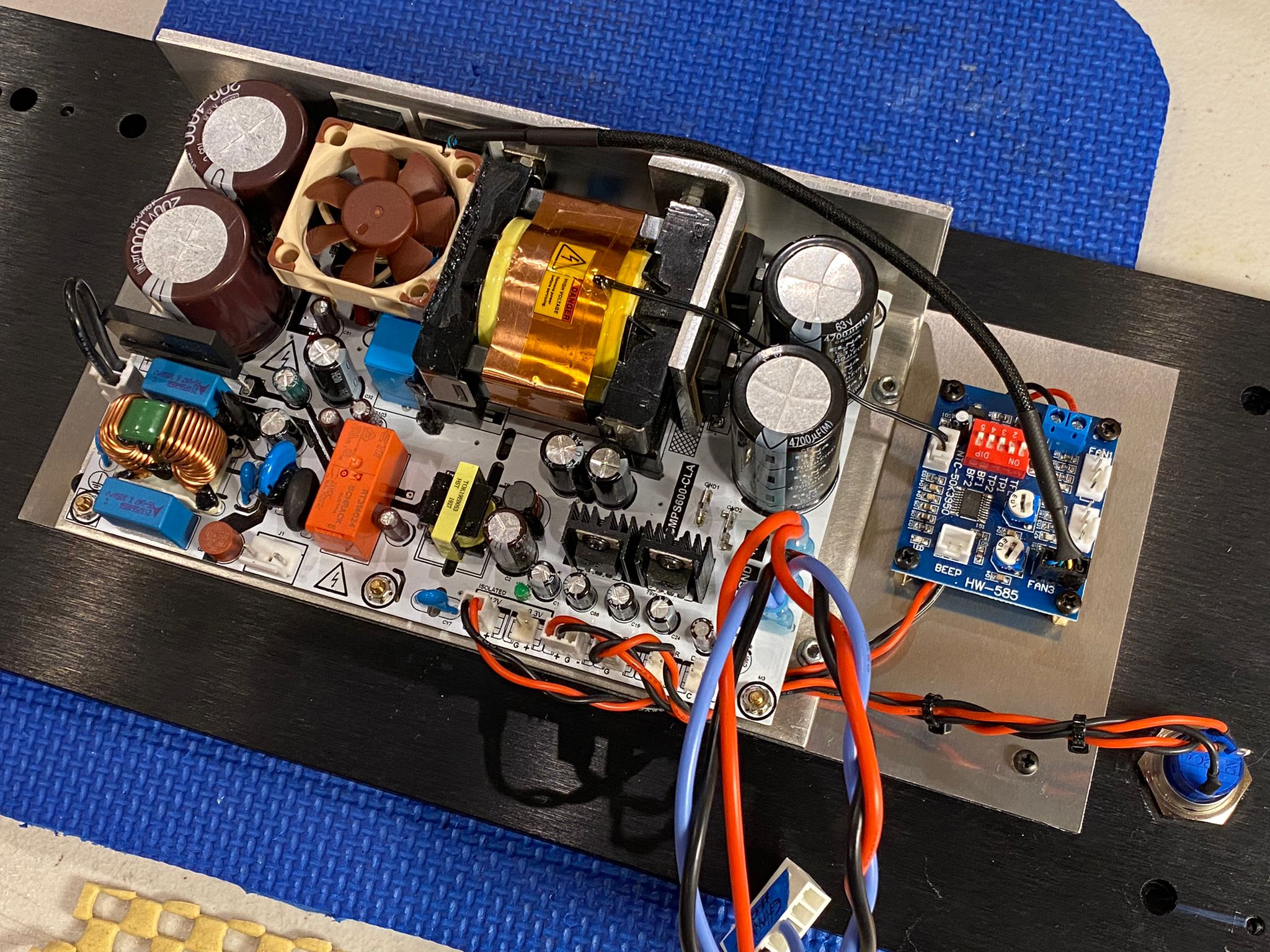

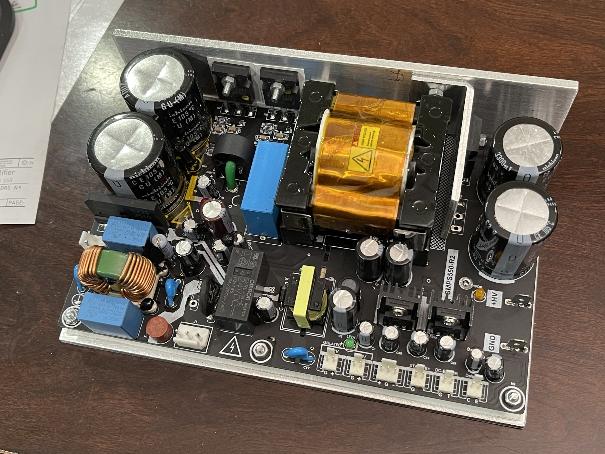

Micro-Audio (Sami) makes excellent SMPS that have a topology where they don’t mind massive cap banks at the PSU output. Very low noise and designed for audio hobbyists ease of use or for OEM applications. I have used many of Sami’s supplies and they are excellent. They don’t have startup hiccup issues. Sami is also very customer service oriented. You are basically getting a custom PSU. You can specify exact voltage, what regulated auxiliary voltages you need (+12v, +5v always on and +/-15v switches are typical). The auxiliary outputs are linear regulated.any recommendations for dual rail (+/-) SMPS . I don't think MeanWell make them, although 2 can be hooked up that way apparently....
You can see he uses top quality name brand components. Here is an example that Vunce is using with a small Noctua fan to help keep it cool for continuous Class A operation.
Here is my 30v 6A Class A PSU from Sami:
Sami even provides for free, a blank cap bank PCB for you to load extra cap filtering after the SMPS.
