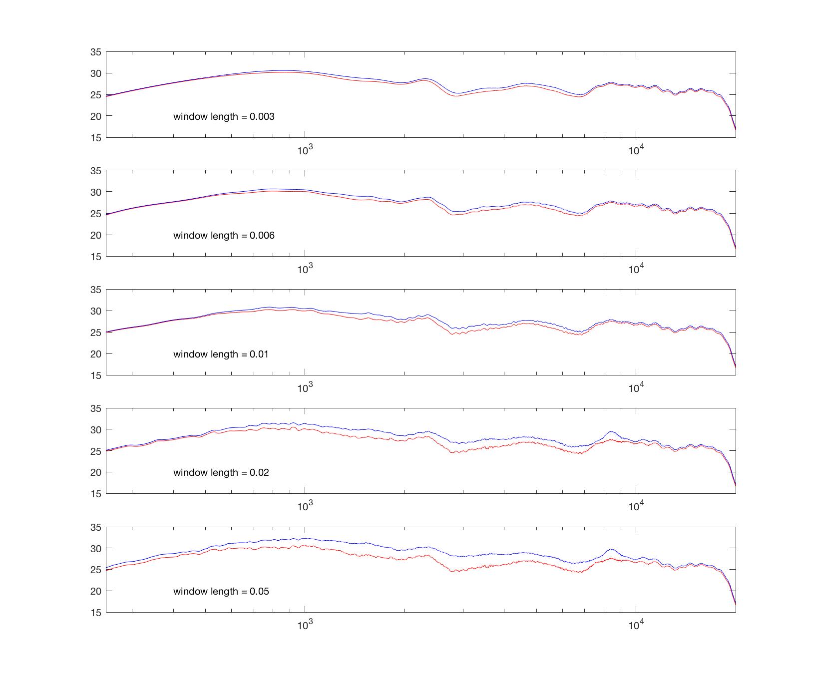

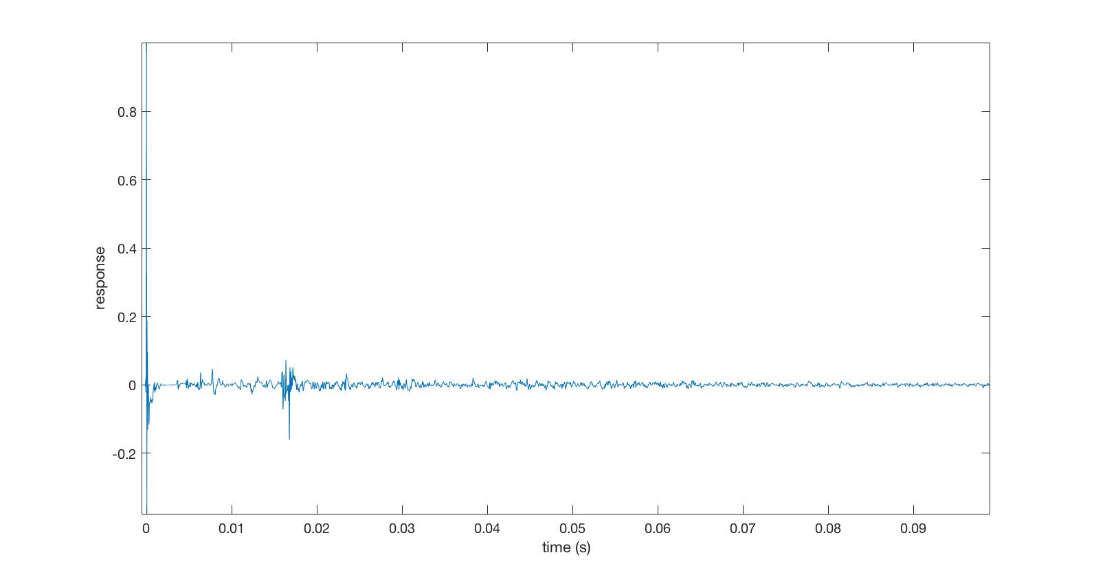

I recently did a series of measurements in preparation for tweaking the equalization and crossover in my planar magnetic towers. The process got me thinking again about how best to average several measurements to establish a starting point for the dsp settings.
First the measurement set-up. The planar tower was driven full range (above 50 Hz). An 800 Hz low pass Bessel filter was applied to the midrange and a high shelf equalization was applied to the tweeter to very roughly flatten the response. No other equalization was applied. The mic was positioned 2.5 m away, directly in front of the tower, at a series of heights starting mid-tower and proceeding up in 2 cm increments over a 34 cm range.
As I dreaded the cyclic process of adjusting the equalization and crossover, repeating the 16 measurements, making new adjustments, re-measuring, readjusting… I started to fantasize about a 16-mic linear array that would allow me to make all the measurements simultaneously. How would the outputs of the 16 microphones be combined?
To simulate the sort of averaging I’ve been doing manually—sum the impulse responses from the various mic positions and then fourier transform the average impulse to get the average SPL response curve—I’d need to do a vector sum of the outputs of the 16 mics in the array. That means including the phase information when summing the mic outputs. I think just electronically summing the mic outputs before sending the result to the soundcard for digitization would get that job done.
But with the recent discussions of the CBT arrays still in the back of my mind, it occurred to me that the linear mic array, used as I’ve described, would be an approximation to a 34 cm long, 6 mm wide single microphone. Such a mic would have a rather complicated polar response pattern in the vertical plane because of the constructive and destructive interference between the signals from different points along the length of the mic. This is analogous to the behavior of a 34 cm long tweeter.
Is that really what I want to use to establish a starting point for equalization? It’s not clear to me the result, with all the interferences, would map well onto a listener’s perception. On the other hand, if the phase information is not included in the averaging, then the average doesn’t provide the phase information one would need to calculate group delay or linearize phase.
These musings led me down the path of identifying the role of phase when averaging a series of measurements.

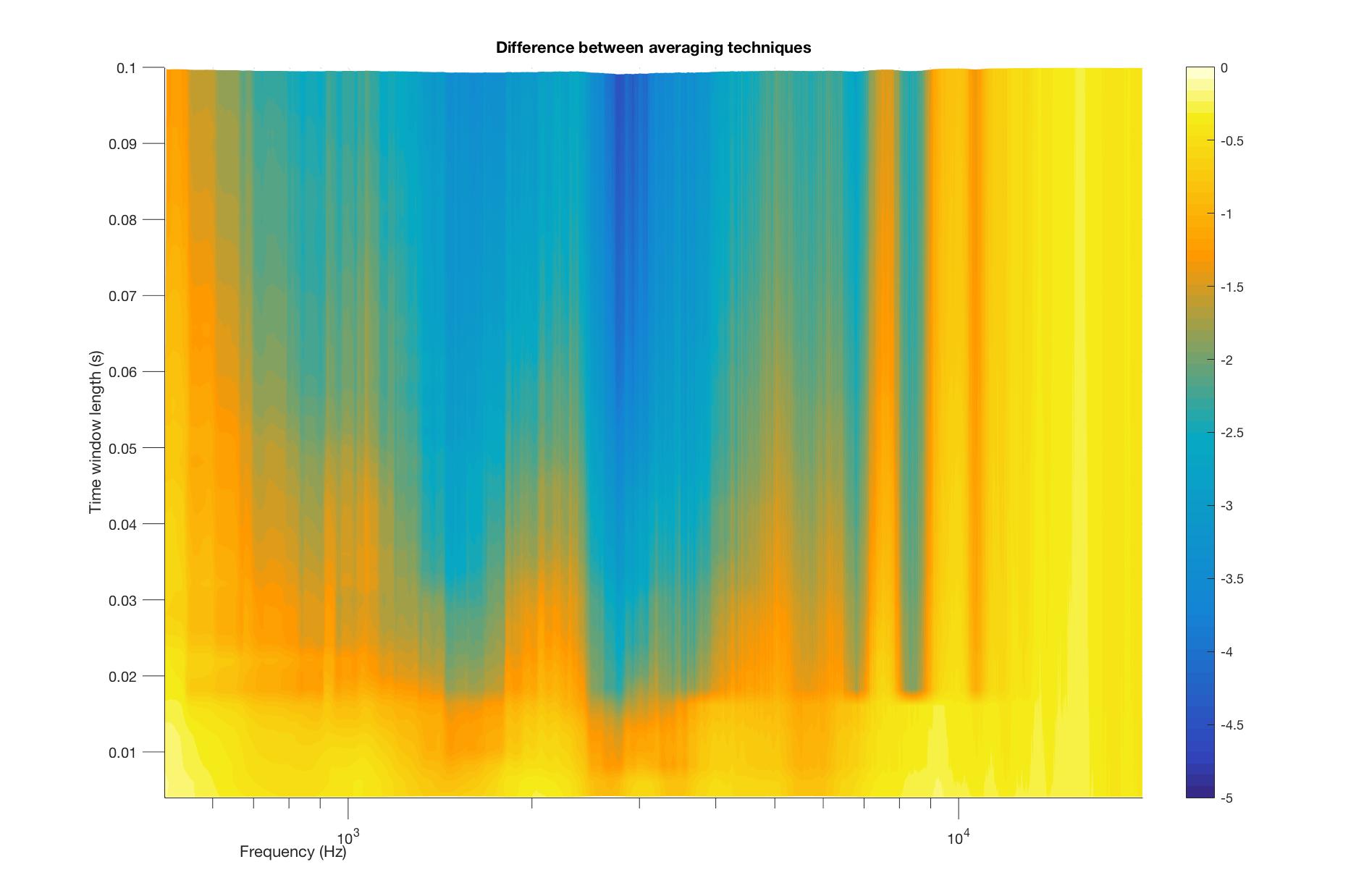

Working with the same measurements that I posted previously, I averaged the data two ways:
The attached figures show first the average impulse response so it’s clear where room reflections show up. Note that it spans 50 milliseconds. The second figure shows five graphs, each of which compares the results of the two averaging techniques. The red line shows the average-the-impulses result, the blue line shows the average-the-magnitudes result. The graphs differ in the span of the time window (which is specified on each graph)—brief at the top and long at the bottom. It makes it clear that the difference between the with-phase and without-phase averages increases as the time window is made longer.
To determine if the difference grows because of the increasing contribution of room reflections, I plotted the difference between the two averages as a function of window span. The result is attachment #3. Yellow indicates little difference, orange means about 1 dB, and dark blue is a 5 dB difference. Near the bottom of the surface plot (near time zero) the window is very short and there is clearly no time for room reflections to contribute. The two averaging techniques yield very similar results. Moving toward the top of the graph the time span of the window increases. There are several clear horizontal edges in the graph; these are points where the difference between the averages changes quickly. The most prominent is a bit before 0.020 seconds. Well, sure enough, there’s a significant reflection visible in the impulse response graph around 17 milliseconds. There’s also an abrupt change in the surface plot around 10 ms and the impulse response again shows a reflection immediately before that time.
So the measurements seem to show that room reflections are a significant contributor to the difference between vector addition (phase included) and magnitude-only addition as part of the averaging process. It makes sense that reflections would arrive with scrambled phase as a result of the propagation delay, so the arrival of reflections causes a big difference between the two averaging techniques.
Going back to the graphs in the second attachment, they show that if the window is made long enough so that room reflections are allowed to contribute, the difference between the two averages becomes quite significant. They differ especially over the 800-8000 Hz range, the same range over which the moving mic and windowed curves differed. Does that imply that the phase scrambling associated with room reflections is a major cause of changes in SPL measurements? I’d always thought the reflections just carried a different spectral balance because the surfaces reflected some frequencies more than others. No doubt that happens, but maybe I should be including the phase more prominently in my mental picture of what’s going on. To explore that further I looked at the spectral content of the late arriving signals but I'll hold that for later. This post is way too long already.

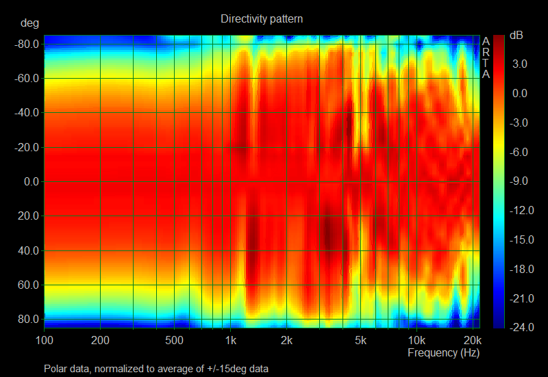

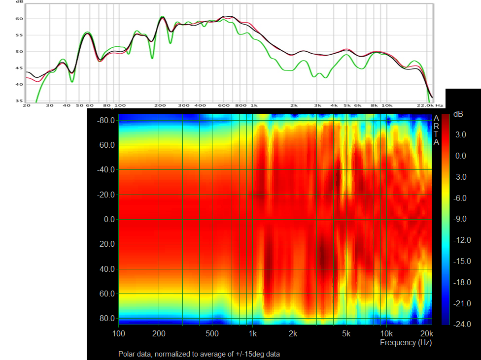

I spent a little time trying to clean up some of the angles with glitchy impulse responses from REW.…I had a good look at the directivity of the planar towers based on the angular impulse measurements I posted a bit ago. Those plots haven't been posted here (I don't want to post the product of someone else's labors!) but they seemed to show a few features of interest:
1) Overall, the directivity is fairly constant over +/-90 degrees and the range of frequencies accommodated by the necessary windowing.
2) In a very narrow frequency range around 5 KHz there's a narrowing of the directivity.
3) Above 5 KHz, up to maybe 15 KHz, the directivity gradually broadens; this is a fairly mild effect.
Attached is the result of my efforts, showing polar response normalized to the average of the response in the +15 to -15deg range.
The +/-20deg alley is remarkably uniform….and other than the 5kHz “feature” that uniformity extends out to nearly +/-40deg.

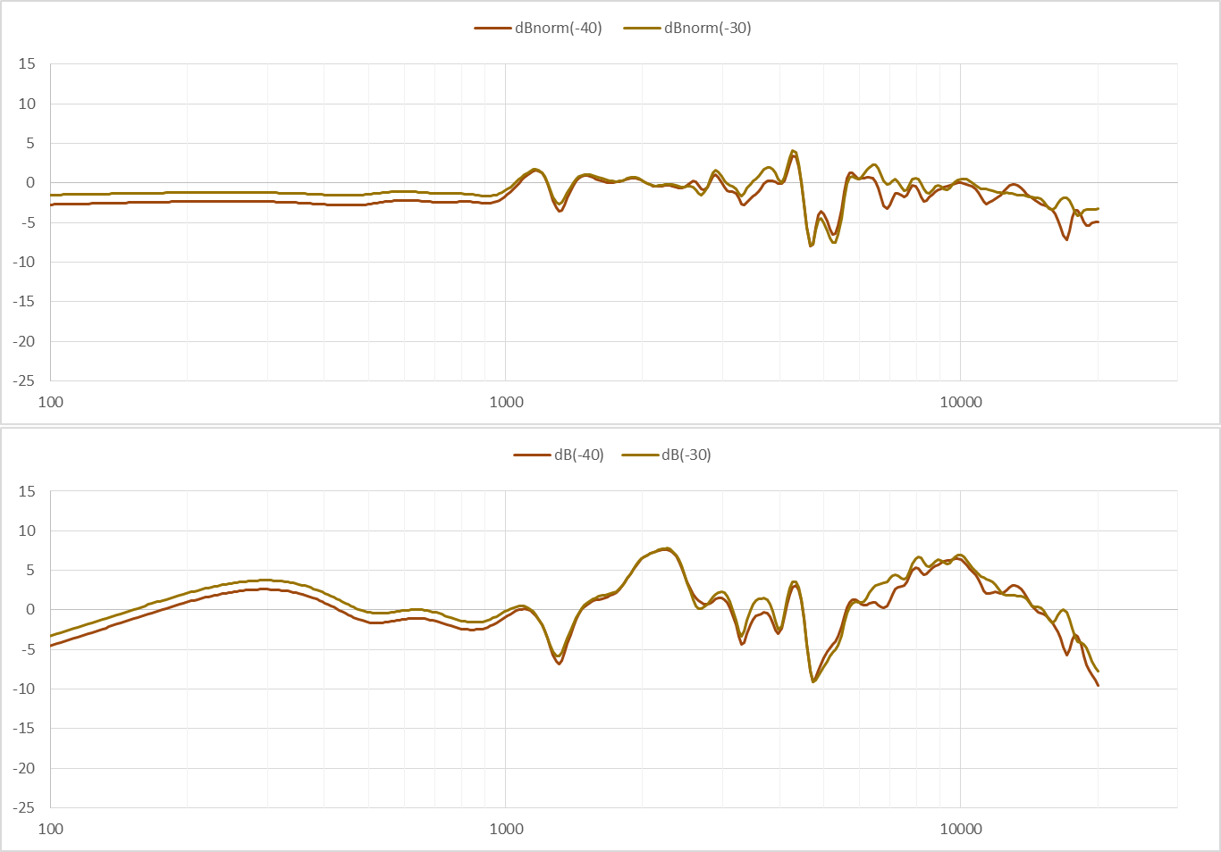

Very nice set of measurements and plots in Post#210.To see if I could identify the source of the narrowing at 5 KHz I just completed a set of nearfield measurements. I scanned the mic horizontally in 1 cm increments and at a height that placed the mic about one third of the way up the third panel (counting from the floor).
Clearly, the 5kHz feature is not related to anything happening at the source…I had wondered if you might see some sort of lateral diaphragm mode behavior there since at that frequency you were only driving the middle tweeter portion of the diaphragm.
The next likely source would be a reflection from the frame.
I plotted the 30deg and 40deg data, and the notch in the response from the polar is easy to see with or without normalization. You might try setting up to measure this angle and switch between driving just the tweeter section, to driving tweeter and mid uniformly together. It wouldn’t surprise me if the notch disappeared when the tweeter and mid are driven together. The tweeter section is so narrow, its broad dispersion might be “lighting up” a reflective surface that won’t be when the whole width of the planar is driven. If this winds up being the case, you might consider moving the midrange LP filter up to 5kHz. I would also suggest experimenting with a shallower slope first order filter. This would avoid any possibility of phase cancellation since the phase will never differ by more than 90deg. Also, if it works well, you could switch to passive filtering and reduce the required amplifier count.
From an overall sound quality perspective, the 5kHz notch at off-axis angles likely “looks” a lot worse than it sounds. However, I share your desire to understand the reason for the notch, even if you decide in the end not to do anything about it.

Thanks, Bolserst, for posting the directivity plot and for the suggestions. I agree there's nothing in the nearfield plots (glad you like 'em!) that suggests the diaphragm is doing something untoward and causing the narrow necking at 5 KHz.
Your suggestion that I run the midrange a bit higher to narrow the response is a good one. I'll have to give that a try. I wanted to see how close to an ideal dipole response I could get with my horizontal MTM setup but backing off a bit on the output at wide angles probably makes good sense. Maybe I can simultaneously get the directivity from 1 - 5 KHz to match more closely the slightly narrower directivity at frequencies above and below that range. Wouldn't it be nice if that magically addressed the differences between the two averaging techniques (the differences occurred mostly between 800 and 8000 Hz)! That's probably a bit much to hope for...
