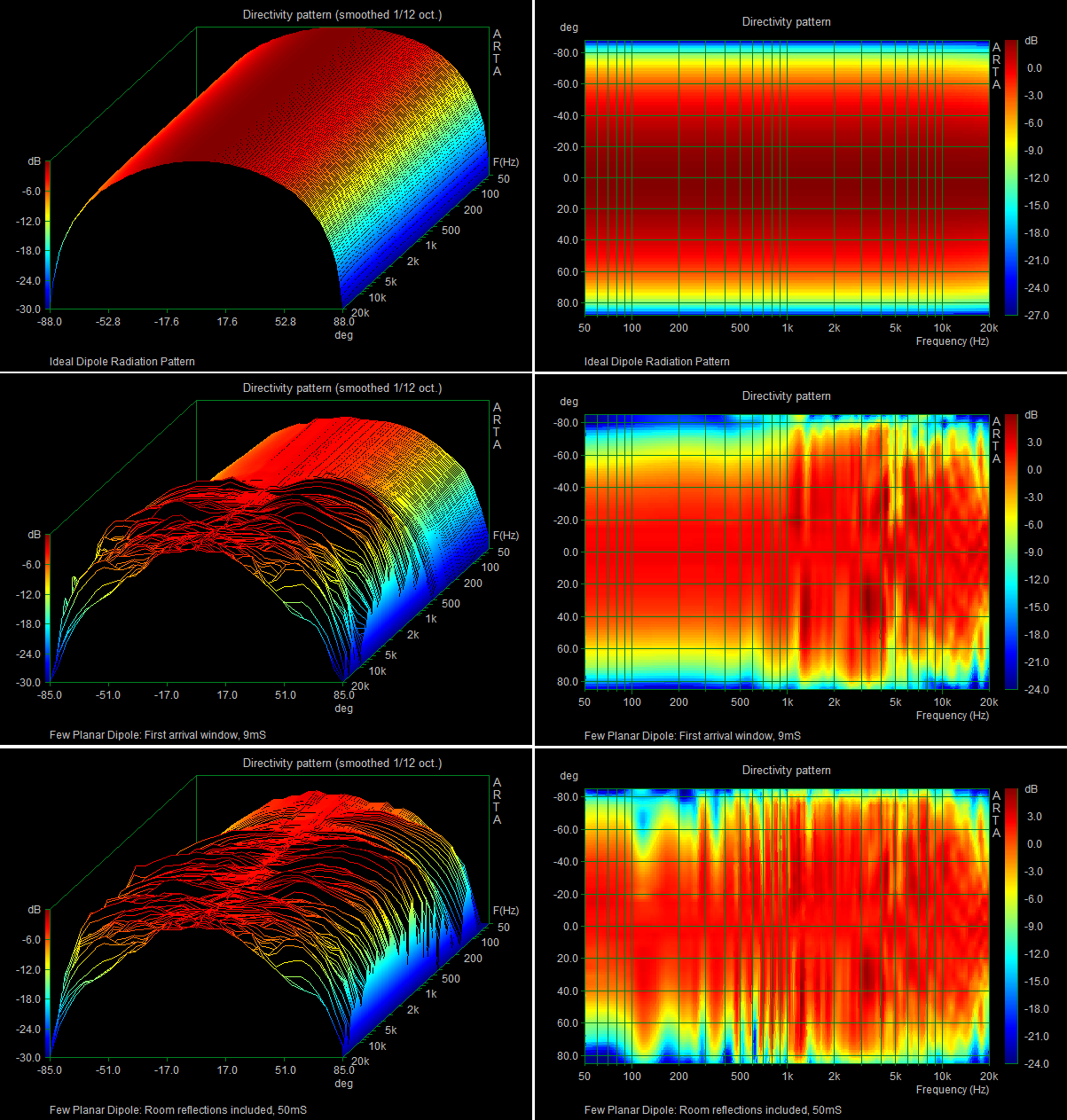

"Why do people think that an ideal dipole radiation pattern is desirable?"
Being an avid ready of Toole, you are aware that having uniform or smoothly trending frequency response that decreases in level as you move off-axis results in high listener satisfaction. This is exactly what an ideal dipole radiation pattern is. The result is that the ratio of direct sound to room sound is increased, and what room sound there is has a spectral balance that matches that of the direct sound to a substantial degree. You will find that MMM measurements and windowed first arrival measurements would differ less than without an ideal dipole radiation pattern. Said another way, the speaker becomes less room dependent.
The caveat that goes with the above is that we are talking above the Schroeder frequency. Room modes will still dominate the LF response, and dipoles will just act like spaced monopoles driving the room.http://www.diyaudio.com/forums/multi-way/121590-cardioid-bass-26.html#post1508846
Just for fun, attached is a plot comparing ideal dipole response and the polar response of Few’s planar towers. The bottom set of plots includes considerable room energy in the 50mS window and yet the dipole nature is still easily discernible, although you can start to see room modes taking over below 300Hz in the sonogram view.

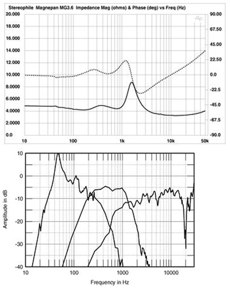

Have you been able to see impedance variations from reflections or other acoustic problems with planar drivers? I haven’t had much luck with it. Unlike dynamic drivers, the coupling between the acoustic/mechanical domain and the electrical domain is pretty weak. As an example, even diaphragm resonance with a 10-15dB peak results in barely perceptible wrinkle in Magnepan impedance.WHen you have the three measurement son the same graph laid out correctly you can make inferences on what is happening mechanically to cause purterbations in the frequency domain. A phase wiggle at exactly the same point as a impedance wiggle or a frequency wiggle shows relationship…

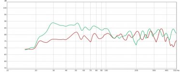

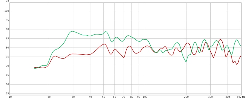

Despite the difference of "suspension", below 100 Hz the two subs are notably similar. While in the region 100 to maybe 180 or 200 where the subs are playing, they are not. In other words and as you say, the low freq sound at my chair depends a lot on the room and less on the theory of OB phase cancellation. There may have been a bit of EQ applied in these curves (can't remember), but any EQ might have reduced the similarity of the curves.
Second, about the satisfying theoretical purity of Few's curves, as far as I understand his measurement set-up and room, there is less "room" in his measurements and more "speaker". I'm glad to see acoustic theory sustained, even if you chide me for the "disruptive" instincts we now see rising in our culture.

You have presented a difficult question to answer and an impossible to use source of i formation.
In my work I use a Smith &Larson SpeakerTesterPro. It can be used to resolve very small impedance fluctuations. Whereas the information you use in the Stereophile graph is there as a statement. But a statement that I can neither verify not use as an example.
As a simple point. Resonance on a planar is hard to find. And it will be at the impedance maximum and the phase 0 crossing point. A dual parameter measurement is required for that. But a very high resolution measurement to be able to discern it. As you say correctly that the impedance bump is very small.
I think I mentioned at some point that measuring these types of drivers is jumping into the deep end of the pool 😀

Sorry, it wasn’t supposed to be a difficult question…just a simple yes or no if you had had any luck troubleshooting planar response anomalies with impedance measurements. I was curious, since I have not. It sounded like Few planned to perform some impedance measurements when he gets his amp back, so we will see what if anything can be gleaned from them.You have presented a difficult question to answer…
aaAaah…ok. Considering all discussion and measurements in this thread have thus far been geared to the planar midrange/tweeter towers I jumped to the conclusion that your statement was related.…my point of view (which I should have made more evident) related to Linkwitz and low freq phase cancellation.
I don't know how small an impedance variation he can resolve using REW. That is why it is a difficult question.
What I can do here at my place is probably a little different than what Few can accomplish without dedicated equipment.
But there should be enough correlation between the three different measurements of phase frequency and impedance to give us a bit of information.
Mark: I believe you mentioned your SpeakerTesterPro system measures two parameters. Does it use phase sensitive detection like a lock-in amplifier? I have one of those in my research lab but without a pressing question to answer I'm reluctant to rip it out of that system and haul it home to use it for speaker testing. I'm guessing that I could pick out smaller impedance ripples that way but I'm not really looking for another project, which is what would likely be involved. Nonetheless, I'm curious about the measurement tricks your system employs.
