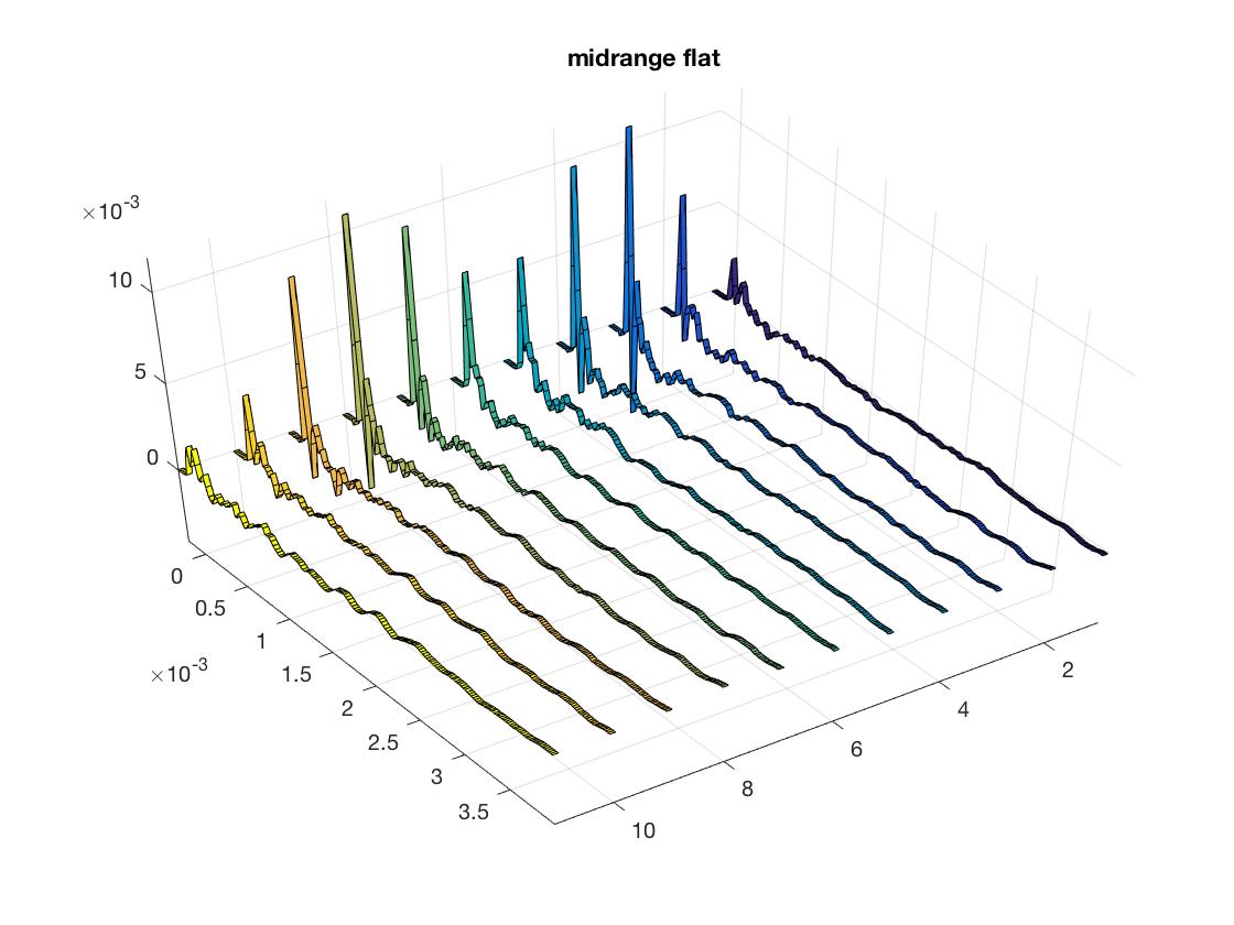

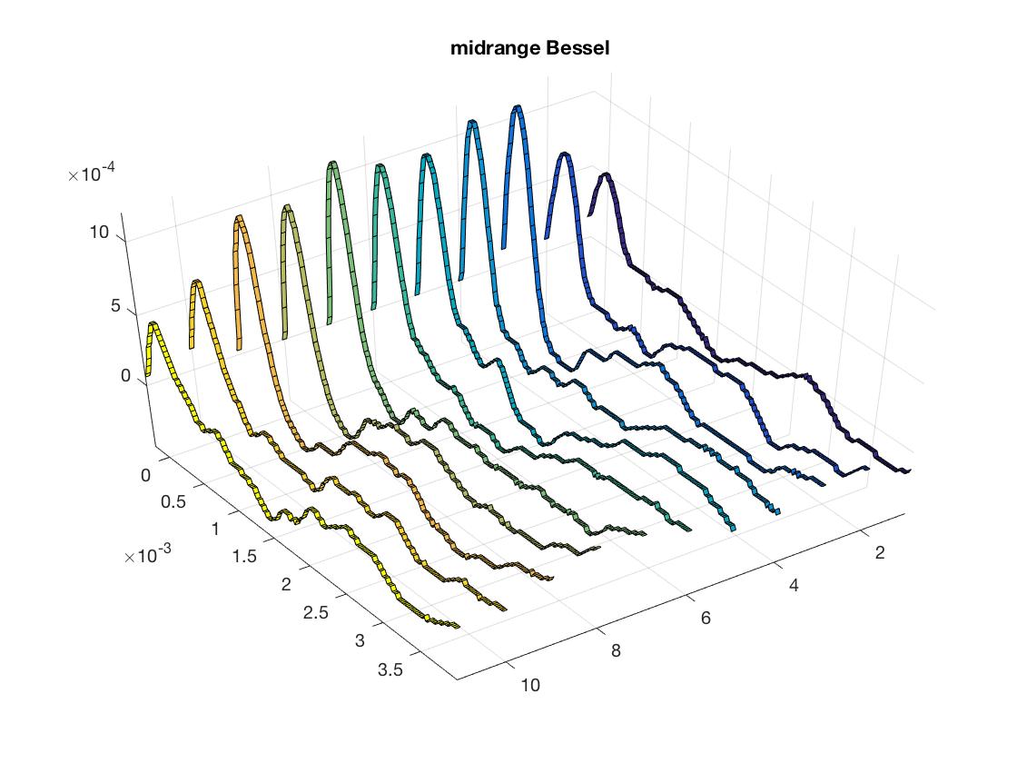

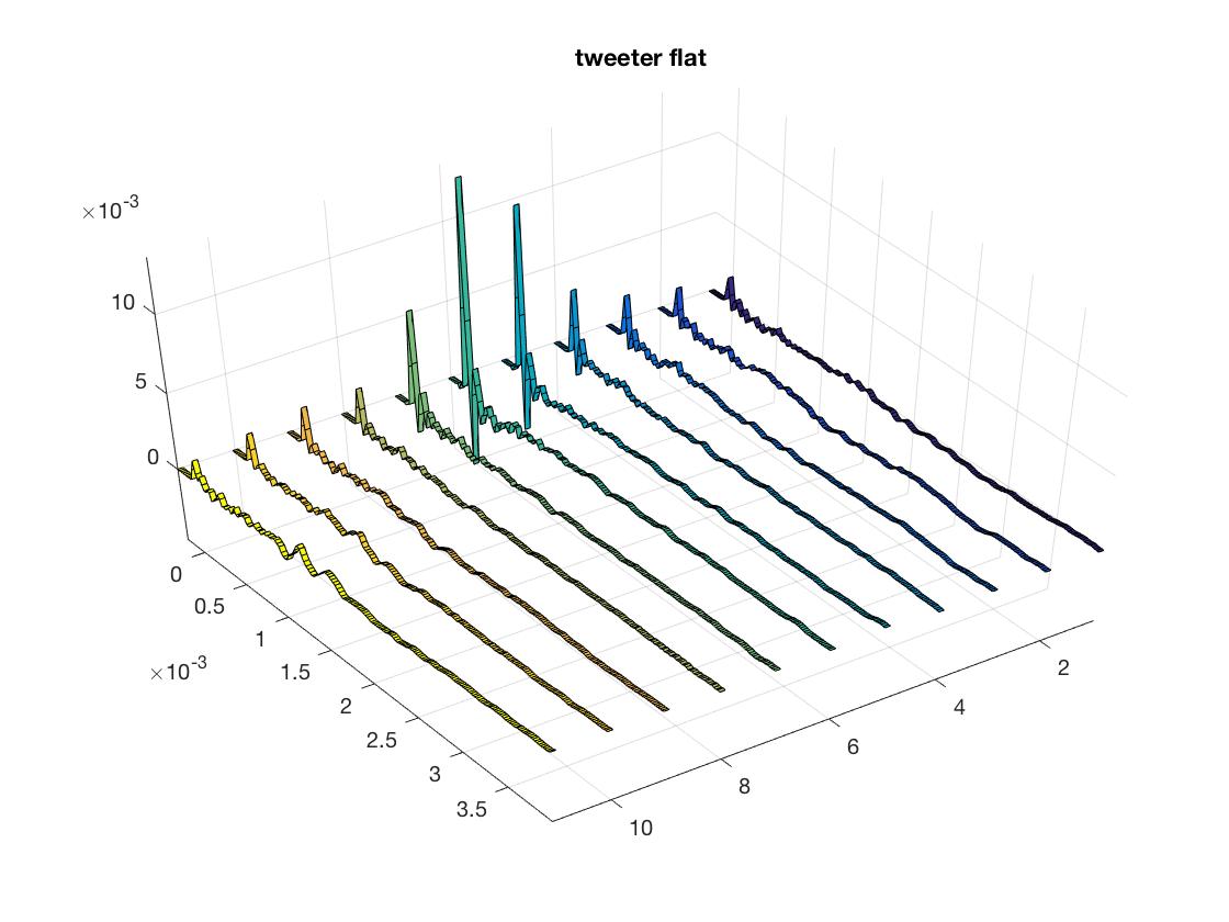

To see if I could identify the source of the narrowing at 5 KHz I just completed a set of nearfield measurements. I scanned the mic horizontally in 1 cm increments and at a height that placed the mic about one third of the way up the third panel (counting from the floor).
I made the measurements with six different settings.
The resulting impulse responses are attached in the order listed above. Note that the vertical scales vary while the time scale is fixed. The impulses make it clear that when only the tweeter is driven the diaphragm motion is pretty well restricted to the driven area (graph 3). When only the midrange is driven, and it's driven full range, there's a little bit of tweeter diaphragm motion (graph 2). When the midrange is low-pass filtered by a second order Bessel at 1 KHz (final graph) the whole diaphragm moves pretty much equally.
I haven't yet done any useful plotting in the frequency domain. I'm hoping that doing so will reveal the source of the 5 KHz directivity narrowing, which may not be super intrusive when listening to music but having seen it I'd like to know what it comes from.

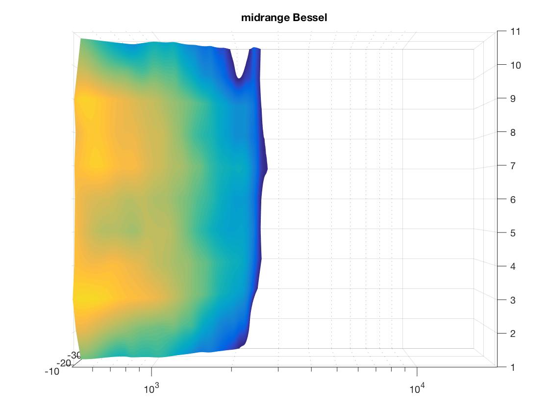

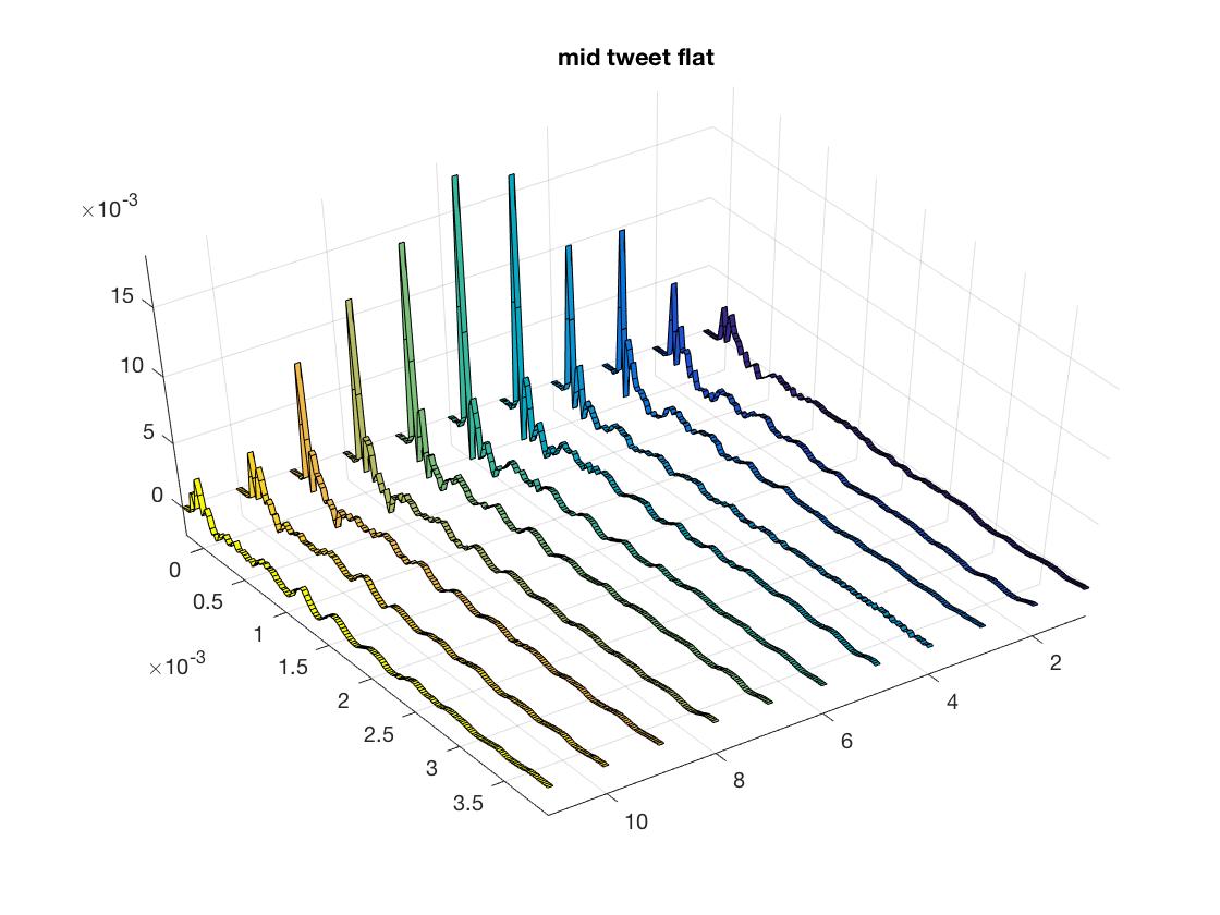

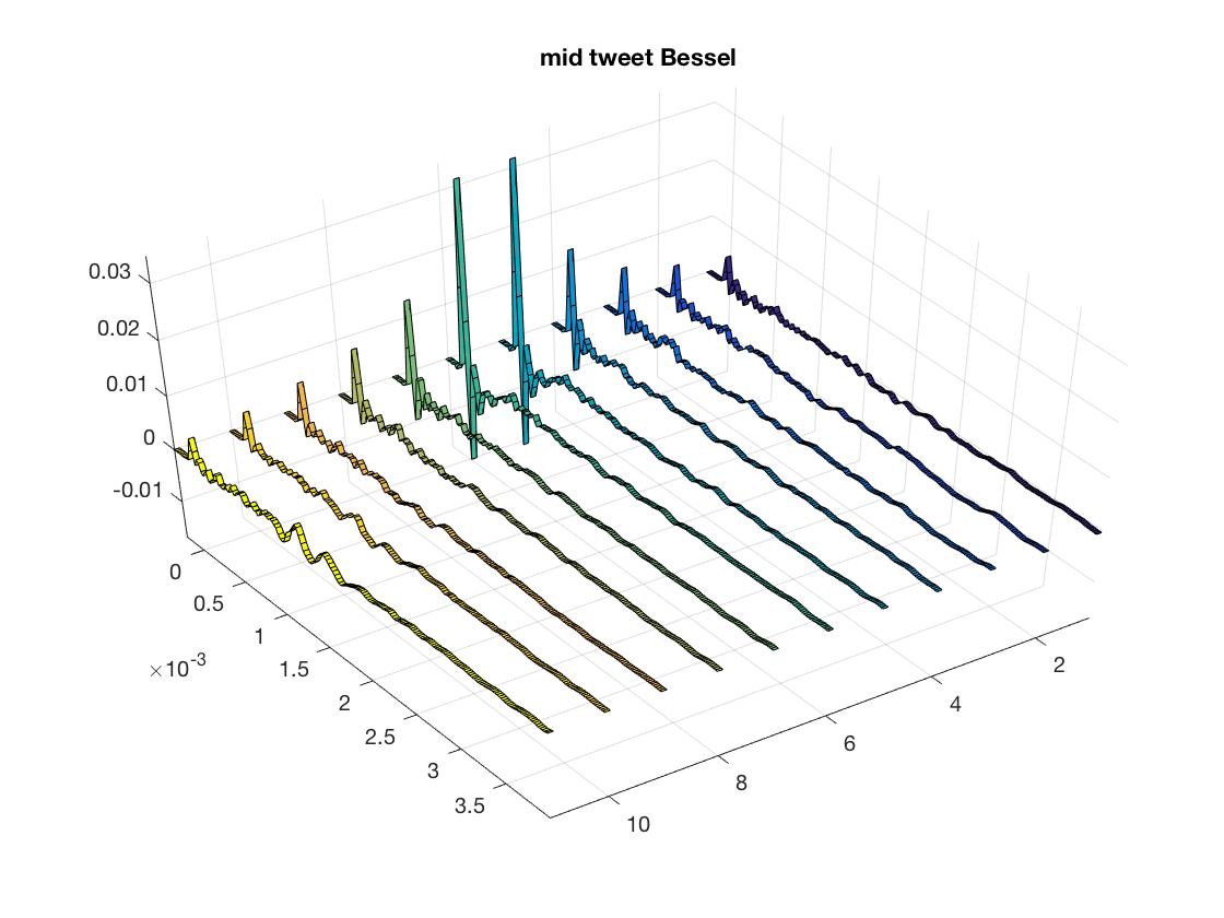

1) Midrange and tweeter both driven without equalization or crossovers
2) Midrange-only, no equalization or crossover
3) Tweeter-only, no equalization or crossover
4) Midrange and tweeter both driven; Bessel low pass on midrange, tweeter boosted with a shelf filter to compensate.
5) Midrange-only; Bessel low pass

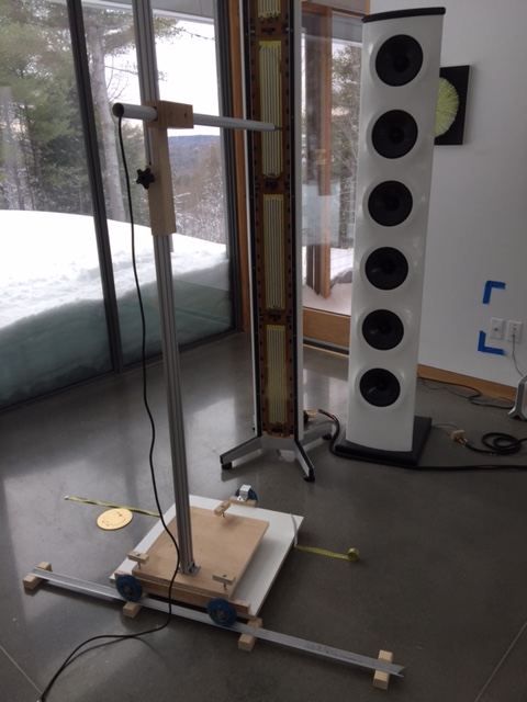

I had hoped to have some frequency domain plots to post this evening but I've been too busy digging out from yesterday's winter storm and preparing for tomorrow's.
As a placeholder I'm attaching a photo of my newfangled microphone translation scheme---complete with ridiculously over-capable wheels (they're what I had handy). Two wheels are guided by a 90 degree angle piece of aluminum and the third wheel rides on the floor, but with an adjustable brake (so the thing doesn't roll uncontrollably).
It looks like overkill, and no doubt it is, but I've wasted too much time fiddling with microphone positioning with all these measurement series. I've found it much less frustrating to be able to position the mic precisely and reproducibly, even if it means investing some time building a device to make it possible.
Before building this thing I made four series of measurements like the ones I posted but had to throw them all away when I realized the mic had crept too close to the diaphragm for several of the scans. A couple of hours of work down the drain. If anyone decides they have a reason for doing a systematic series of measurements, my advice is to invest the time to build an apparatus that makes it easy to do the series without fidgeting with positioning. You'll be glad you did.

Regarding post 205.
An unconventional means of showing data.
So this is a heavily processed reading of an impulse response sent to the planar driver using a bandwidth limited signal?
The usual means is a directivity balloon. But I get the overall drift of what you are trying to show.
And I lika the mic stand!

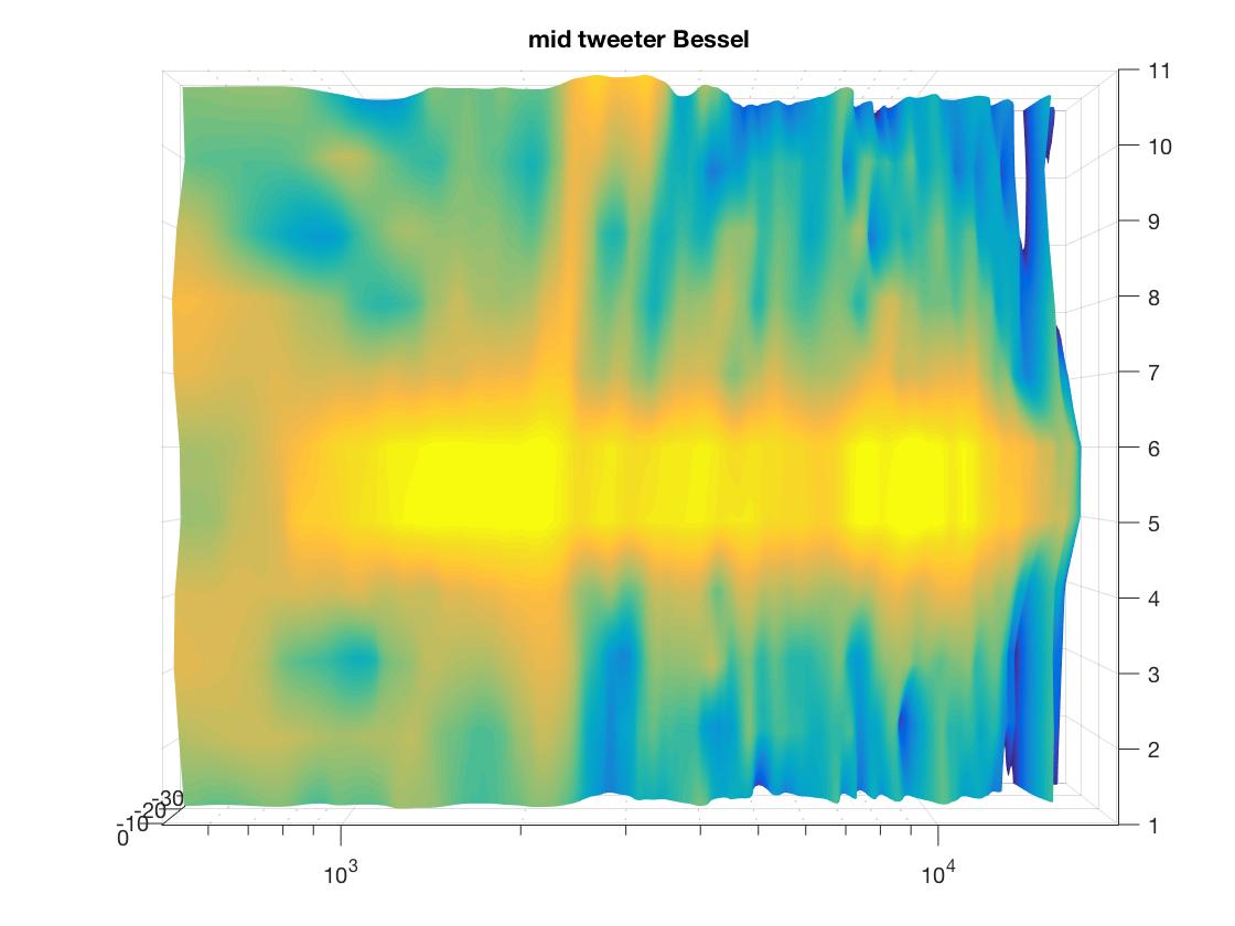

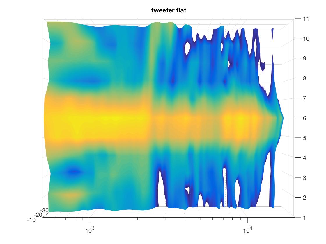

I finally managed to fourier transform the impulse responses and present the results in a way that isn't impossible to interpret. The colormap spans about 25 dB. Frequency is along the horizontal axis and position along the width of the diaphragm is displayed along the vertical axis.
A reflection off the woofer tower, which I should have moved out of the way, corrupts the measurements labeled 10 and 11 cm. I'm hoping the distraction isn't a major problem. I've just finished the plots and haven't stared at them very long, but the cause of the 5 KHz necking in the directivity doesn't come screaming out at me. The plots seem to show that the expected parts of the diaphragm are active at the expected frequencies.

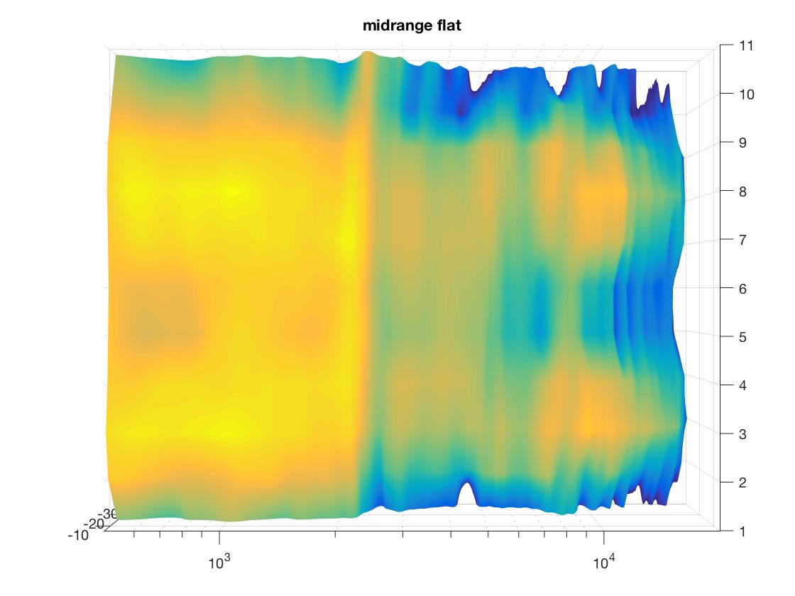

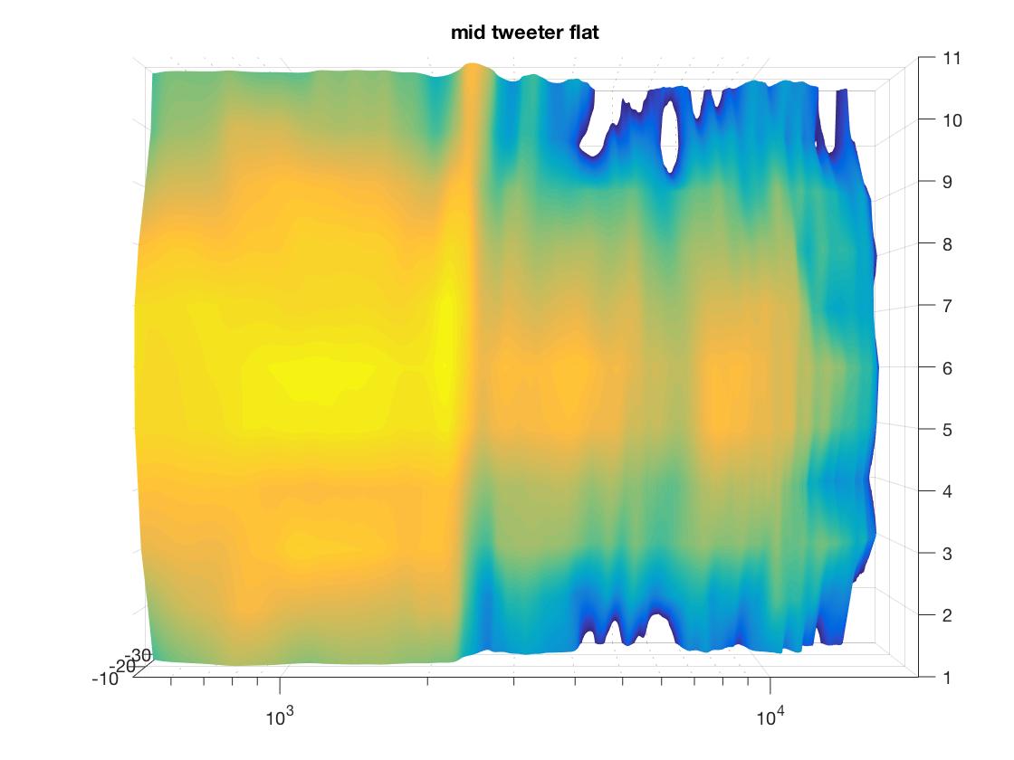

I should probably add a couple of comments on the most recent graphs so they can be interpreted more easily.
I didn't normalize the responses, even though that's sometimes done for a series of this sort. in each graph. In each graph, the eleven measurements were made at the eleven different positions along the width of a panel, and each measurement is presented "raw."
The colormaps are very similar from graph to graph but not absolutely identical. I decided to move the upper colomap limit up or down one or two dB if it made the pattern clearer, figuring nobody was going to be drawing quantitative data from the graphs. (I'll send you the impulse responses if you want to do your own quantitative comparisons.)
The graph that is closest to the way I've been running the speakers is attachment number 4. That graph has none of the equalization I've been applying except that the tweeter has the high shelf included in order to compensate for the Bessel low-pass applied to the midrange. Attachment 5 makes the impact of the low-pass filter quite clear---no high frequencies generated anywhere when only the midrange is driven.
Finally, maybe it's obvious, but I'll point out that in attachment 2 the double-ridge pattern is a result of the fact that only the midrange conductors are being driven--not the central tweeter. So the big gap running horizontally along the middle of the graph (at high frequencies) reflects the fact that the tweeter is turned off and only the midrange is being driven. But, since the "midrange" is being driven full-range (no Bessel low-pass) in this measurement, the diaphragm radiates high frequencies from the regions of the diaphragm that are directly driven.
Few
Few
That helps a bit. Novel graphing methods fail to make sense without the keys to the system. Thanks FEW.
