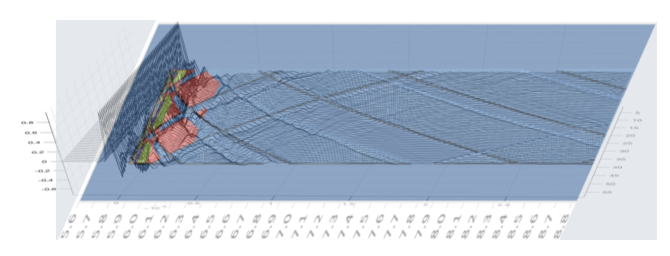

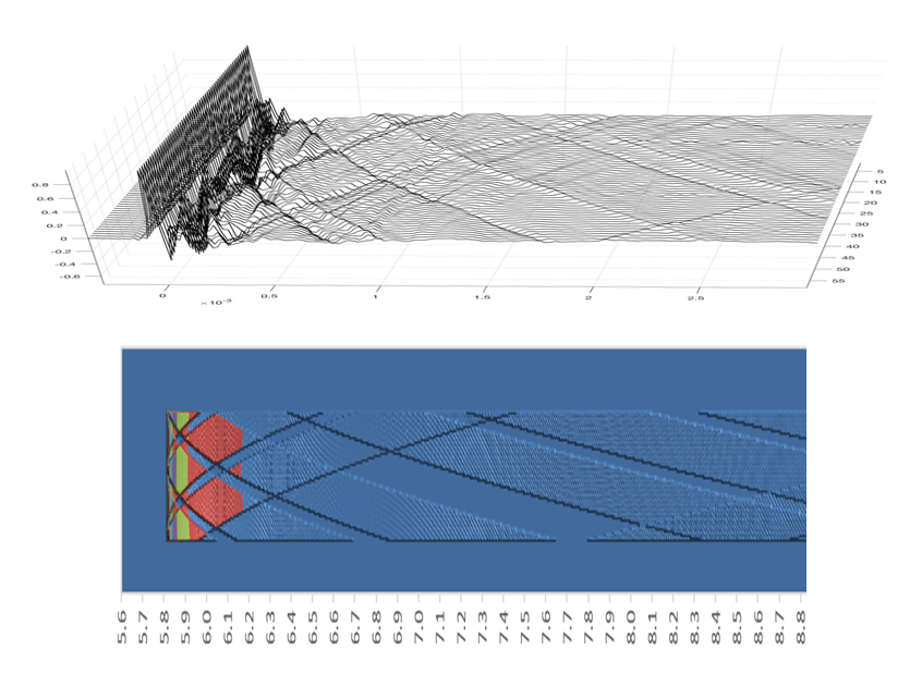

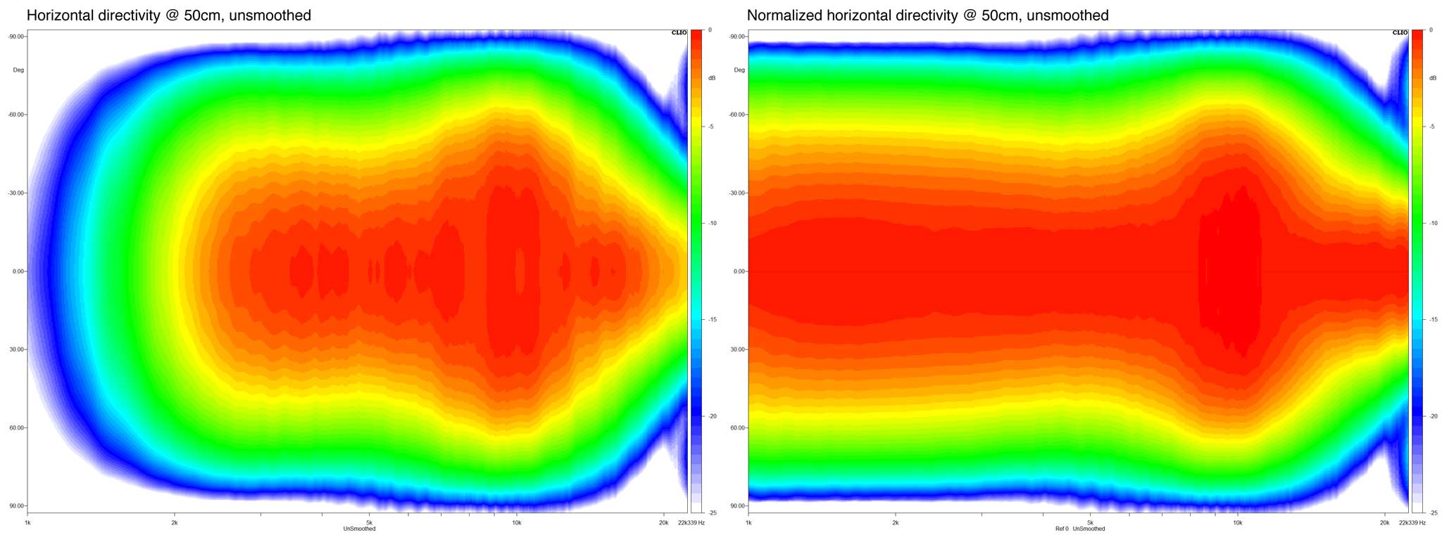

Since I have had a couple private inquiries about how gaps between the planars result in the criss-cross patterns seen in Few’s plot in post#170 I figured I’d post a few pics to help visualize what is going on. I calculated impulse response @2m from the planar array from just above to just below the ends of the array. As before, negative heights are used for response below the array center, positive heights for response above the center.
Attachment #2: A pair of contour plots of the impulse response for the array in free space, and with the first floor and ceiling mirror included. X-axis is time, Y-axis is height. Comparing the two, it is easy to see what time ranges of the impulse responses are coming from the direct sources and what time ranges are coming from the mirrors. Note that the ceiling mirror arrives later in time than the floor mirror since the gap to the ceiling is larger. (660mm vs 170mm)

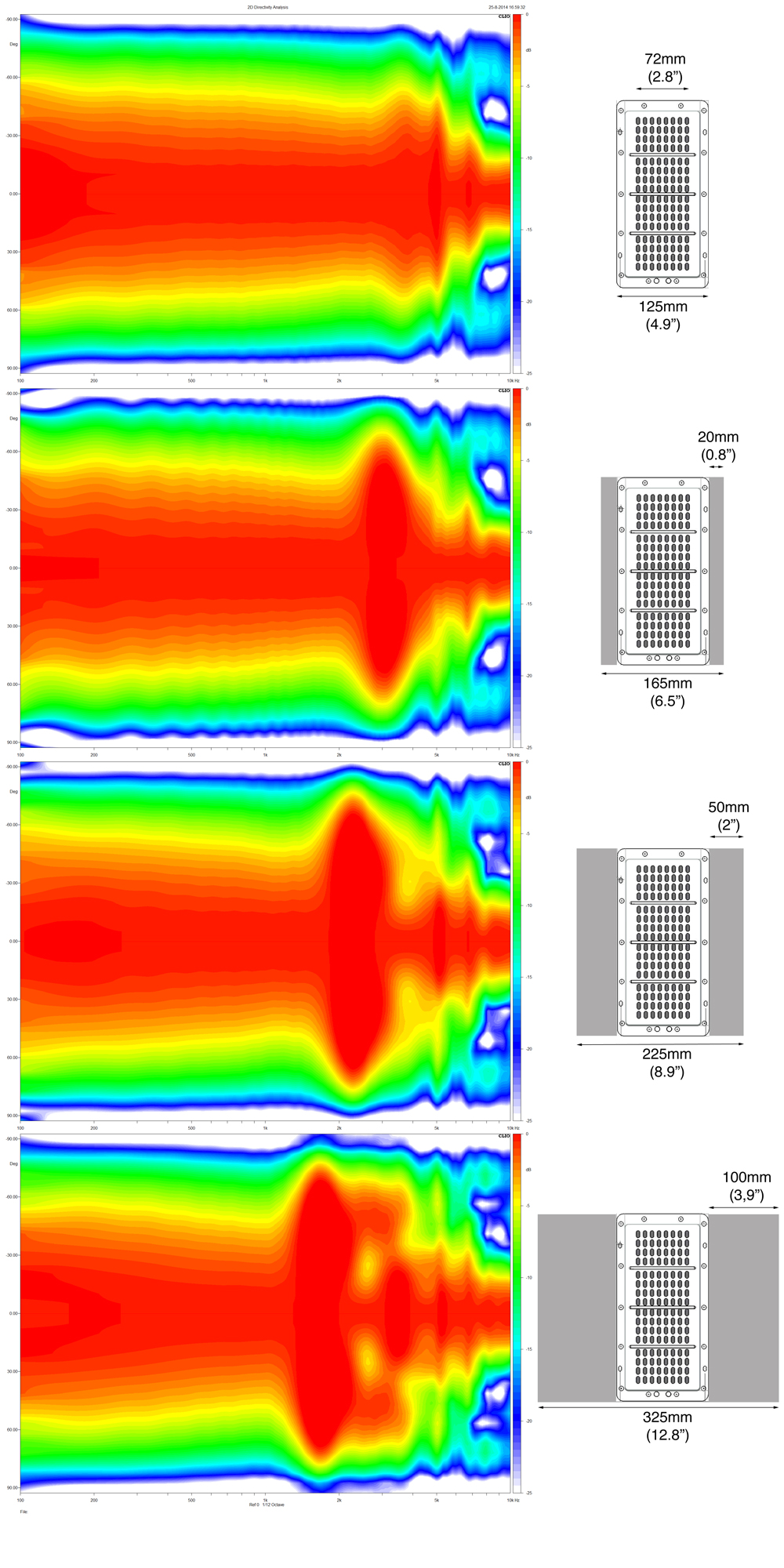

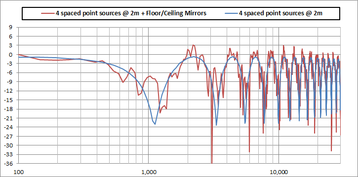

Attachment #3, #4: If I trim up and appropriately scale the contour plot with mirrors(and flip it so floor is at top) it can be directly compared with plot from post#170. Skewing the contour plot to match the perspective of post#170 and the overlay makes the pattern match even more obvious. It's not a perfect match, but pretty darn close 😉

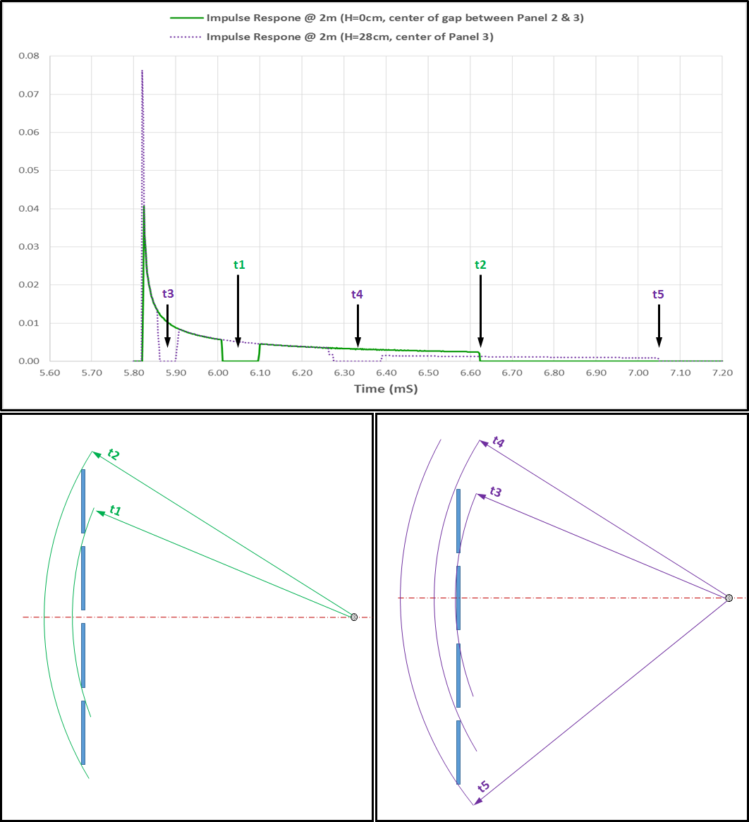

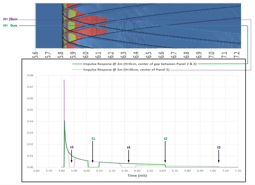

To understand why the pattern is generated in the matrix of impulse response, lets look at a couple in more detail.
Attachment #5: Here are the impulse responses for the middle of the array and middle of the 3rd panel. To improve clarity, I used monopole sources with response to DC rather than dipole sources. Note the smoothly decaying impulse interrupted with a few notches and a level shift.
Attachment #6: Thinking of the impulse as a time history of the acoustic energy arriving from the line array. You can draw a circle of radius = (time x speed of sound) to see where the energy is coming from at the point on the impulse. When you do this, you will notice the notches align with times when this radius falls on gaps in the array. The shift down in level of the purple curve relative to the green curve just after t4 is because the time window has moved beyond the top of the array for the purple curve and acoustic energy is only being received from the single bottom panel of the array.

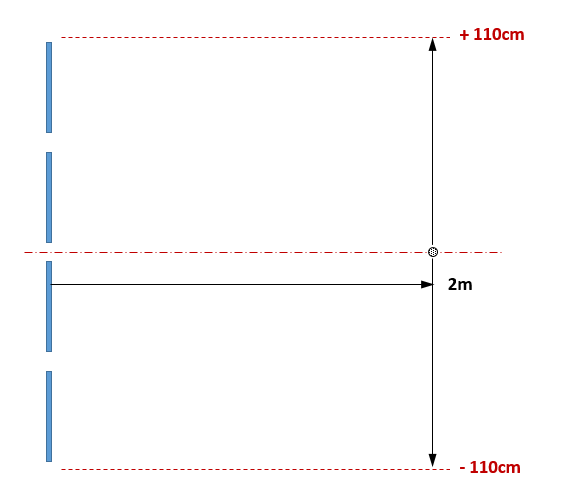

Any slice through the contour plots of Attachment #2 can be investigated in a similar manner to understand that the pattern is generated due to shifted time windows between the mic and the gaps in the array or gaps between array and floor/ceiling mirrors.

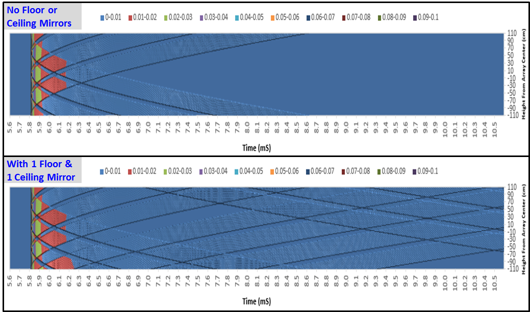

In your experience, how late in the impulse response should reflections be considered as part of the “first arrival” signal that would have the peaks and dips EQd out? Usually with large planar dipoles I don’t see any significant contribution from reflections in the first 5mS – 7mS. This may be because these type of loudspeakers tend to be placed well out into the room and away from sidewalls.The left/right variations are recommended to sort out reflections from planes parallel to the arrays. Due to their vertical size they "average out" a lot of in room objects in a room, except for large vertical parallel planes.
It would be good to take a close look at the IR to see the level of reflections left after the averaging process.
Bolserst: The match between my measurements and your model is quite remarkable. Very cool to see. Thanks for putting in the effort! I confess that I'm relieved that my (second) explanation of the ripples is supported by your model.
How hard would it be to add to your model a tapered or attenuated response at the ends of each panel? I was envisioning putting felt over the top and bottom inch or two of each panel (an unsophisticated variation on what RAAL does with their ribbon tweeter). I'm guessing the ripples would be less pronounced but it would be interesting to know if there's any hope of this technique working before trying to find felt and figuring out how to install it. Of course if adding it to the model isn't a quick job please don't take it on. You've been overly generous with your time already.

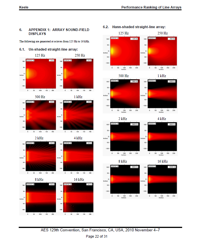

Something tells me you put lot more time and effort into your measurements than I did at the computer keyboard. There are many aspects of theory built into my modeling tools that I have yet to validate with experimental results…and I only have so much free time. So, a heartfelt thanks back at you for expending the effort to meticulously collect the set of 58 spatially distributed measurements.Bolserst: The match between my measurements and your model is quite remarkable. Very cool to see. Thanks for putting in the effort!
If you are talking about level shading, I’m already setup to do that with any definition you can come up with. There is some merit to the idea as you can see in the attached image from Keele’s paper on line sources. http://www.xlrtechs.com/dbkeele.com...rmance Ranking of Loudspeaker Line Arrays.pdfHow hard would it be to add to your model a tapered or attenuated response at the ends of each panel? I was envisioning putting felt over the top and bottom inch or two of each panel (an unsophisticated variation on what RAAL does with their ribbon tweeter). I'm guessing the ripples would be less pronounced but it would be interesting to know if there's any hope of this technique working before trying to find felt and figuring out how to install it.
I’ve never applied it to individual planars in an array, just the whole array. So, may have to run that in the next couple of days to see what the results are for a few common windows functions. (ie Hanning, Hamming, Triangle, Tukey). Obviously no matter what the result, you would be losing considerable sensitivity.
If you are talking about frequency shading where you are progressively rolling off the highs as you move toward the top and bottom of the planar, I am not currently setup to do this, but wouldn’t take much effect. However, I would expect this technique to increase vertical dispersion for each planar which would increase the comb filtering effect as mwmkravchenko mentioned. In any case, if you can define areas and roll-off characteristics, I can easily include it in the model.
Just want to make sure we are talking about the same effect. Comb filtering results from difference in path length from two sources(or more). With center-to-center distance of roughly 57cm and measuring at 2m, the first null would occur between 1kHz and 2kHz (depending on the height) where the path length difference is ½ wavelength. If you replaced the planars with 4 point sources located at the center of the planars you would get a response something like the attached, illustrating the comb filter issue. With the planars uniformly driven along their height, their vertical directivity precludes comb filtering to this degree....As you have the distances set up now the comb filtering effects will be based around 6 to 8 kilohertz, or at least close to that area by simple edge to edge calculations.
+1...Between 1 kilohertz and 4 kilohertz you are in a region that a db or so at the right point can make some interesting differences in perspective of a sound. Literally move the apparent sound stage closer or farther...
Bolserst: I wasn't thinking of shading in the Keele sense, more along the lines you described next--slightly attenuating the output (primarily at higher frequencies) for the top and bottom few cm of each panel. I follow your (and Mark's) argument about increasing the vertical spread from each planar because its effective length is reduced, and the increasing the comb filtering. So I guess the question is whether it would also "soften" the ripples seen in the impulse responses as I suggested. If it does both, then does this result in better or worse sound quality? Clearly perfection in the time and frequency domains go hand in hand. When imperfections are inevitable it's less clear to me how they can be best hidden.
Of course what I'm suggesting may just make things worse in all domains, including the "effort required to implement" domain. It wouldn't be the first time...

I have never investigated it. It looks like Hann-shading at both top and bottom would come close to eliminating floor and ceiling reflections for all but the lowest frequencies. I am curious though...will try to give it a look this weekend.If you use floor to ceiling, think of what happens with the floor and ceiling reflection of that shaded array.
You might check this paper out for direct comparison of point source, straight line(unshaded/shaded) and CBT all with floor reflection. (no ceiling though)The funny thing I see in the Keely array papers is; his CBT is presented with a floor reflection helping out the concept, while somehow the straight array and the shaded array don't seem to get that beneficial reflection from the floor nor the ceiling.
http://www.xlrtechs.com/dbkeele.com/PDF/Keele (2005-10 AES Preprint) - CBT Paper 5.pdf
