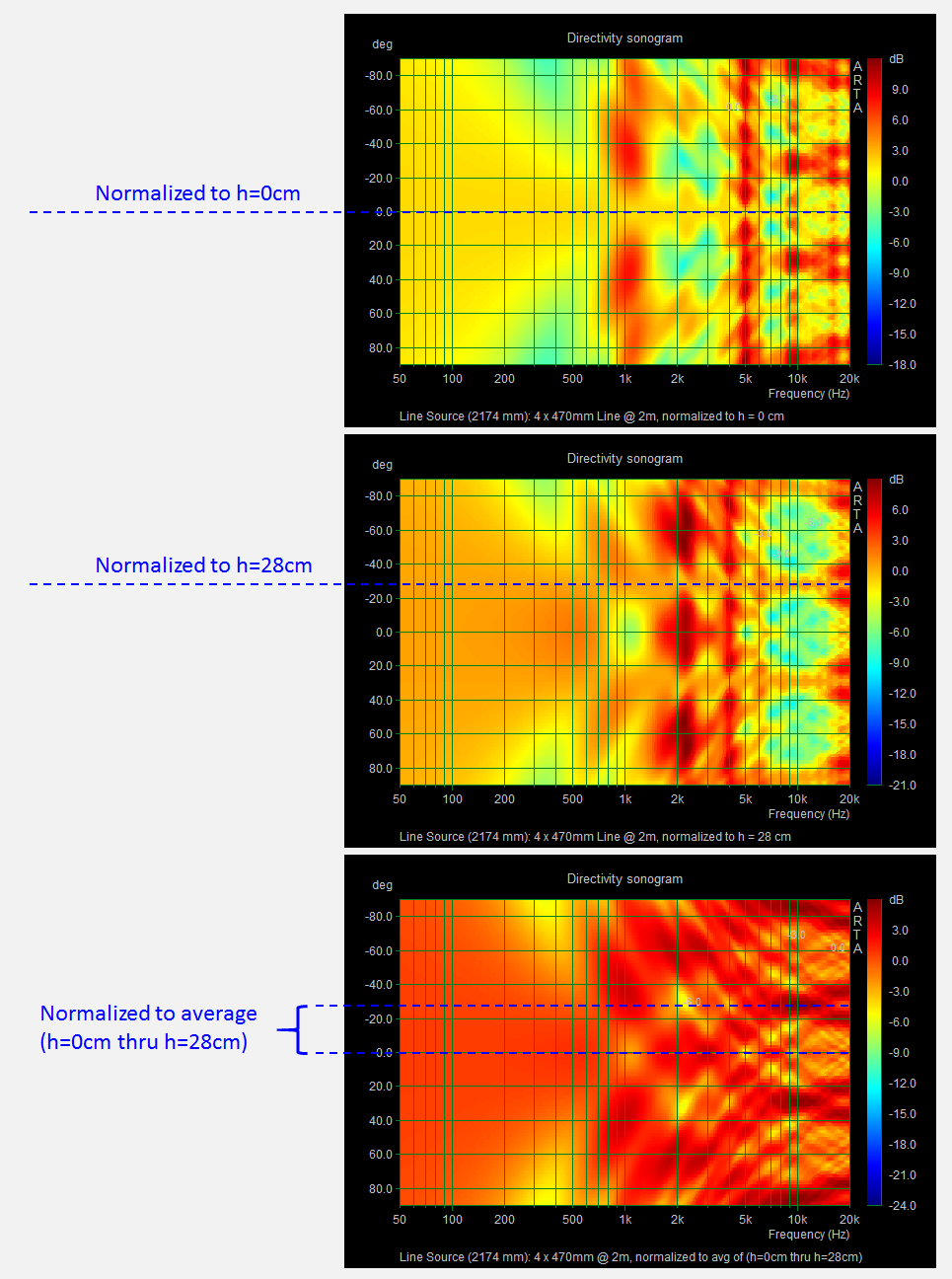

That is because the response was normalized to that height. (ie it was assumed EQ was applied to make the measured response flat at the height). Back in Post #132 I actually provided two sets of plots, one normalized at the tower midpoint(h = 0) and one normalized close to the center of the 3rd planar (h=28). I combined them in the attachment so you can compare. The data is exactly the same, it just makes a different assumption as to what listening height you had used to EQ flat.I noticed in your reflection-free simulations that the response looks quite smooth right along the tower midpoint. For example, the top right sonogram in your most recent set (post #137) shows quite uniform response along the 0 degree axis.
The alternate method(bottom plot in attachment) is to determine the average response and normalize based on that.
Of course when normalizing by an average response there will not be a single height for which there is a smooth response.
But, this is probably more representative of what your goal is for EQ.

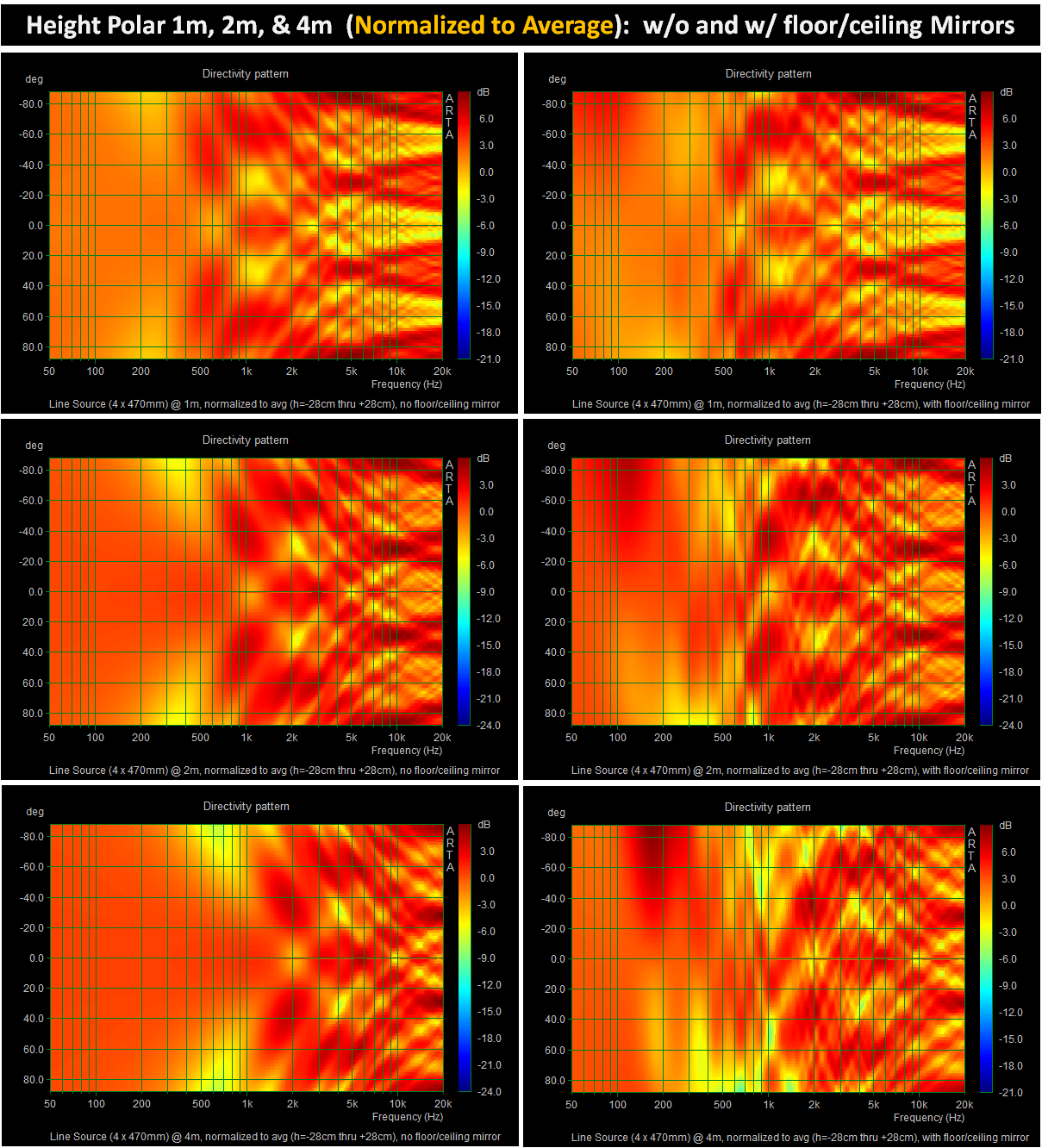

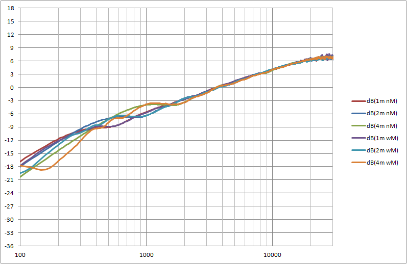

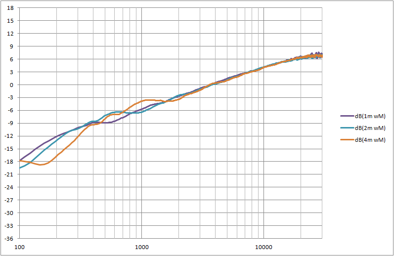

Here are a few plots showing the influence of the first reflection floor and ceiling mirror sources. As before, the sonograms show response relative to height above and below the center of the planar array at a fixed distance. Negative height numbers are closer to floor, positive closer to the ceiling. In hind sight, I should have swapped this sign convention so the plots would be more intuitive(ie floor at the bottom of the plot). I guess it really only makes a difference if the array or floor/ceiling spaces are not symmetric.
Attachment #2: comparison of height polars at distances of 1m, 2m, and 4m with and without floor/ceiling mirrors. Left side plots are without mirror sources, right side plots are with. All plots were normalized by the average response between the center of the two middle planars.(ie one spatial cycle)
- the spatial variations in the midrange and upward are not influenced much be the floor/ceiling
- below 500Hz the differing distances between array and floor/ceiling cause an imbalance in the response with more support closer to the floor as expected. The disparity becomes more prominent as you move further from the source. The rule of thumb for listening window being the middle 1/3 of the line source still seems to hold up.

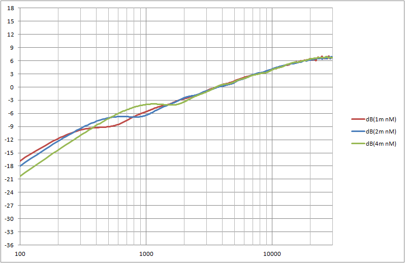

Attachment #3 - #5: overlays of the average responses used to normalize the sonograms. Above 1kHz the curves are essentially the same for all distances, with or without floor/ceiling mirrors.(nM= no mirrors, wM=with mirrors) This was what I was wanting to show, that you could use an average curve calculated from a fixed distance with varying heights for determining an appropriate EQ for higher frequencies. At lower frequencies, since your line source is not fully floor to ceiling, you will have variations with distance. Of course as you get below Schroeder frequency room modes will also start to influence/dominate the response.

Interesting. Gives ball park figures. So for typical ear height at a listening position of 37 to 39 inches (94 to 99 cm) what do you think? All the calculations can also be summed up with a fairly simple floor to ear and ceiling to ear calculation in respect to listening distance.
Thanks! Helpful as always, Bolserst (both you and the post🙂).
In hindsight I guess the limited effect of reflections at high frequencies makes sense given how strongly directive a 2.5 m line is at those frequencies. There's not much high frequency energy directed toward the floor or ceiling so there's little reflection that might contribute to the final response. Is that description/rationalization consistent with what you've seen? The polar responses you've posted haven't included angles dramatically off the main horizontal axis so I want to be sure I'm not making unsupported claims.

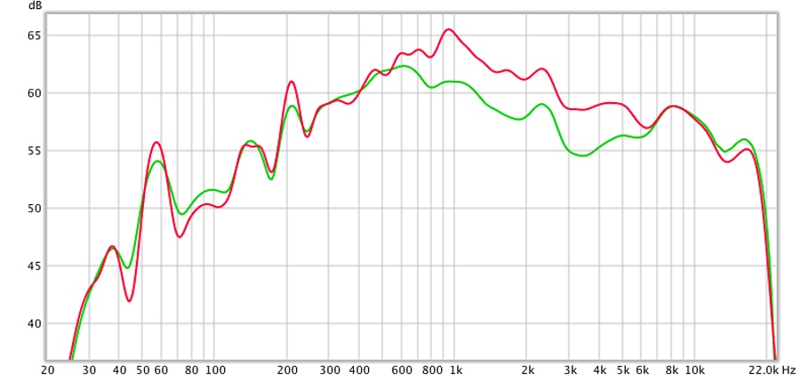

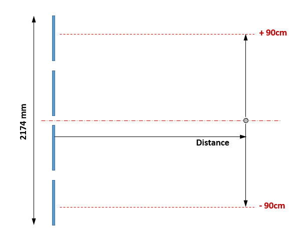

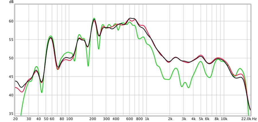

Here's a first attempt to follow Bolserst's advice on averaging measurements, with a comparison to the moving mic results (two versions).
In all cases:
First I made five measurements over the range described above, this time using a loop back time reference and making sure the impulses lined up (one was off by one time point). I averaged the five using the cumbersome A+B approach in Room Eq Wizard so the phase response is retained. All these measurements had a 5-cycle window applied; no other smoothing.
I'm attaching the resulting individual step responses and the resulting average. The responses are displaced vertically so they're easier to see. The bottom (green) response is the average of the others.
I also made two moving mic measurements over the same range of mic heights. 1/6 octave smoothing was applied in both cases. In one case I moved the mic only vertically (red plot), and in the other I also moved it horizontally (black plot). I superimposed the two moving mic magnitude measurements on the averaged measurement (green plot) for comparison.
The drop off above 1 KHz is largely because I have the 1 KHz Bessel low pass on the midrange but no compensating equalization. This result is useful to me as I embark on the equalization step but I probably should have removed the Bessel low pass for the purpose of posting measurements. Sorry about that.
I see more agreement over much of the frequency range than I expected, and I'm surprised to see the significant level reduction between 800 and 8000 Hz when the averaged measurement is compared to the two moving mic measurements (which agree with each other to a remarkable extent).
So which curve serves as the better reference point for equalization? That broad 3-5 dB difference between 800 and 8000 Hz is certainly not going to sound subtle. And does it make sense to equalize away the peaks that appear over that range? The averaged results would certainly call for more dramatic adjustment than would the moving mic results.

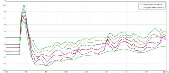

Golfnut: Aren't we saying the same thing in different ways? I would argue the cancellation effect you described so nicely is the underlying cause of the polar response I referred to---the lack of high frequency energy directed toward the floor and ceiling. Or am I misunderstanding your argument?
Few
Few
The averaged result is a 5 cycle window, showing what happens in the early wave front. You probably can undo that 5 cycle window to look at a longer time frame.
This average measurement makes for a clearer look at the speaker and shows less of the room effects. The sum of those 5 measurements already shows how much of the reflections etc are averaged out.
The moving mic will always include more of the room into the measurement due to it's time frame. Was the moving mic moving along the same line these 5 measurements were taken at? If not, all bets are off. The average should be build by measurements utilising the same space as the waved (moving) mic.

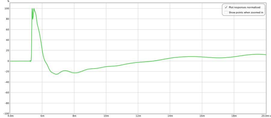

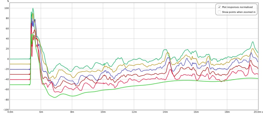

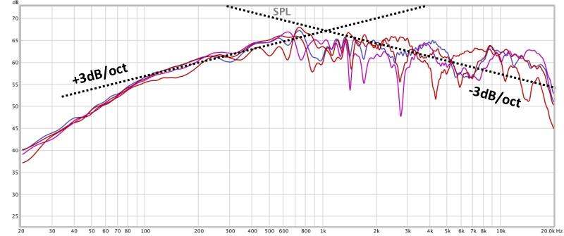

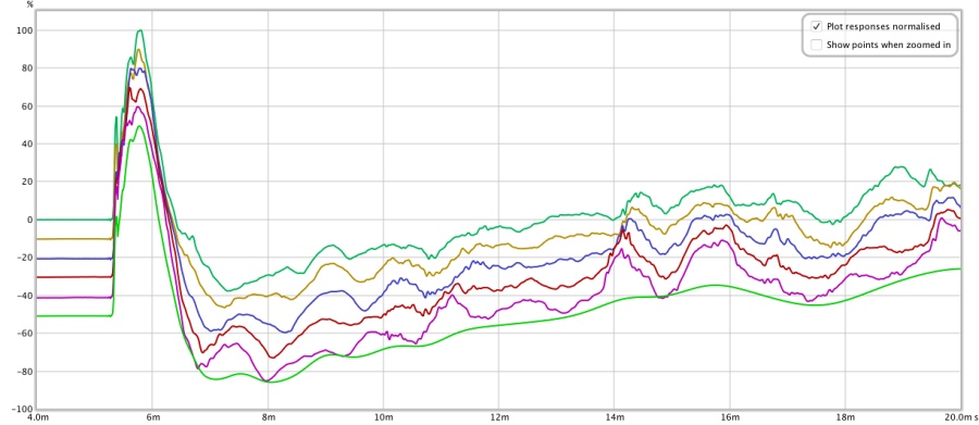

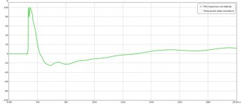

Before breaking out of measurement mode I figured I'd repeat the previous batch but without any low pass on the midrange.
Attachment 1: Same system of 5 windowed measurements averaged (5 cycle window, plotted in green) superimposed on a moving mic measurement (just vertical motion, plotted in red).
Attachment 2: Step responses of all 5 measurements used in the average, as well as the resulting average (at the bottom, in green). Again displaced vertically for clarity.
Attachment 3: Step response just of the averaged responses.
I can certainly say the averaged responses give a much cleaner step response. The delayed arrivals from points above and below the mic are clearly visible and a lot of the distracting wiggles in the tail of the step are smoothed. This seems like a nice way to see how equalizing the magnitude response affects the step response. Too bad I'm running out of time for today...
