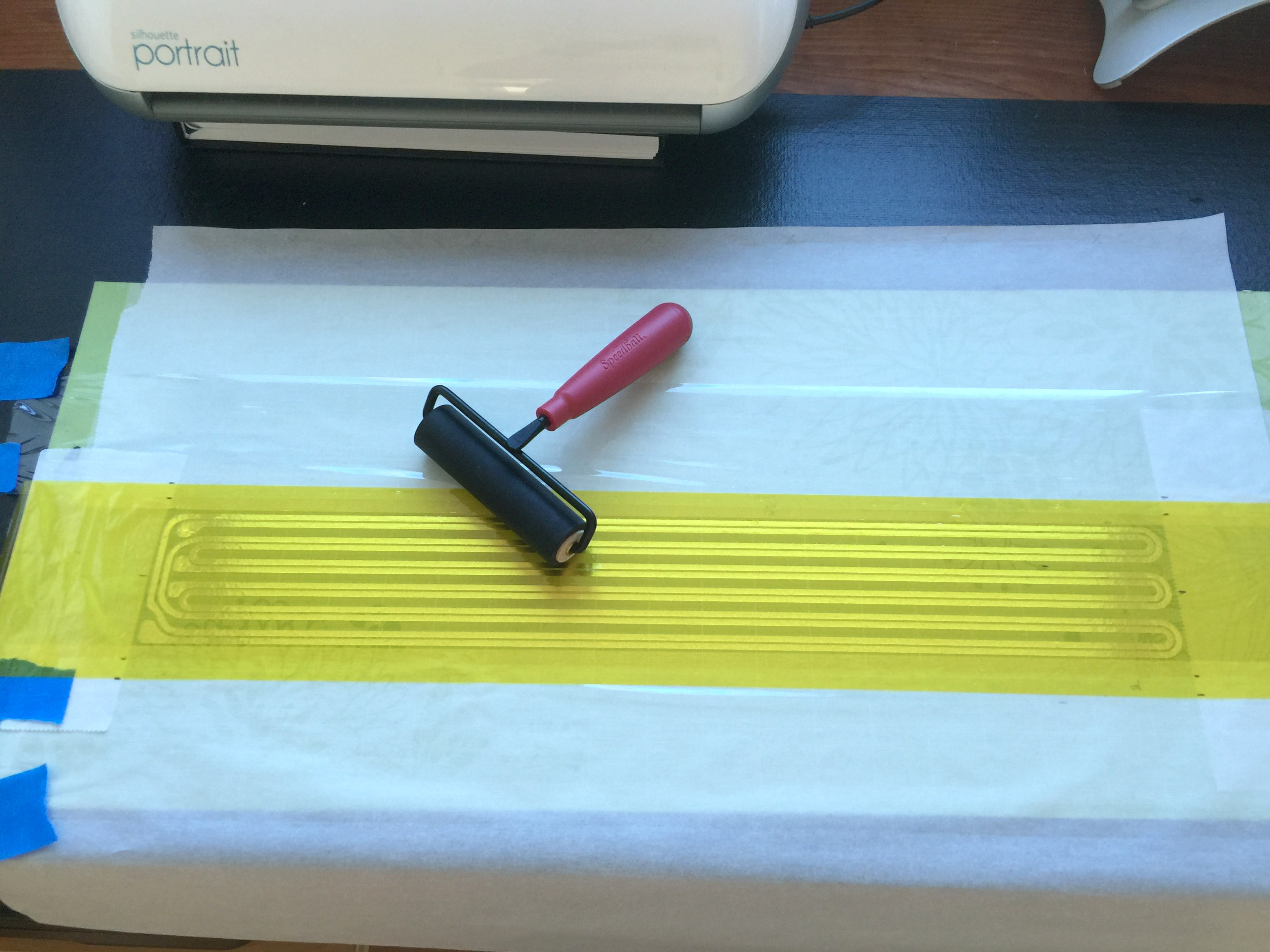

Hi WrineX: I did use stretch wrap as a surround for the kapton. I didn't laminate it in the sense of covering the entire width of the kapton tape. The surround overlaps the kapton about 1 cm along the edges (I think that's what you were saying, I just want to be clear). I found that the adhesive on the kapton grips the shrink wrap extremely well. I was unable to pull them apart---the membranes tore before the adhesive let go.
The stretch wrap I used is not the material used to cover food containers (Saran Wrap etc.). Instead, it's made to wrap awkward bundles and packages. Here's a link to similar material, but I think I used material bought at a local home improvement store. It has no adhesive, but is not designed especially for high temperature use. I used it because it is highly damped, it's thinner than stretch wrap for food, and it retains tension that is applied. I was worried the kapton would be difficult to stretch well and that it would be krinkly---make noise when shaken. I also wanted to try to move the fundamental resonance as low as possible to simplify the crossover with the woofer tower. As it turns out, the resonance is down around 40 Hz. I haven't measured the impedance to nail that value down, but the peak shows up clearly in the frequency response, especially when the grills are removed.

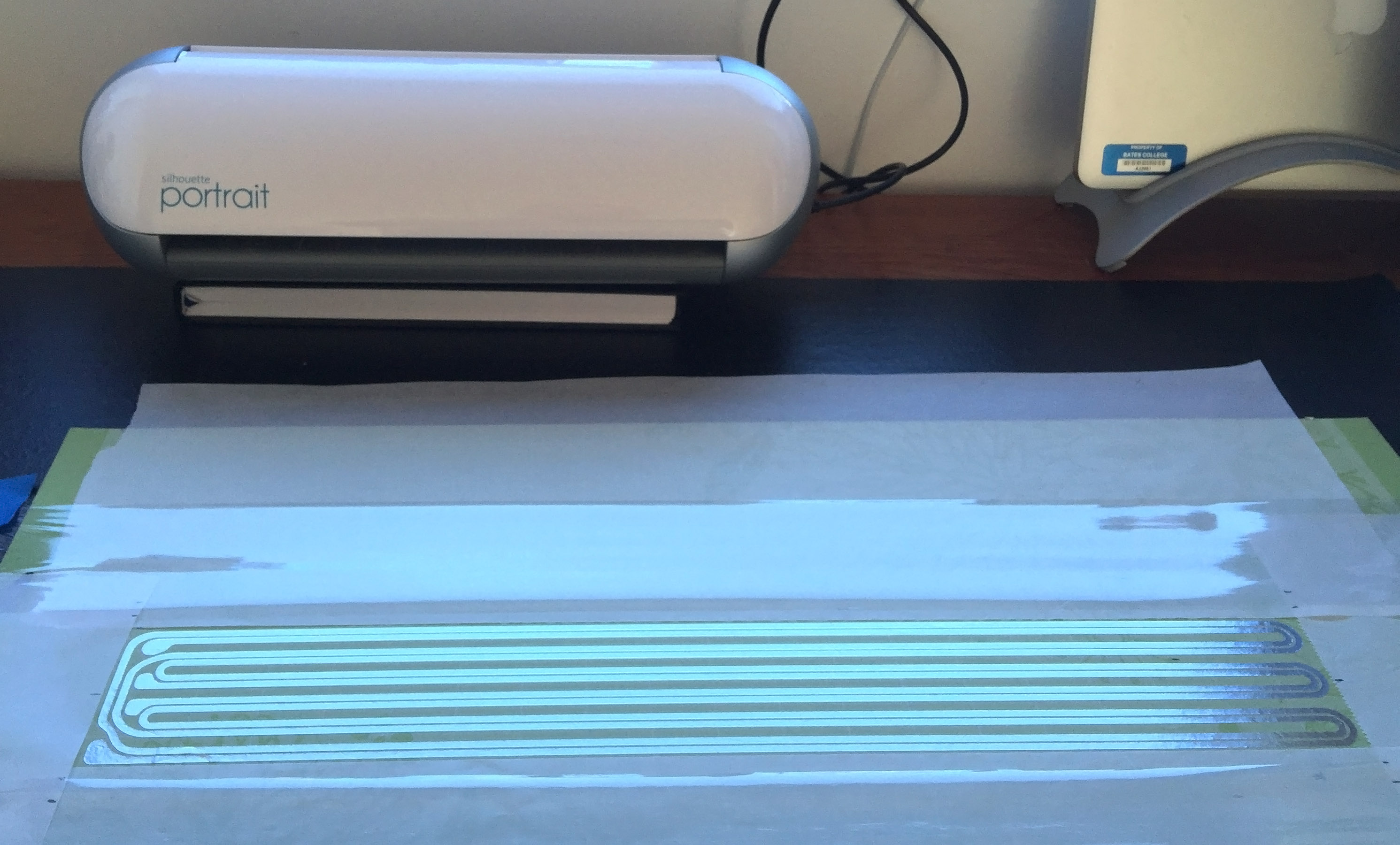

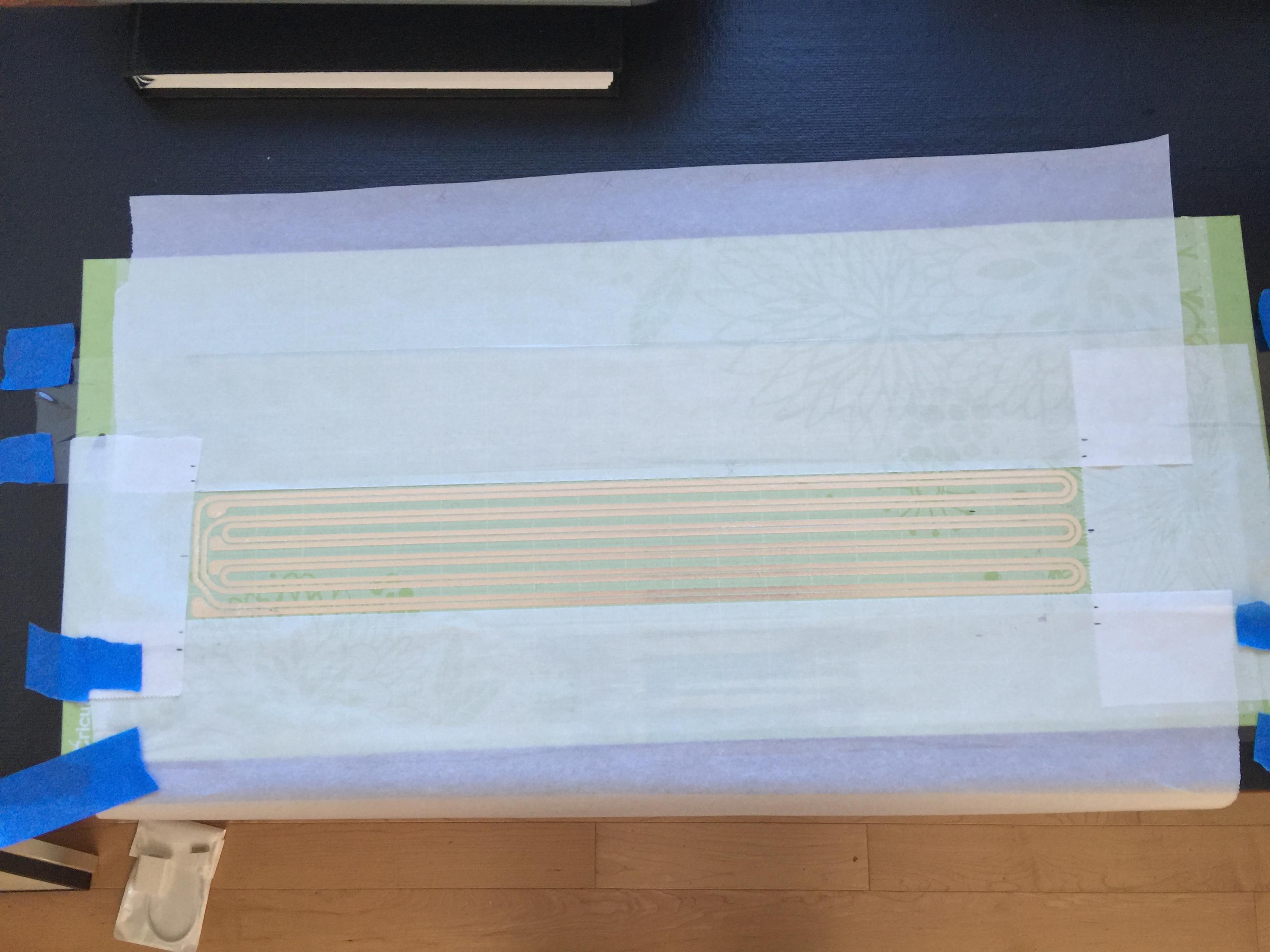

To make a diaphragm I stuck the paper/aluminum laminate on a cutting mat for the Silhouette cutter. I applied a fresh coat of spray adhesive labelled "removable" before sticking it down and rolling it flat. When the cutting was done I peeled away the unwanted parts to leave the trace, and removed any of the paper that remained stuck to the aluminum.
To apply the kapton I first rolled out the length I needed. (What a pain this stuff is! Tricky to avoid tearing it but I finally developed a good technique.) and taped it sticky side out on a piece of plexiglas. Before applying it to the conductor I first positioned the stretch wrap pieces along side the conductor traces. I used some silicone-coated baker's paper that didn't stick to the cutting mat as a spacer so the stretch wrap wouldn't stick to the mat. Once the two lengths of stretch wrap were taped in position (using removable masking tape) I carefully lowered the kapton onto the conductor trace and stretch wrap. The clear plexiglas made it possible for me to see my alignment before making contact. Once the kapton touches something you're stuck---literally---so the alignment has to be right the first time.
I then removed the plexiglas leaving the kapton, sticky side down, with the conductor and stretch wrap surround underneath. I rolled everything flat to remove wrinkles and make sure the conductor was well attached, and then slowly peeled the whole creation off the cutting mat while making sure not to let the kapton's adhesive attach to itself.
That's it. Nothing to it.😀 It took awhile to develop a technique that worked reliably but by the time I had made 8 panels, plus the ones I screwed up in the early stages, I found I could make a nice diaphragm without problems nearly every time.

1) Conductor cut out on the cutting mat, waste paper and foil removed, non-stick paper in place
2) Stretch wrap pieces in place on top of non-stick paper (you can see the shiny surface of the stretch wrap)
3) Kapton tape in place on top of conductor and stretch wrap

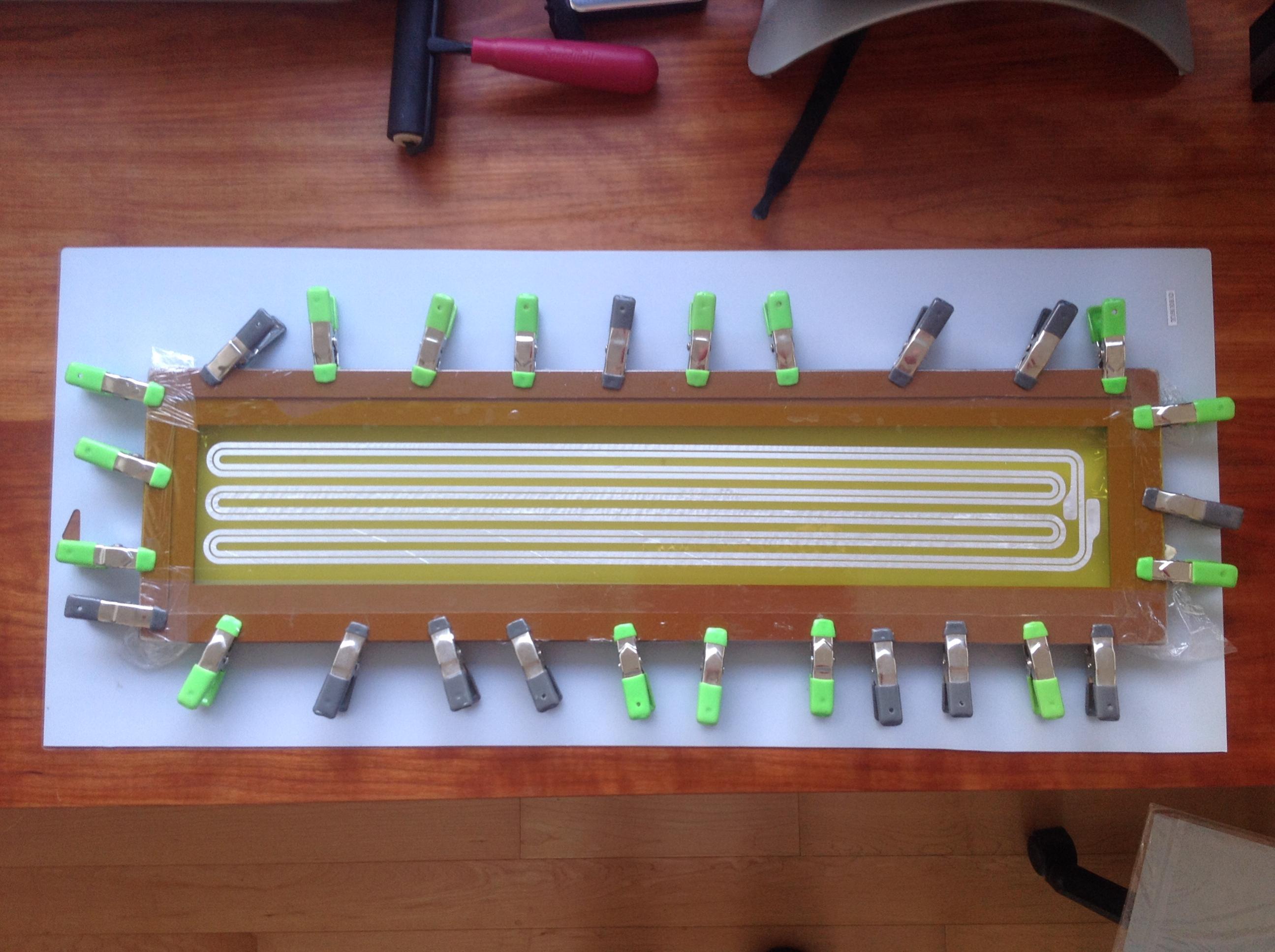

4) Resulting diaphragm in place in a frame, with clamps to allow tension adjustment. Masking tape works better for the stretching.

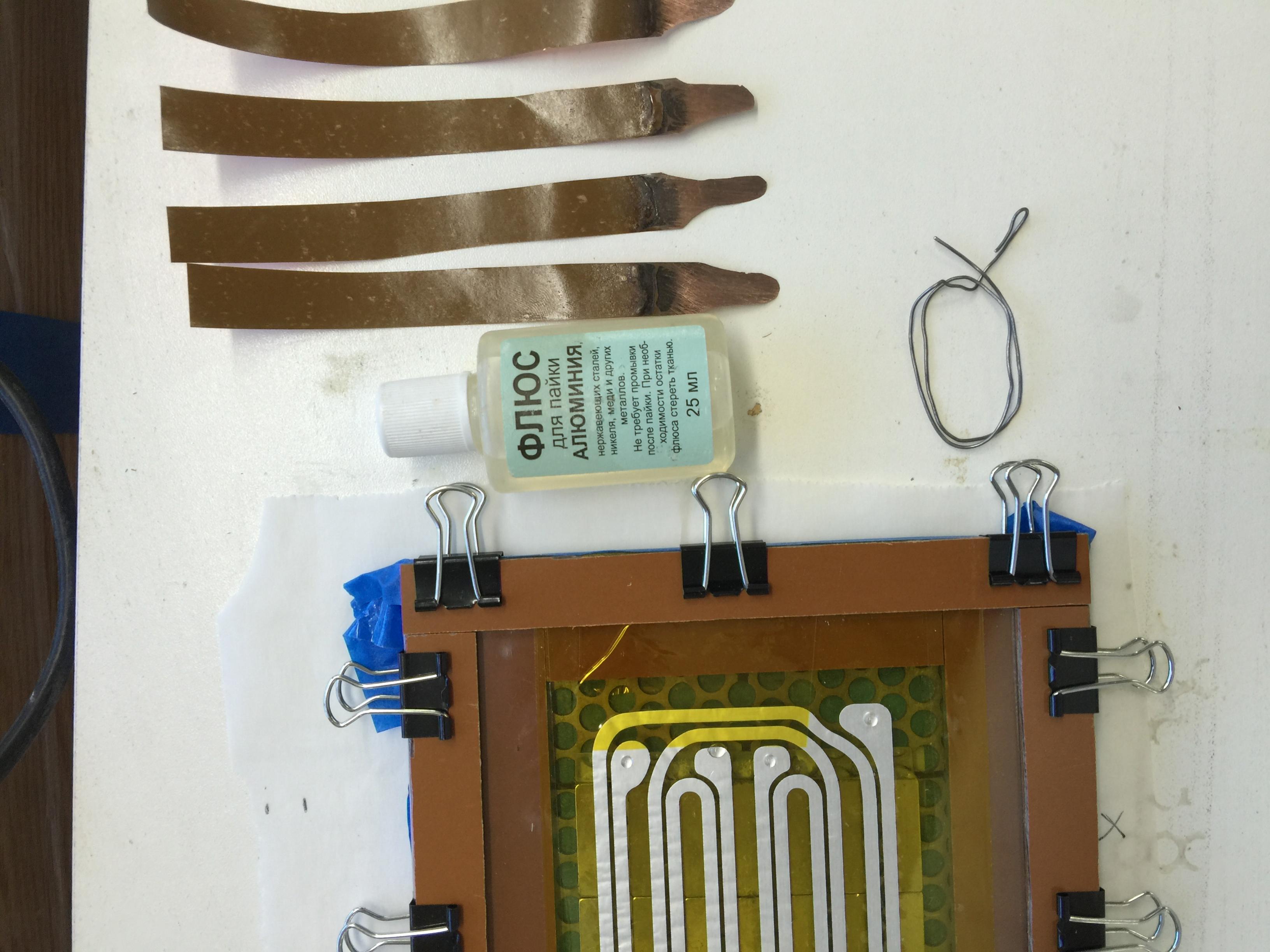

5) Preparing for the nerve-wracking job of soldering copper tape to the aluminum conductors. Not my favorite part of the process. A drop of flux is visible on each of the four connection points on the aluminum traces (two for the midrange, two for the tweeter).​

I agree the adhesive on the Kapton does a good job damping it so it's less rattly than I expected before I had it in hand. The adhesive is also stuck between the aluminum (which covers much of the surface) and the kapton so it serves as a constrained layer.
I still wanted to make it easier to stretch the Kapton, though, and I wanted some undriven diaphragm between the conductor and the attachment point. So I used the surround to add to the diaphragm's width (and increase its excursion range), provide a non-reflective mounting scheme, and lower the resonance.
