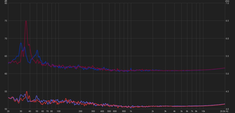

For the impedance fans I'm attaching three images:
1) Impedance measurements of the left and right planar magnetic midranges and tweeters. The two upper traces (higher impedance) are the midranges and the two lower traces are the tweeters. In both cases red lines correspond to the right hand speaker. I applied 1/48 octave smoothing to retain the wiggles but remove the whiskers.
As I mentioned several posts ago I know there are some diaphragm tension gremlins (wrinkles) in both speakers. Presumably their responsible for the differences between the impedance peaks down in the 35 Hz range. It's worth noting that I roll off the planar drivers below 200 Hz so there's very little electrical drive at 35 Hz. Those resonances could be driven acoustically by the neighboring woofer array, though.

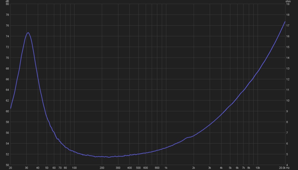

2) Impedance measurement of the left woofer array. The fundamental resonance is at 31 Hz, and the impedance there maxes out at about 16 ohms. The right woofer measurement is extremely similar but I ended up with about a 1 ohm positive offset that I didn't catch until after I had disassembled the measurement rig. I'll have to double-check and make sure I don't have a faulty connection as a result of the new speaker connections I described recently.

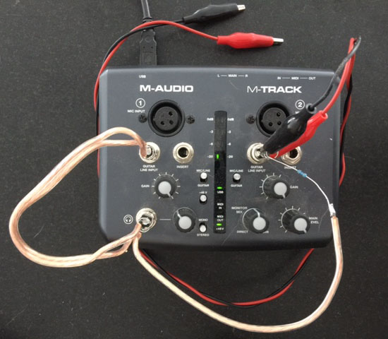

3) On the off chance someone else has a similar audio interface I'm including a photo of my cobbled together impedance measuring rig. There's a 99.4 ohm metal film resistor at the right input; that's the sense resistor. The red and black leads go to the speaker terminals.

Concerning the wiggles and whiskers…I’m wondering if this is a byproduct of using the swept sine signal for the impedance measurement of a transducer. It may be completely unrelated to swept sine and more just a function of your measurement setup. Did you happen to measure a 4ohm resistor as a comparison to see if the wiggles and whiskers are still present?…I applied 1/48 octave smoothing to retain the wiggles but remove the whiskers.
Some comments on the use of swept sine signal for impedance measurements:

I'm thinking that the middle picture is the impedance graph. Those wiggles would be a lot easier to decipher if we had a phase graph along with it. When they line up you can see what is happening in the electrical domain and in the time time domain. Frequency rounds out the whole spectrum. There is method to this madness.
Thanks for the impedance discussion links. I'll read them through. I got distracted from impedance measurements when my "repaired" amp was finally returned and I then found that not only was it not repaired, it's now worse than before I sent it in. So my attention has been on making the system work with an old amp whose gain doesn't match the one it's replacing and which doesn't like load impedance loads. Not what I want to be working on...
I don't think I saved my resistor impedance measurements so I'll have to take another look. I used a 100 ohm resistor and headphone output for the measurements so I assumed the 4 ohm impedance of the planars was just too small compared to 100 ohms to yield a clean measurement. I was going to try again with a smaller resistor.

So graph number one is the planar impedance! Something is a little funny there. You should not have all those wiggles and waggles. Your woofer stack impedance was pretty normal looking. But there are a bunch of wiggles there to.
Have you done a loop back sanity check on your outboard sound card?
I'll make another run at the impedance measurements including a check on a known-value resistor. The planar and woofer measurements were done in exactly the same way, one right after the other. You'll have to be a little more specific about what you mean by "loop back sanity check" in this impedance testing context.

Checking a know resistor is a great way to test what is happening. I'll look in the manual tomorrow to see the correct way to do a diagnostic loop back. Kinda tired tonight. Long day.

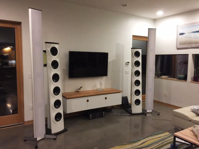

While waiting for it I completed the cabinet that hides the electronics and is intended to "tie the room together." (That's a Big Lubowski movie quote, in case it isn't obvious.) It's actually supposed to tie the room and speakers together (round woofers, round cabinet handles...get it?) but I couldn't find a quote that accommodated speakers. The old amp below the cabinet is the temporary one keeping me in music until the new class D amp shows up. Things should look tidier once the amp is gone and the extra cable mess is eliminated.
I realize the diyaudio crowd isn't likely to be overly interested in room decor but I'm sort of dead in the water until my electronics are back in order and since you asked for an update, I'm posting a crappy compressed iphone photo as project life support. I do appreciate the expression of interest!

Well Sir Few I have to say it looks smart.
Done a fair bit of design work over the years and I'd be very proud to say they look really professional.

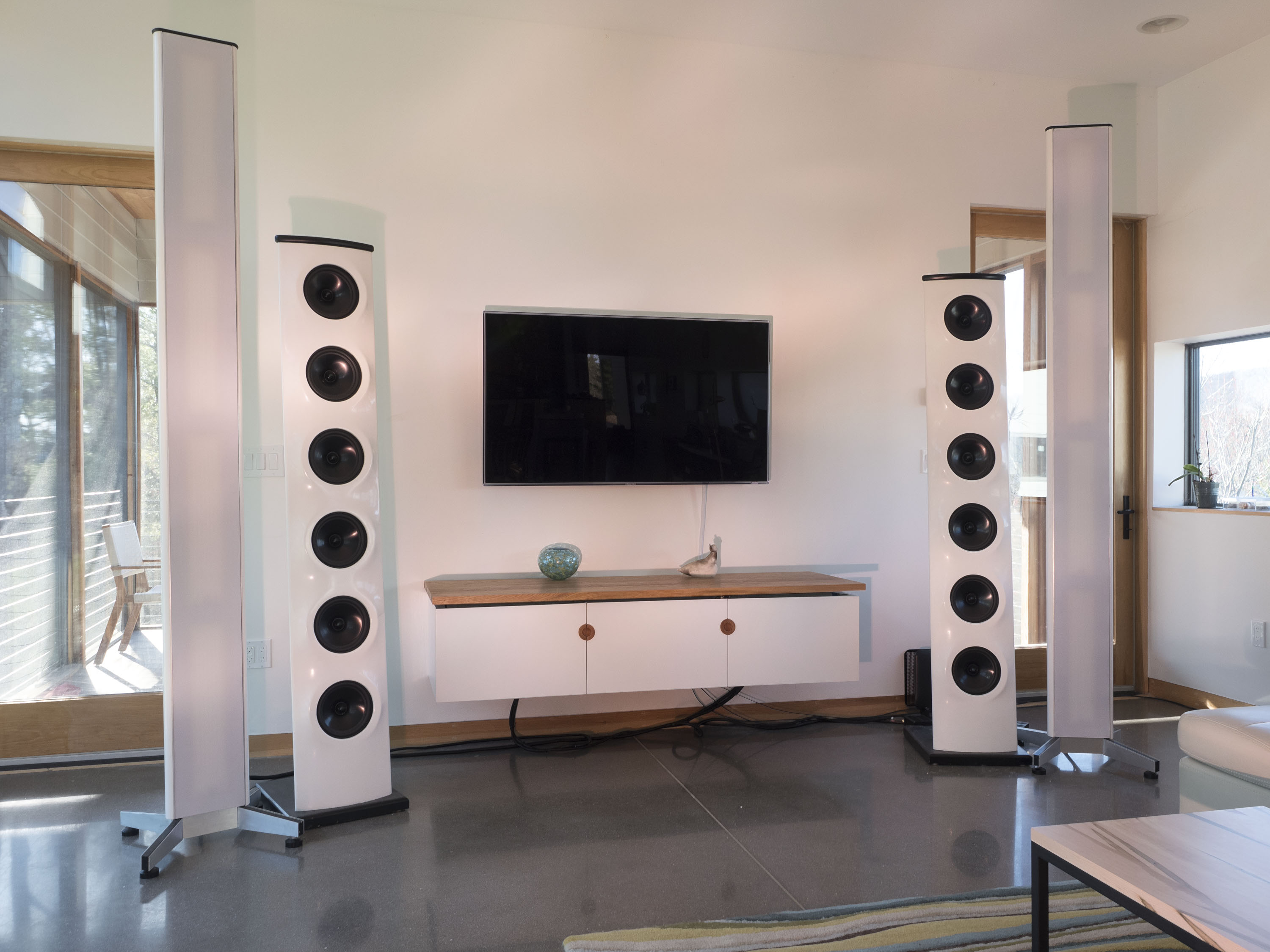

By the way, the new amplifier has arrived, is installed, and seems to work without glitches. Hooray! That allowed me to get the limp-along amp off the floor and neaten the set-up a bit. Pardon the mod lighting---I was fiddling around in photo-land a bit today and got "creative" toward the end of the session. The photos on the homebuilthifi site are more straight-shootin'.
